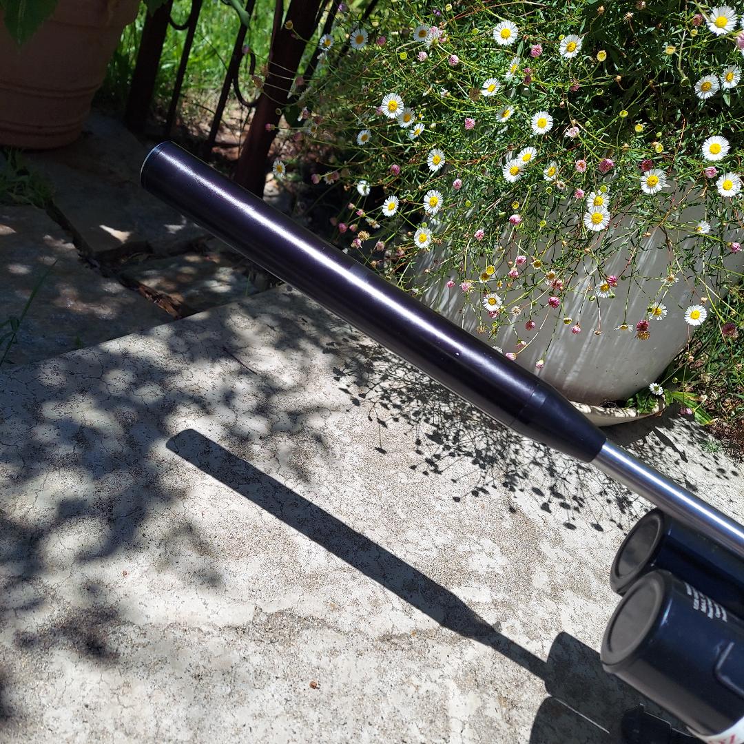

So .... onto the bench it goes and soon becomes a pile of parts & pieces. First off the typical Turkish PCP shroud silliness, yea it has a nice big volume shroud over the 15mm barrel, but does NOT contain an air stripper, muzzle set back spacing or any miens for the air exiting muzzle to use the shroud for silencing the bark ... Face palm time

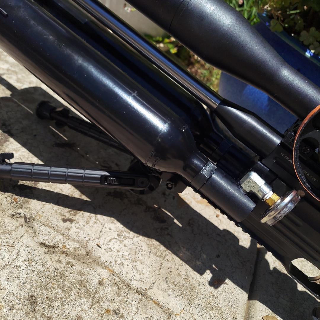

Now with 3 bottles and 1425 cc of air on board the design to tie it into a single delivery at valve was done via small drilled passages on the side by side manifold up front, so passages got opened up there to be freer flowing. Valve gets a seat clean up/re-profiled with the transfer path from barrel down to valve opened up to @ .190" We change out the proprietary oddball fill fitting to "Foster spec SS HUMA fill"

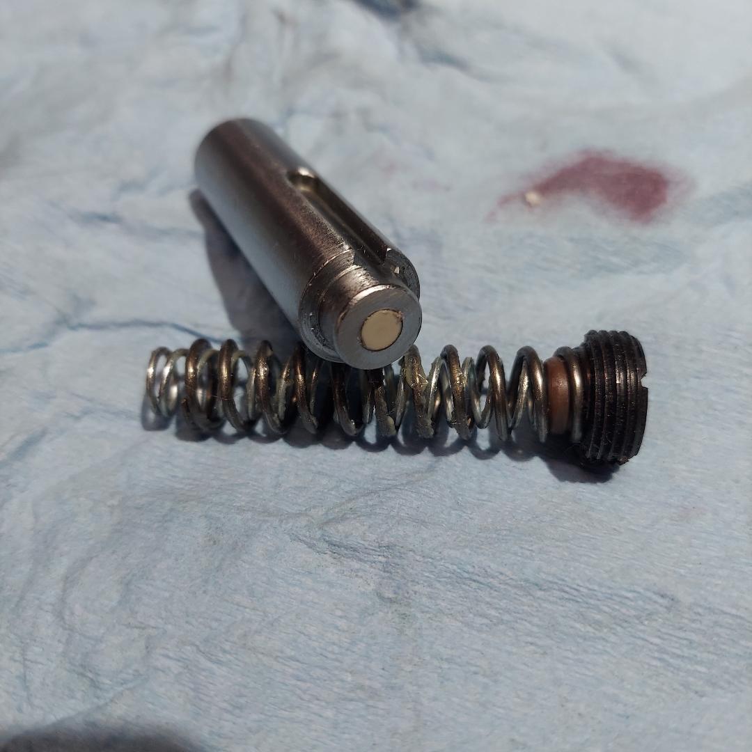

After doing my thing inside it all gets reassembled with fresh o-rings and sealant where required. Over the chrony with exact same settings power has come up @ 40 fps and the hammer bounce is still a problem

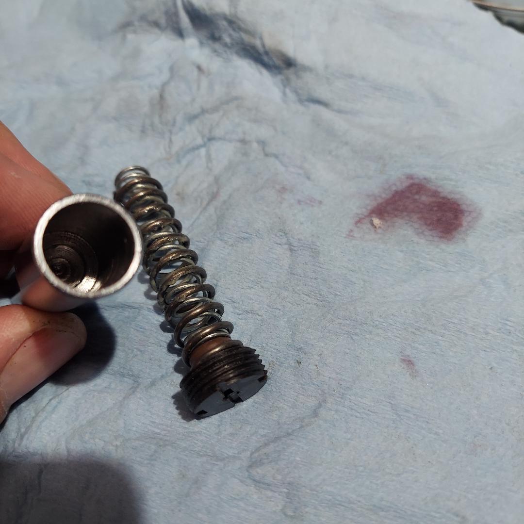

Dig threw my stash of springs finding an idea replacement that is a tad stiffer in spring rate and a tad shorter. This works out to now have hammer in Free Flight of about a quarter inch.
Fill back to 150 bar and dry fire a few times ... SNAP !!!! One hammer strike and Zero bounce !!! Over to chrony again and the same King pellet is now sizzling along at 960 fps making 52fpe !!

Remember this ... Shroud does nothing issue, lets fix that !!!

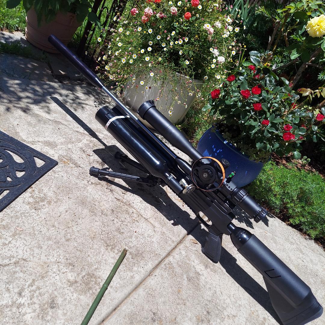

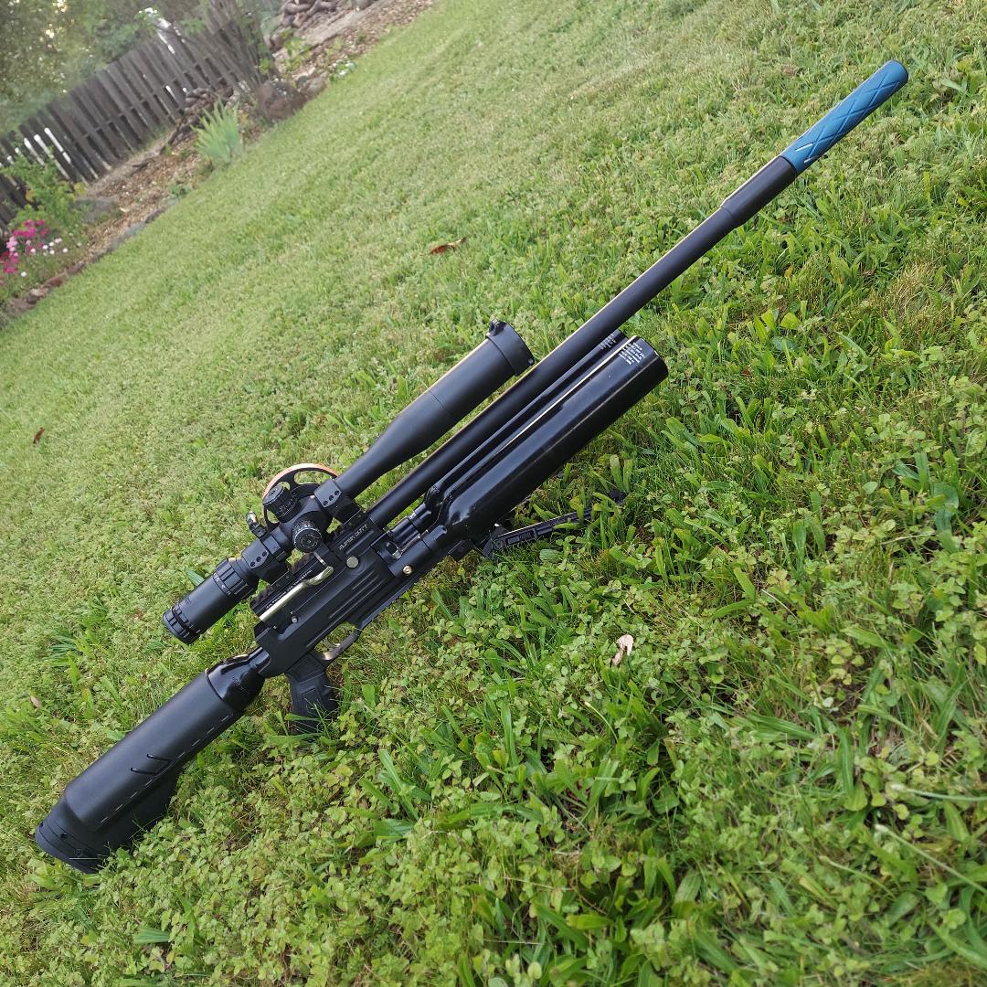

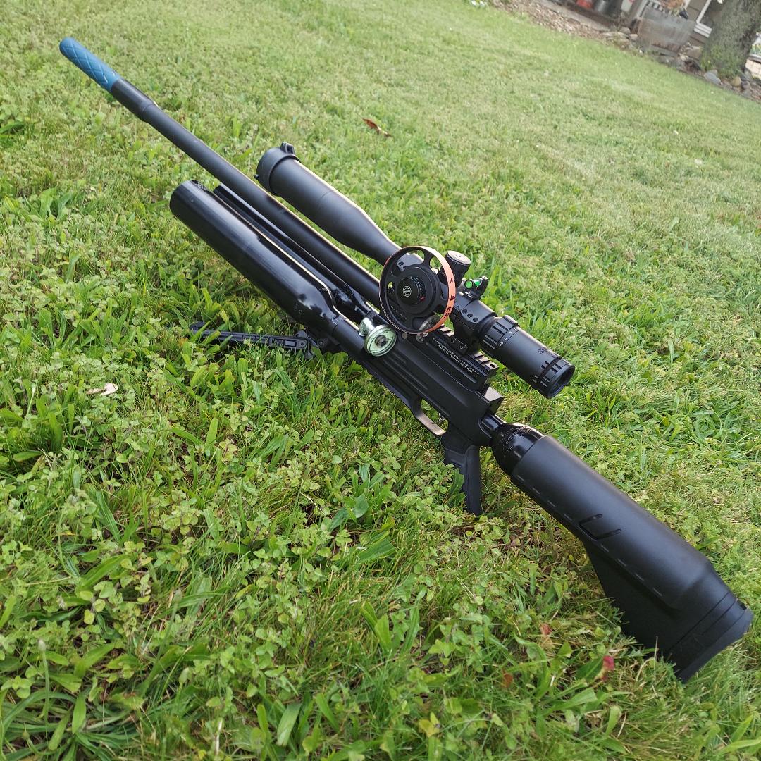

Making an air stripper that threads onto barrel having 1/2-20 Female/Male ends we lengthen the barrel at muzzle. Then fabricate a Delrin extension to cover the stripper retaining the same Shroud I.D. dimension and extending to reuse the thread on end cap with its 1/2-20 LDC mounting thread. * Barrel length increased by @ 3 inches. Yes it took the sharp crack to a muted sound, tho still in no way back yard friendly, but much better IMO.
Scope is a Optisan / MTC Viper 8-32x56 on Med rings that has objective bell @ 3/32" off the shroud .. it clears but not by much.
