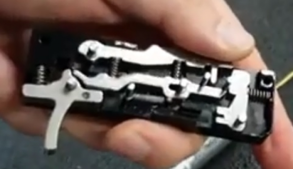

Next up the Trigger mechanics which surprised me as I expected the Evanix style snag sear seen on previous Kral rifles / turkish PCP's. This trigger an actual adjustable sear and drop away hammer holding pawl .... Nice. The actual two parts that make up the SEAR were Hard steel with the remaining link/toggles being cast aluminum. The contact areas of links & toggles smoothed up and sear/s get ceramic stoned to crisp & smooth edge with everything getting heavy moly upon assembly. ( Picture shows configuration assembled on outside of receiver )
* Needed to do this, figure it out as I had failed to take a picture prior to disassembling ... oups.

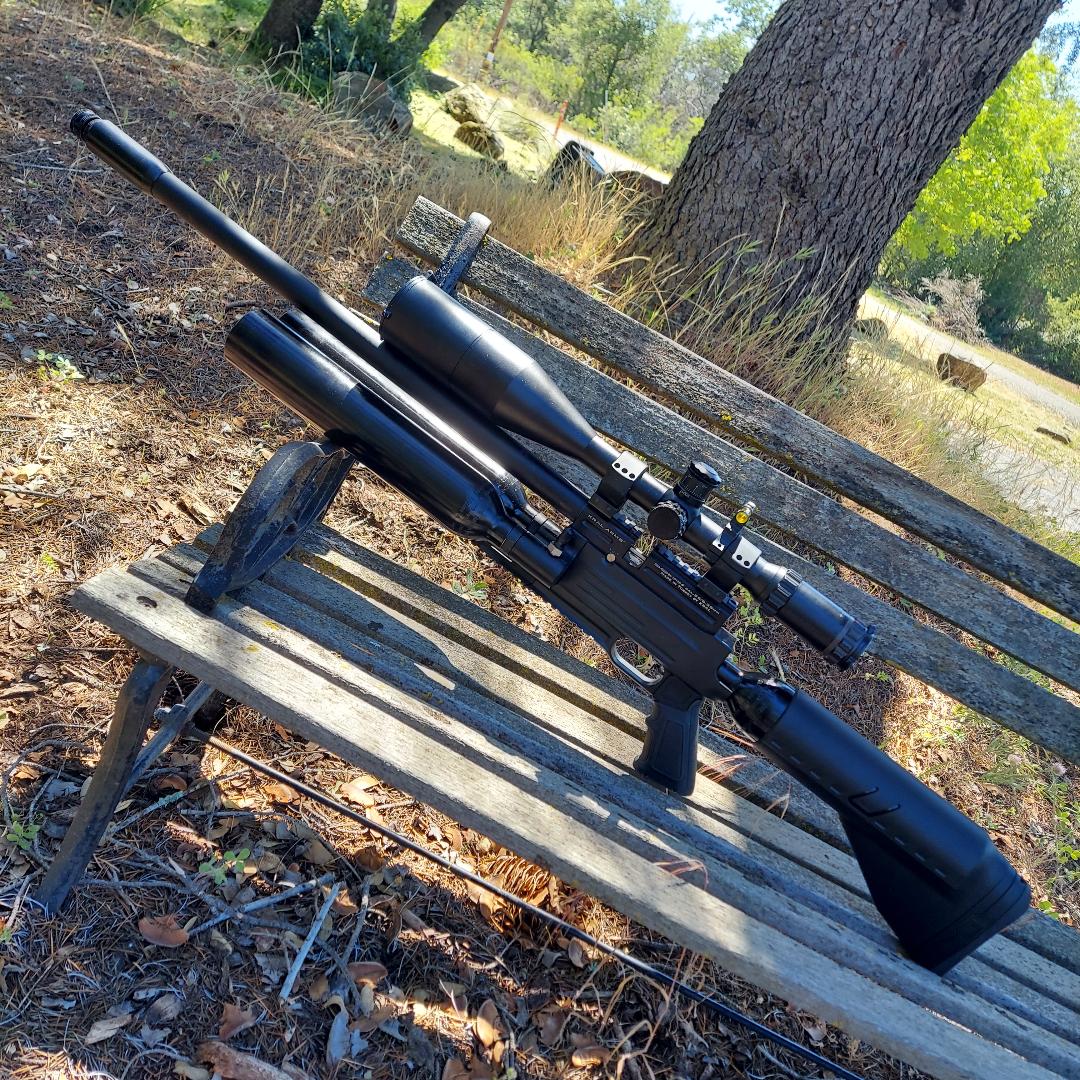

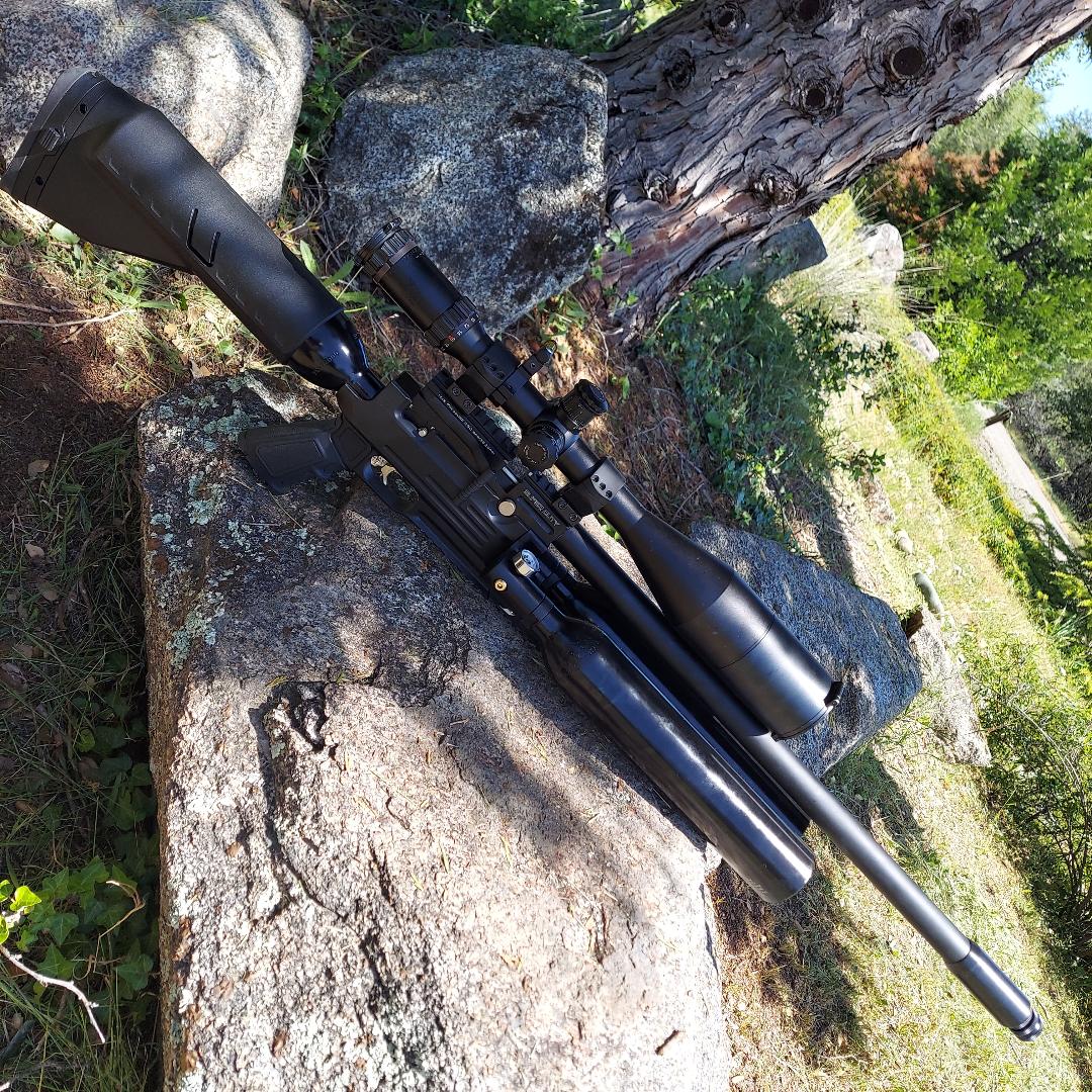

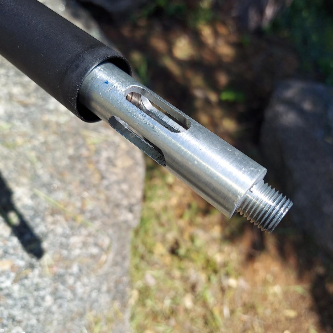

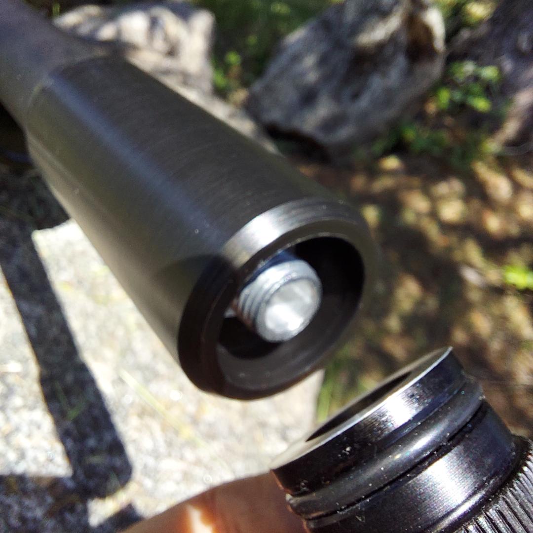

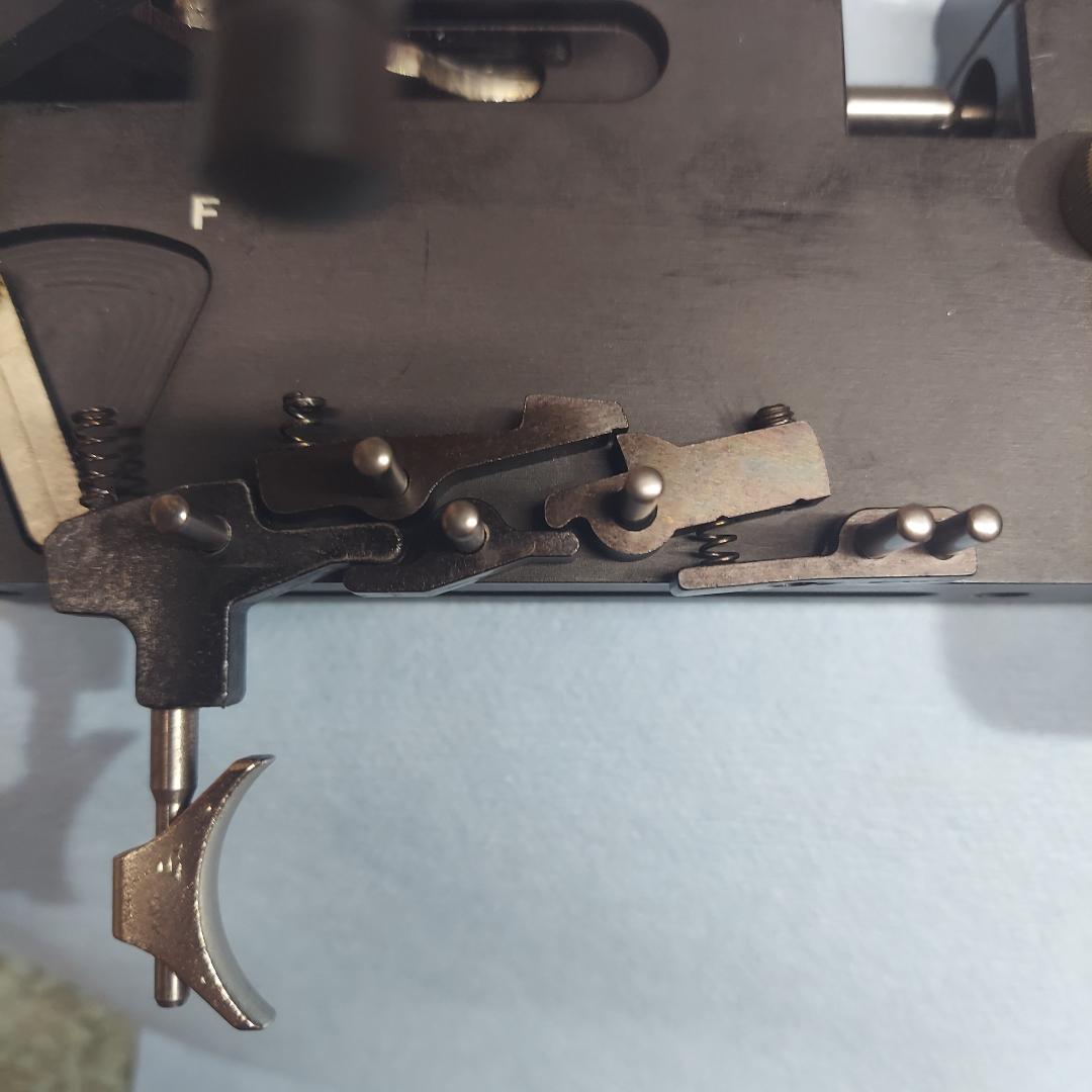

Making an air stripper that threads onto barrel having 1/2-20 Female/Male ends we lengthen the barrel at muzzle. Then fabricate a Delrin extension to cover the stripper retaining the same Shroud I.D. dimension and extending to reuse the thread on end cap with its 1/2-20 LDC mounting thread. * Barrel length increased by @ 3 inches. Yes it took the sharp crack to a muted sound, tho still in no way back yard friendly, but much better IMO.
Scope is a Optisan / MTC Viper 8-32x56 on Med rings that has objective bell @ 3/32" off the shroud .. it clears but not by much.
