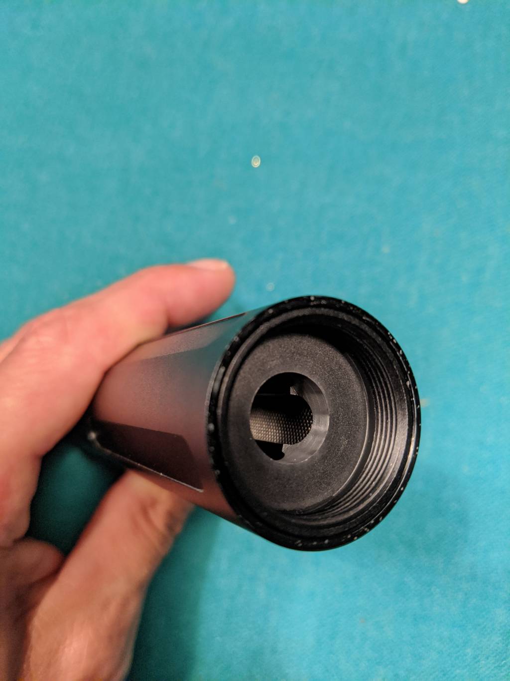

I had to machine out the first baffle in my DonnyFL mod with the flat end cap. The baffle being so close to the muzzle left a small dead space that was causing serious accuracy issues. After I removed that baffle, it's been fine.

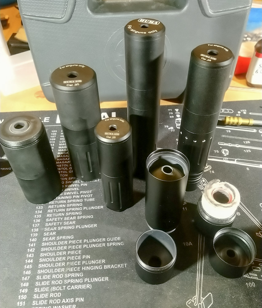

My 1st pcp came with a Huggett installed. Not satisfied with it's performance I opened it and found it didn't have baffles, only a wire screen holding back felt. I took the baffles from a Benji NP, cut it down and wrapped it with the felt before installing it. It was better, but still not to my liking. I read somewhere someone used soda bottle caps for baffles and I have been meaning to give them a try.
A very effective design seems to be a large chamber in the rear, a somewhat small one in the middle, and a large one up front.

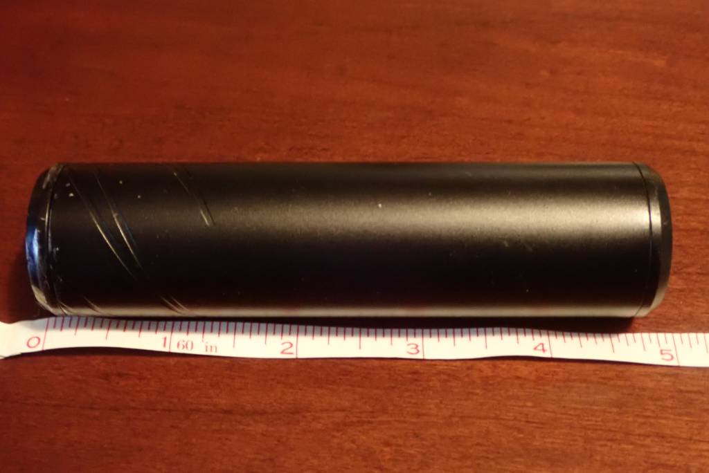

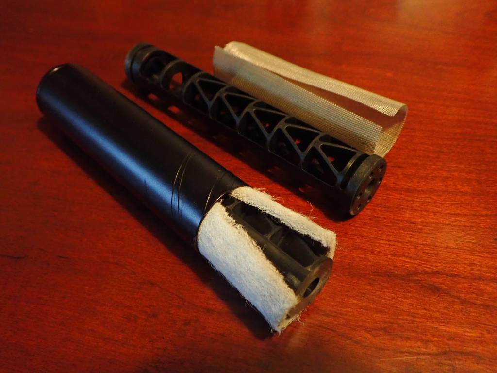

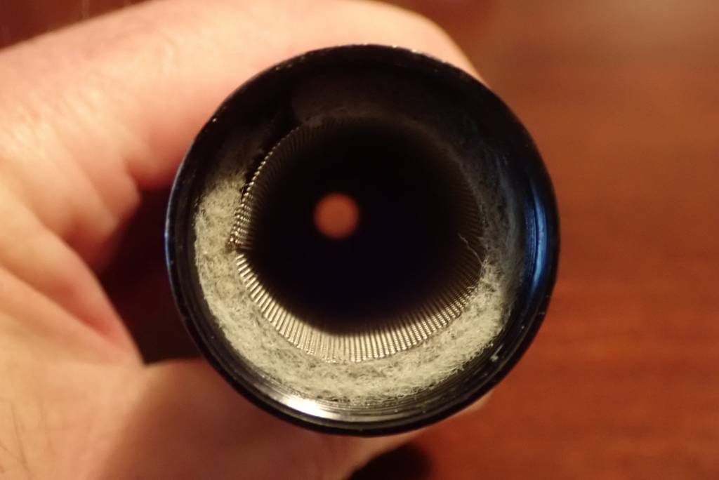

I have a fx moderator I modded with some 3d printed cone baffles (5 IRRC) more volume towards the muzzle, and the rest evenly spaced. The last compartment housing wire mesh and felt. Works the best of any I have. If only by a small margin. It has very thin walls, and LOTS of volume.

I used neoprene wrap, like 1/16” thick, wrapped around the core and wire mesh on the DonnyFL shogun to tame down the rapport of my 30 cal Hatsan Hercules Bully. The neoprene came out of an exercise waist wrap, the one meant to “sweat the inches away”. I over stretched it with my big fat gut so it now goes towards moderator wrap materials, lol.
