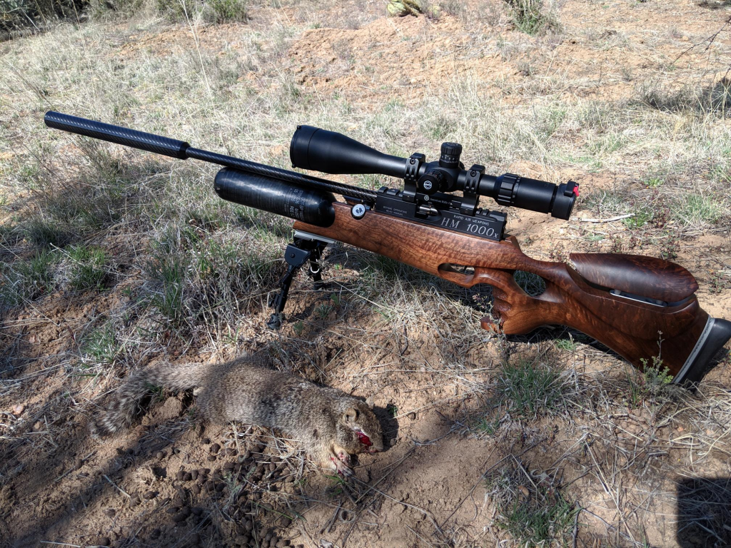

I live out in the wide open country here in Montana. We have lots of Richardson ground squirrels and they are out in force right now. I've killed over 200 just this week. So I shoot lots of pellets through my Air Arms S510 Ultimate Sporter Xtra in .22, but it can get pretty windy here which wreaks havoc on those long shots. I can kill them with consistency at 80-100 yards with the 18 gr JSB's and 16 gr Hades. My longest kill shot has been 121 yards. Will a .25 significantly increase my kill range or should I explore .22 slugs? Thus the question about .25, as I've been looking for a new gun and was rather curious about there being so many .25's in the classifieds.

I think not! My RAW .25
