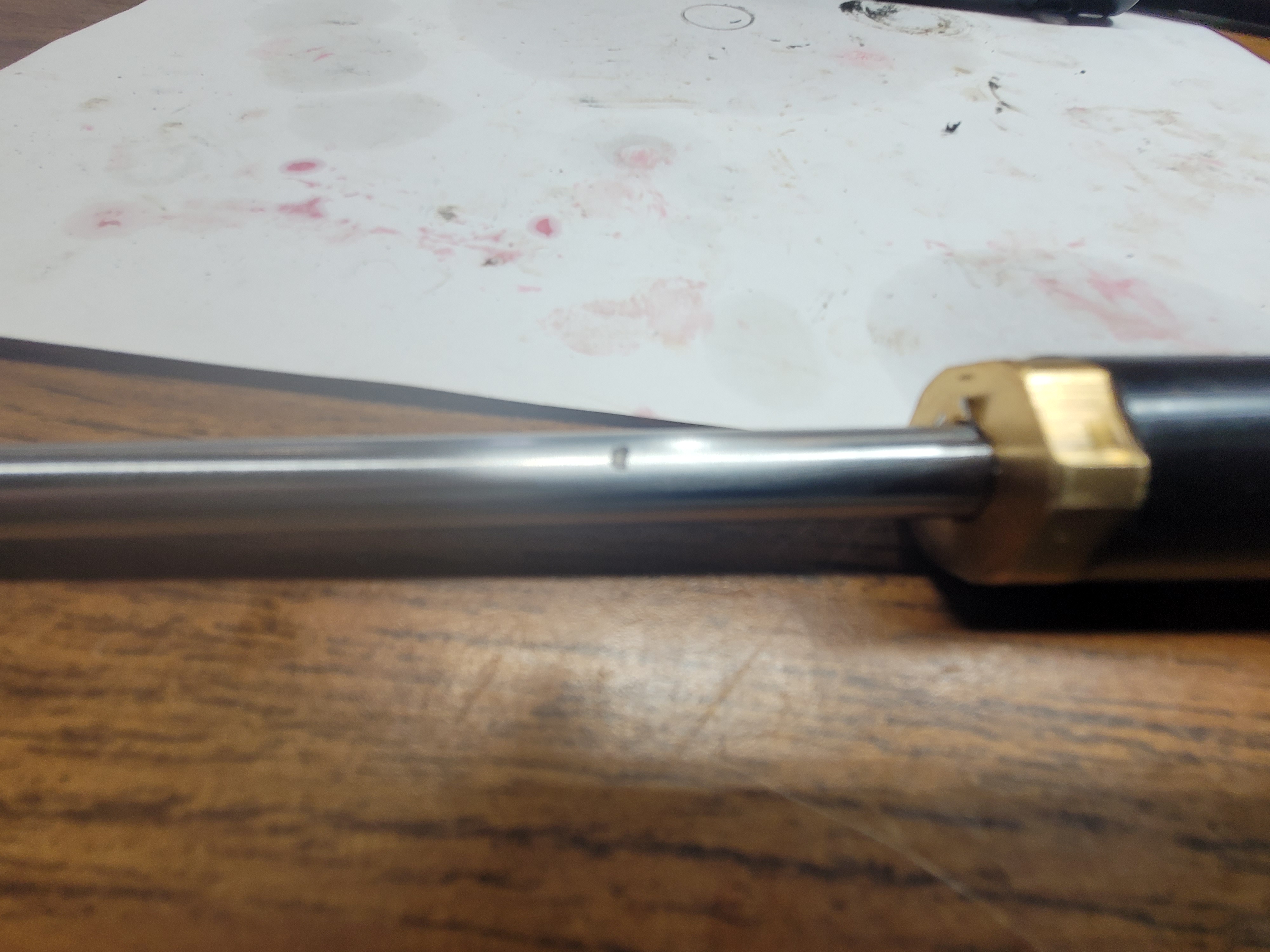

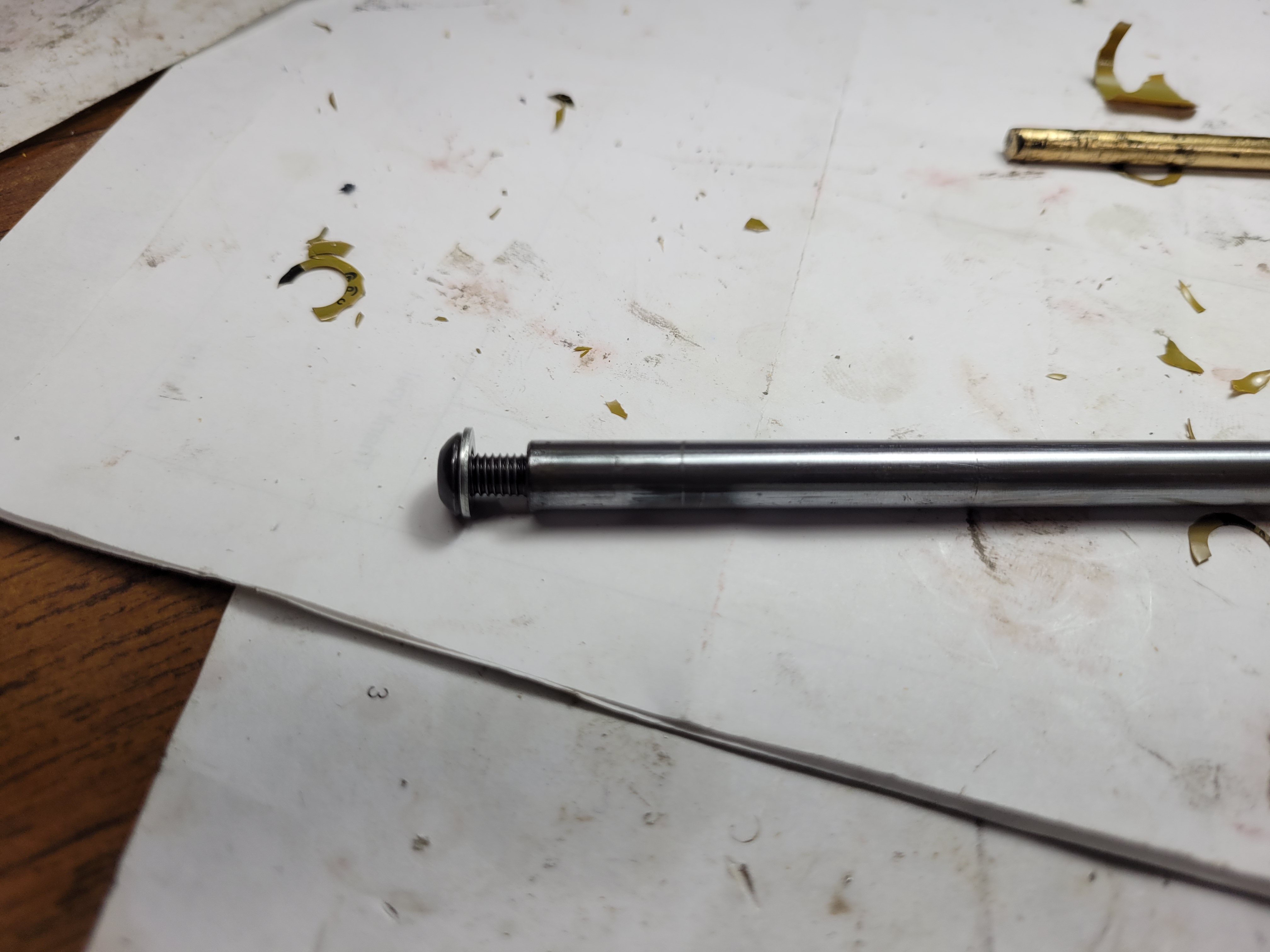

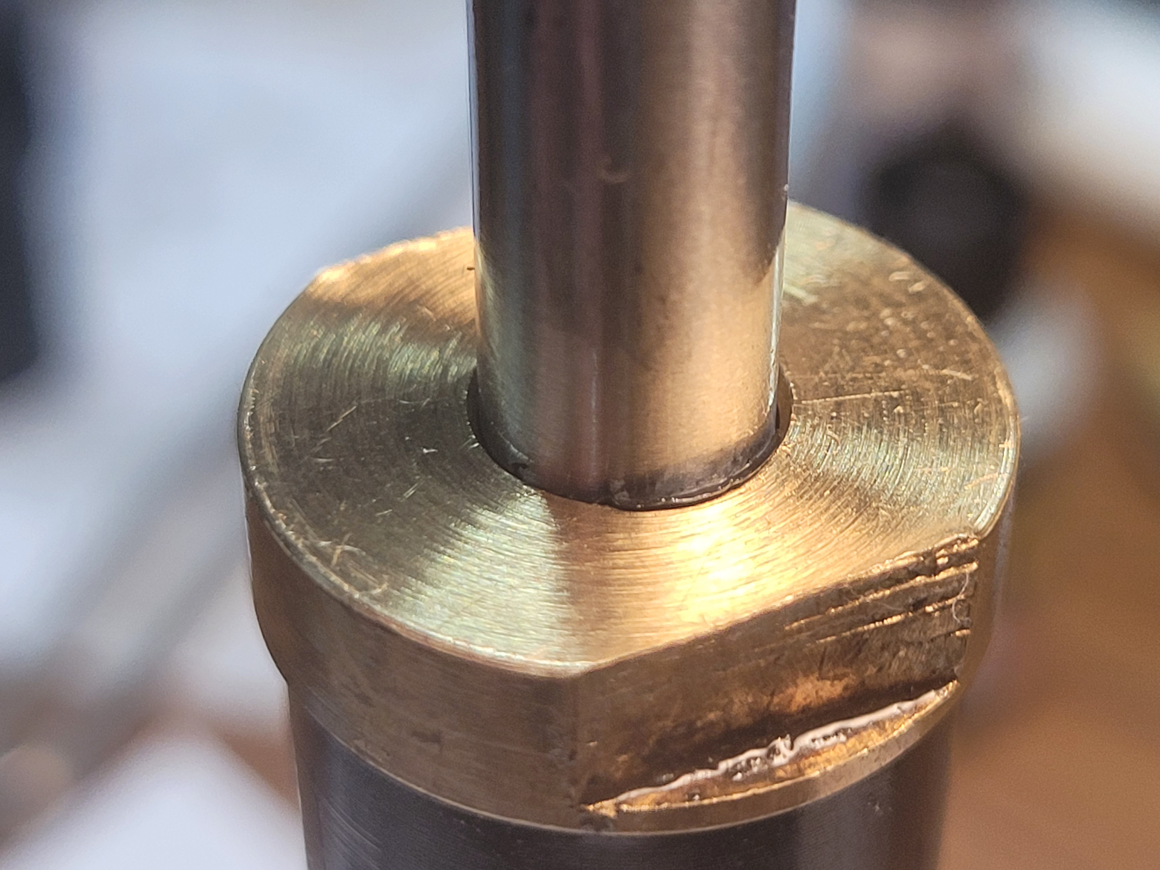

I wasn't finished with my post but my stupid phone was. Anyway here are a few things I have come across.
Reactions: A.G.R
I guess that maybe the pictures need a little explanation. The first picture look at the rod, blow it up so you can see the gouge. That gas ram was junk, no fixing that. Next picture the bolt sticking out was the stop bolt . That was keeping the gun from cocking. Last picture blow it up and look where the brass meets the rod and you will see the rubber o-ring sticking out. That gas ram took over 3 weeks leaking low enough to show slower chrony speeds. It was a very slow leak. I ope this help everyone.

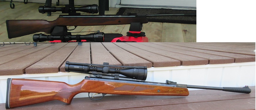

Fix the ram or just rebuild it as a springer. End caps between springer and gas ram are a hair different, so you just need the end cap for the spring version, the spring and spring guide.
My first rifle back to shooting was a Vortex rammed .25 caliber. Ram failure was my fault for tinkering with it, but thanks to a parts rifle that had an already tuned action from fellow member SpiralGroove, it's now a springer, still have it almost 9 years later, it still shoots very well and within 10fpe of what it did with the gas ram in it.
Before and after switching to spring and a stock refinish:
