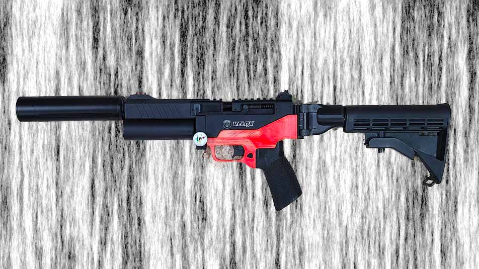

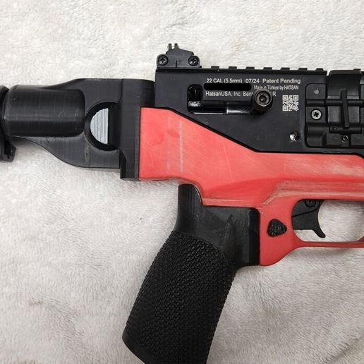

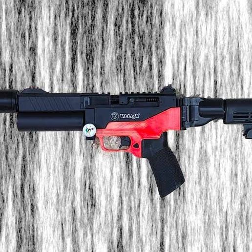

I made a new 3d printable stock "Velocity" that has a steel pined reenforced rear cleat. and AR Mil Spec grip..
It allows one to swap it out for collapsible buffer tube , rail or other mounts. Ill post a link later in thread.

/https://fbi.cults3d.com/uploaders/24502908/illustration-file/d34a22a0-72a5-41f8-a2a8-7a32a0bbd4e2/Hatsan-Velox-Velocity-stock-Left-A-Small.jpg)
Hatsan Velox "Velocity" stock . Mini carbine adapter.
Hatsan Velox "Velocity" stock . Mini carbine adapter. I made this for a trainer for my kids with my Pistol. We both win this way. It's in a frame they can fit and handle well and a frame I can shoot as a pistol or detach stock altogether with 2 screw. Whatever your reason for a carbine, this is...
