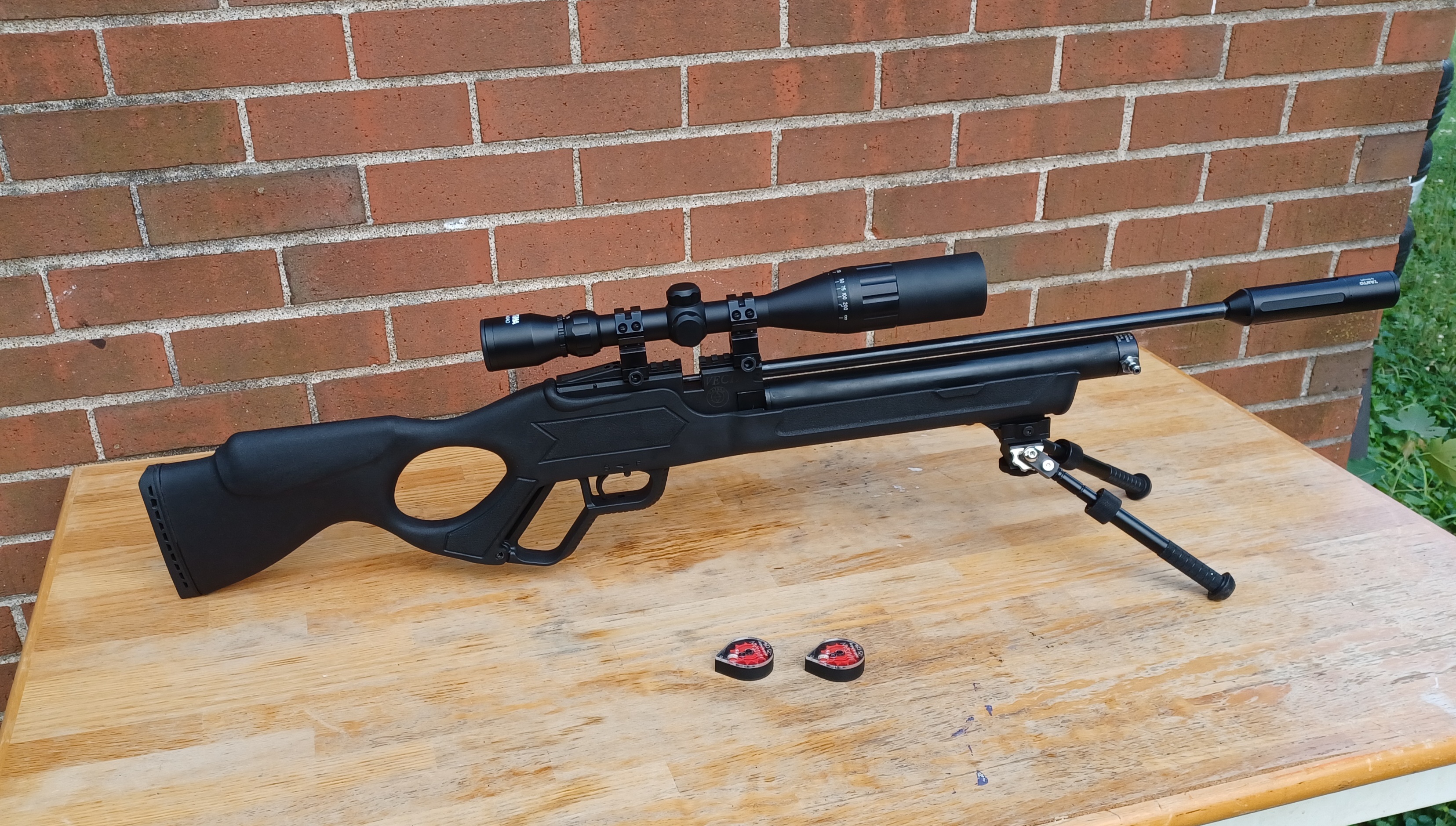

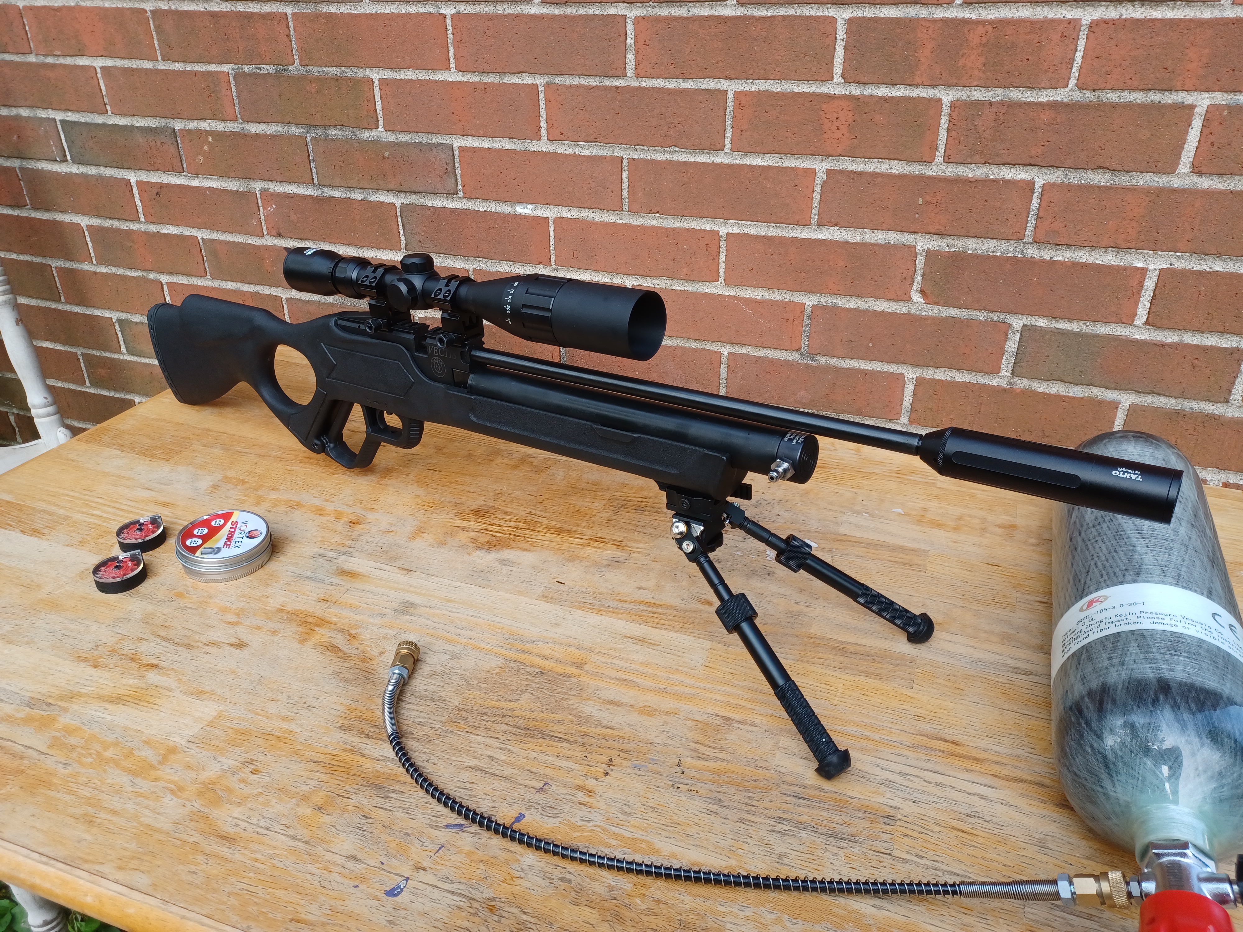

How many of you guys have a Vectis? I bought a 25 caliber back when they were on sale from PA a month ago for like $285. Figured I love my flashpup and regret selling my hydra, might as well try the lever gun. In stock form they are pretty fugly and loud, so I took off the top plastic barrel/tube cover and installed a Tanto. Tuned it for 800-825-800 fps for 3 mags with the cheap vortex pellets which it loves. Gives dime groups at 30 yards with the occasional flier. They're basically the answer to a 25 caliber premier lol.
Anyhow, I was out enjoying the weather and ripping through some pellets, these guns sure are fun! Go through 100 pellets really fast with the lever and a bottle on hand! My only regret with this gun is it being 25, due to pellet pricing and availability sometimes. That and it eats through air quicker.
