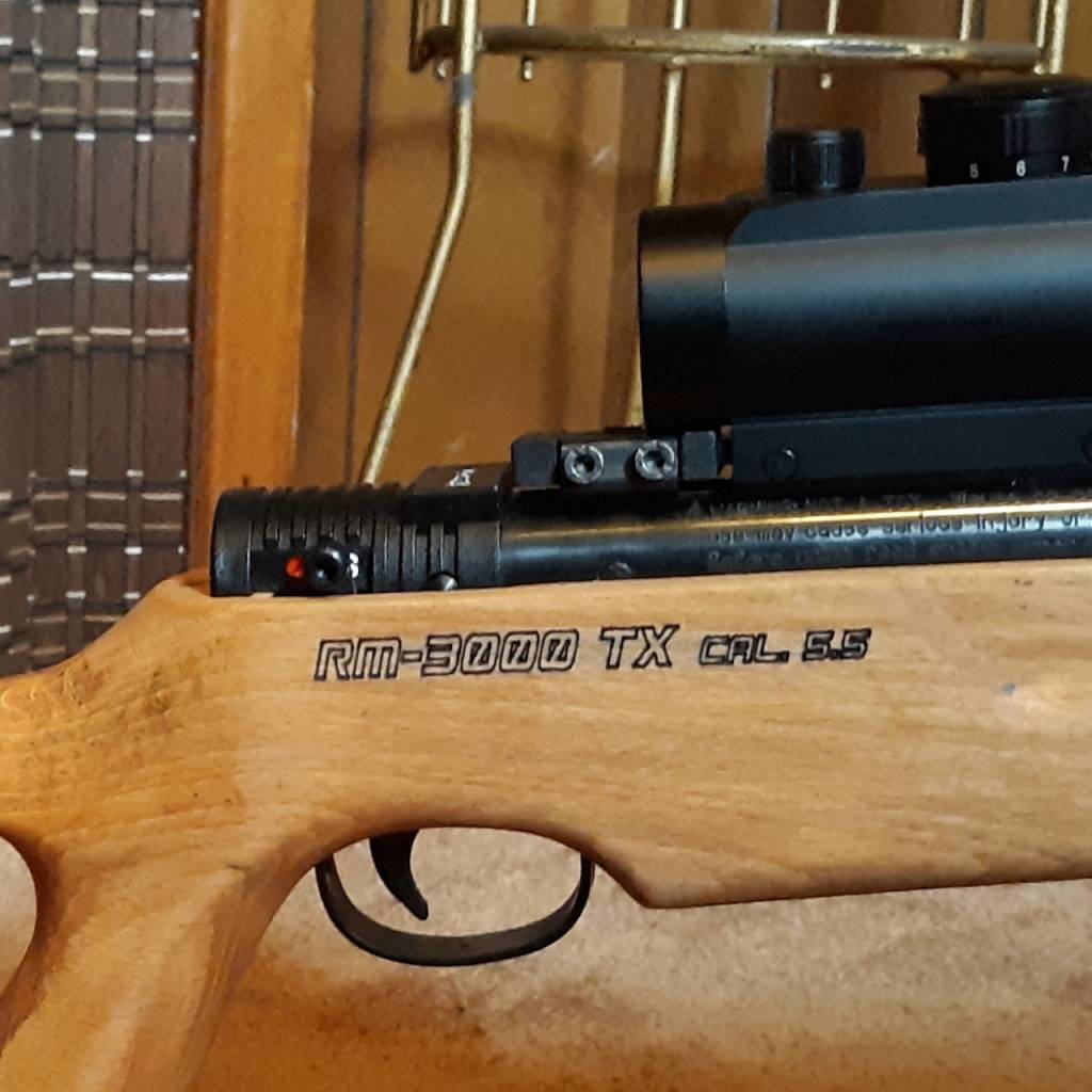

Hatsan stop plate screw dimensions?
I would just use the scope stop threaded screw hole and use that hole for the rear scope stop roll pin from Sportsmatch mounts or the threaded stop grubscrew from UTG or other generic rings or just use BKL 1 Piece .007 droop compensated mounts no scope stop needed whatsoever.
that makes sense. though i've always been worried about pushing one of those in too far and causing issues with the piston.
i feel like everytime i've tried to modify something on an air gun "not standard", i end up breaking it. which is also why i am finally jumping into the world of high end pcp's... no modification needed.
i've literally spent enough on the cheap stuff (that i somehow keep breaking) that i could have just bought a nice pcp by now :)
...but still would like to get the scope stop plate back in, as i doubt i'll ever stop enjoying springers
Use a scope stop. Email Hatsan and ask them for a Magnum scope stop. Gamo also has them. The one on the rifle is from Hatsan the other a gamo
thank you! emailed hatsan. hoping they will send some free as this has happened on 2 strikers, and a supercharger so far
