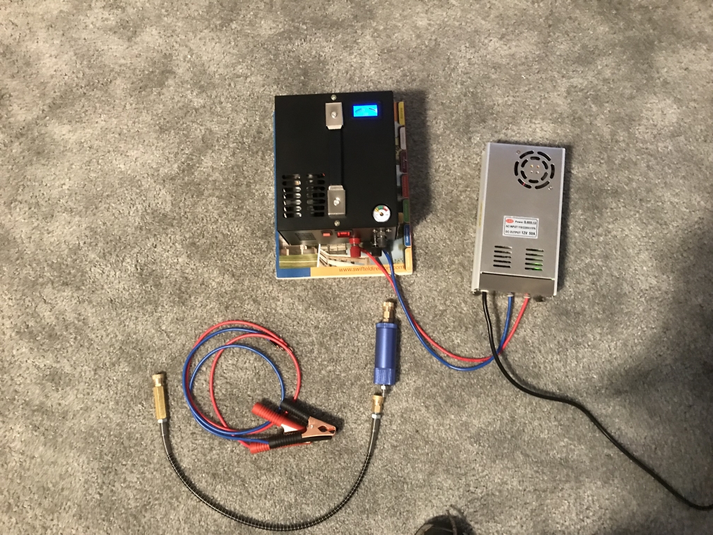

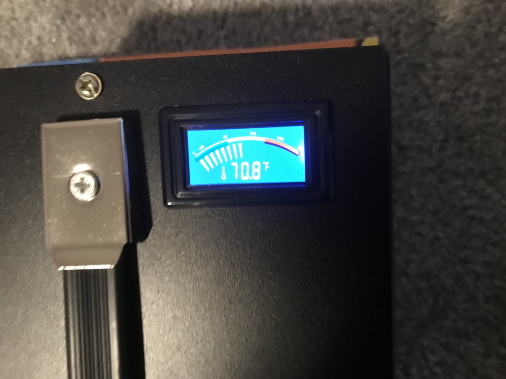

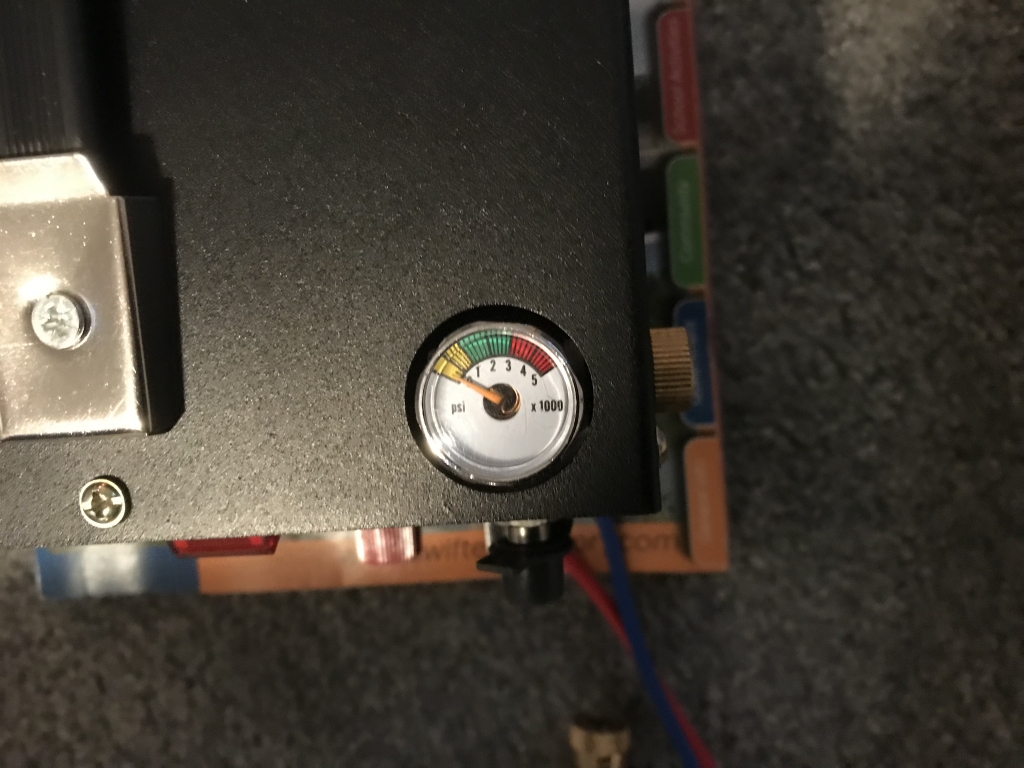

I don’t have an actual Spark, I do have the clone from Alibaba.com and it is working excellent. Just don’t over work it or overheat it and you should be fine. A heads up, these are rated to deliver 4500 psi but will live much longer if you stop at 3000 psi. I did replace the mpa gauge with one in psi and replaced the thermometer with one that reads in degrees F. The cost was less than $15.00 for the gauge and thermometer. The new thermometer is 12v hard wired and is lighted. Easy to wire in. I pulled the blue plastic off of the power supply for added heat dissipation, that’s why it is not blue colored. Salvaged the nomenclature sticker and reapplied. Great little unit for those on a budget but are tired of hand pumping. The answer is yea on this unit.

The only difference I see with the Alibaba.com clone and the spark is the spark has a black thermometer that reads deg.F and all the stickers. The spark doesn’t include the power supply which cost extra. It’s definitely the most basic 12 volt pcp compressor with only a switch for the fans and a switch for the compressor. No current draw meter or time delays or lock outs and no auto stop.

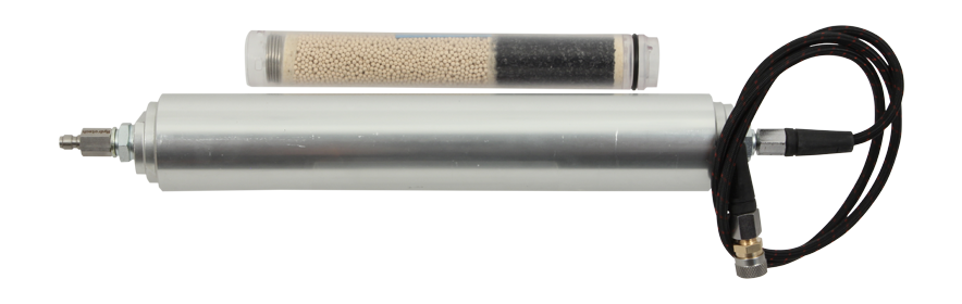

I've had one since December, I run fills through an omega air filter instead of direct:
adds about 2 minutes to all my fill times. I've been running it this way mostly in an air conditioned house, about 1-2 times a week, with one pesting trip running it off a car battery for around 5 fills in humid 90 degree weather. So far no issues, although temps did get around 180F in the hot weather.
Definitely worth investing in additional filtering for the Spark, Traveler and clones. They do condense water and the foam filters need to be regularly dried out. I use one with desiccant beads too.

I know this is kind of an old thread, but any chance you could provide links to the thermometer and pressure gauge you used? Went to use my Spark for the first time and thermometer doesn't work. I've actually had it a few months now but hadn't had time to do any shooting due to my work schedule. I know opening it up is likely to void the warranty but I don't want to have to send it to Hatsan to get it replaced. I'm only direct filling air tubes for a Hatsan Bullboss so I don't think run time temps are gonna be an issue, but I'd rather know everything is as it should be. And I really like the fact that the thermometer you used is lit. Do my filling in the basement with less than perfect lighting. Thanks in advance for your reply.
