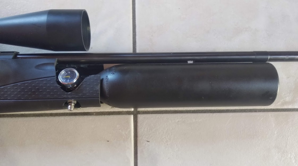

M Mikepr Member Sep 21, 2017 269 9 Attiki, Greece Mar 24, 2020 Add bookmark #1 Mar 24, 2020 Add bookmark #1 Thinking of put a paintball reg set at 150 bar + an adapter-plenum Thoughts opinions ?

M Mikepr Member Sep 21, 2017 269 9 Attiki, Greece Mar 24, 2020 Add bookmark #4 Mar 24, 2020 Add bookmark #4 Ι did it once with an umarex 850 conversion pcp,works great, very concinstant, no leaks, no creap The bottle side is 18X1.5 At the other side needs an thread adaptor used as plenum also Upvote 0
