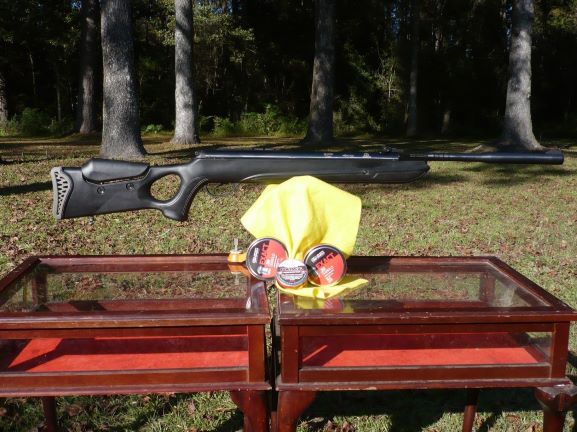

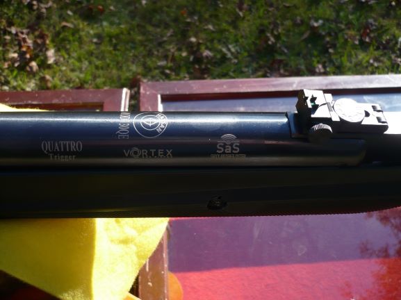

I received the Hatsan in good order, a very nice rifle indeed! It came with some nice features , thumb hole stock, adjustable cheek rest, inserts for adjusting length of pull of butt stock, fiber optic sights, adjustable rear sight, sling swivels, nice checkering on pistol grip and lower sides of stock area, scope rail for both Weaver and 3/8/11mm mounts. Quattro Adjustable trigger, automatic safety. The bluing was ok; one noticeable thing was the short barrel, it is shrouded which makes it look longer, in actuality the barrel is only 10.5 inches, the shroud adds another 6.5 inches for a total of 17 “. Which is good; without the extra length of the shroud, thing might be near impossible to cock; for me anyway, LOL!!! Anyhow the short configuration of the barrel/shroud decreases ones leverage and increases the cocking effort on this unit, stated at about 50 lbs!!! The QE designation denotes Quite Energy (sound suppression) Total weight 9.75lbs and 47.5 inches OAL on mine!! Going to be some tradeoffs for this kind of power!! This is a BIG Rifle!!!! (REMINDS ME OF HANDLING MY K 98 MAUSER)! I left the trigger alone at this time, broke at 5lb 3 oz. after the break in will look more closely at this!!

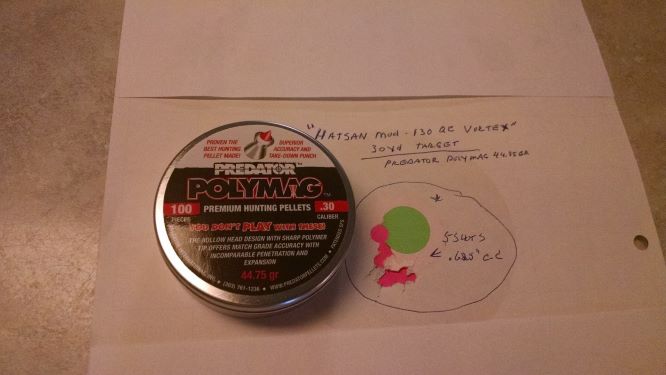

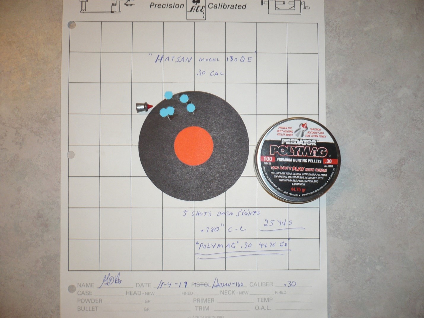

The first 5 shots averaged 570 fps @ 32.3 ft. lbs. “A REAL THUMPER”, but just as impressive was the group size, 5 shots equaled .780” C-C about an inch high, this with open sights!! Impressive as well were the holes in the target!! Man that 30 caliber makes BIG HOLES!!!!! Nope; I don’t have anything in my air gun arsenal that will come close to this as far as Accuracy AND Power!!! Better Accuracy yes!! Accuracy AND power NO!!! (And yes the JSB .30 caliber are now on order. 44.75 gr. and 50.15 grain Dome) Hope to have them before conclusion of this write up if so will be included herein!!

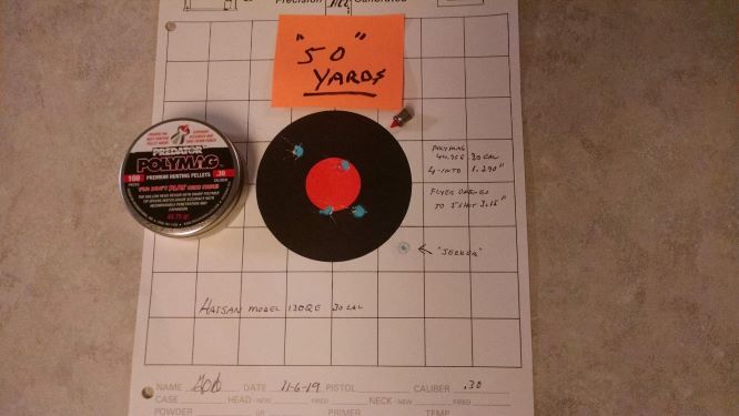

It was now time to see what this .30 caliber could do at 50 yards, shot from bench rest! The Polymag 44.75 .30 caliber delivered Stunning results!! 4 into 1.290” Center to center and dead center in the bull a 5th low, opened the group to 3.15”, I jerked!!!! This is with open sights, it was not an anomaly I was able to duplicate it!! That was impressive!! I mean ¾ inch groups at 25 yards less than 2 inch groups at 50 yards 32. Ft. lbs. all this with open sights!!!!

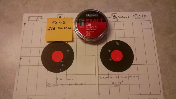

I did get in the JSB 30 caliber ammo, and with no changes to the sights; set up bench for 25 yds. JSB 44.75 grain averaged 566 fps. @ 32ft.lbs and 5 shots into 1.94” CC and shot to same POA as the Polymag and dead on!! Next I set target at 50 yds. 44.75 grain 4 shots 2.165” dead on in the bull with a fifth enlarging the group to 3.185” Again I jerked the last shot as I sometimes do!!
Next up at 25 yards, the 50.15 grain JSB; averaged 523 fps. 30.4 ft.lbs. 5 shots = 2.400” CC! Next; with target set at 50 yds. 5 shots into 2.545” CC. Basically for all practical purposes the; .30 caliber, Polymag 44.75 grains JSB 44.75 grains .and 50.15 grain all shot to the same P0A !! Remarkable!! I would have to give the edge to the Polymag 44.75 grains in the accuracy department, BUT NOT BY MUCH, the other factor is the cost, the Poylmag is a bit cheaper BUT there are only 100 rounds per tin as opposed to 150 rounds per tin with the JSB!!
