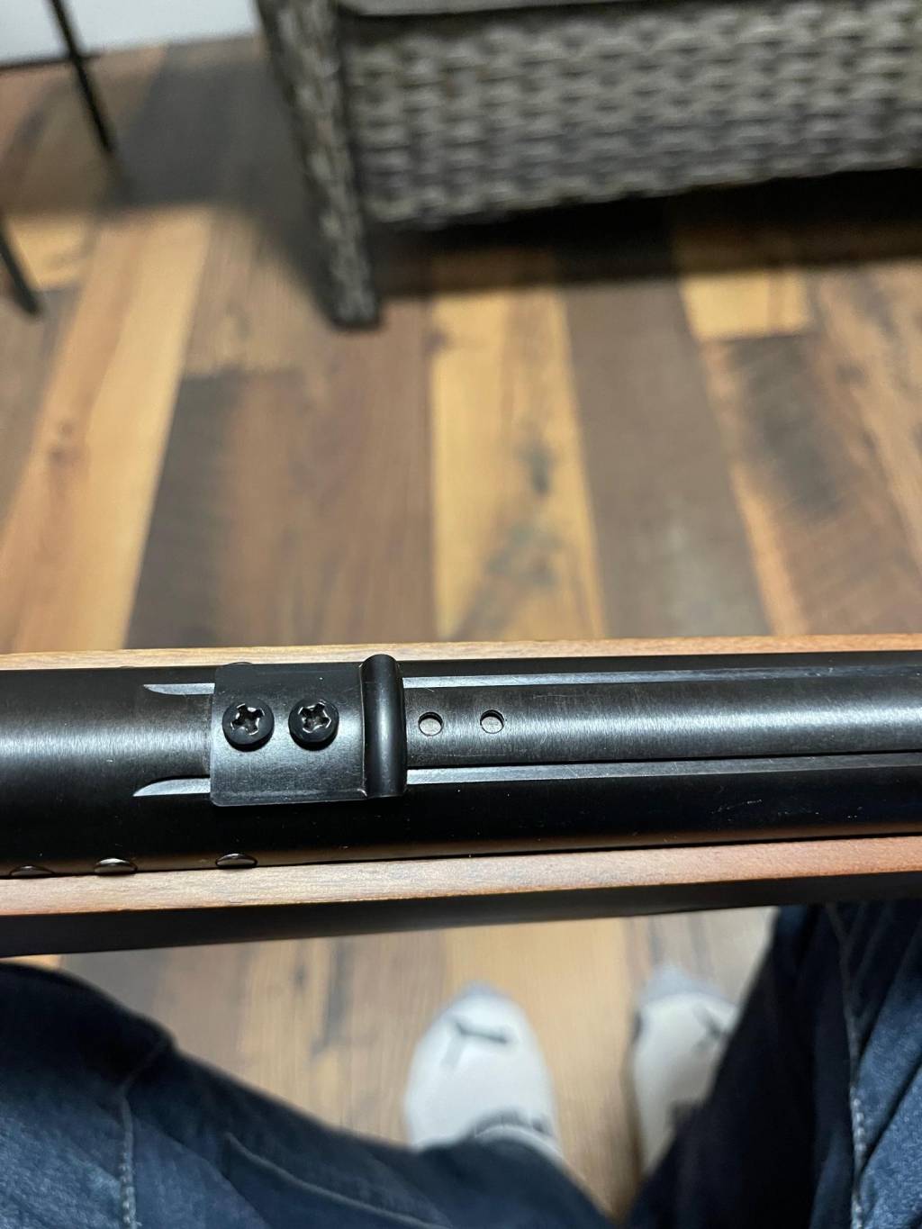

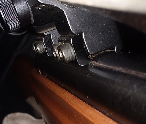

I just received my Hatsan Mod 95 Vortex Brake Barrell today but I confused about the scope mount, it says on the Hatsan website 11mm Dovetail but my 2 different UTG Dovetail mount didn't fit correctly, little gap on closing side not flush fit. Looks like dovetail but buttom is not flat because tracks on the barrel and it is curved shape, looks like curved barrel dovetail, even Hatsan comes with combo Scope and their scope attachment has the same problem, doesn't fit flush. I already attached the pictures, what kind of scope mount should I use? Thanks for the help.

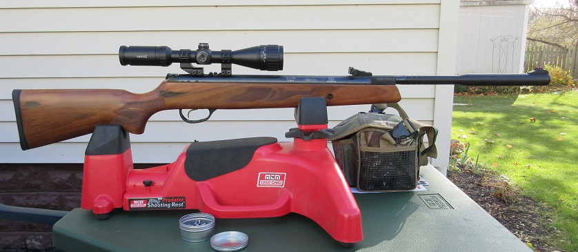

The rifle in the picture is my Hatsan Model 95 QE .22 with those rings and a Vantage 3-9x40 AO IR scope. At the end of the day, you'll have to get your scope mounted in your mount of choice and start shooting to see what's going to work best for you and your shooting and only you can decide that. A Model 95 .25 was my first getting back into shooting air guns and it took me awhile and several types of 1 piece mounts and ring sets before I finally found what worked best for me.

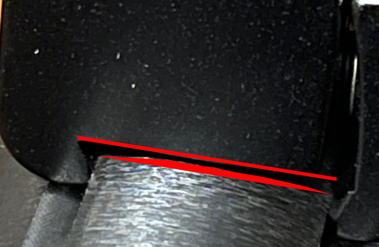

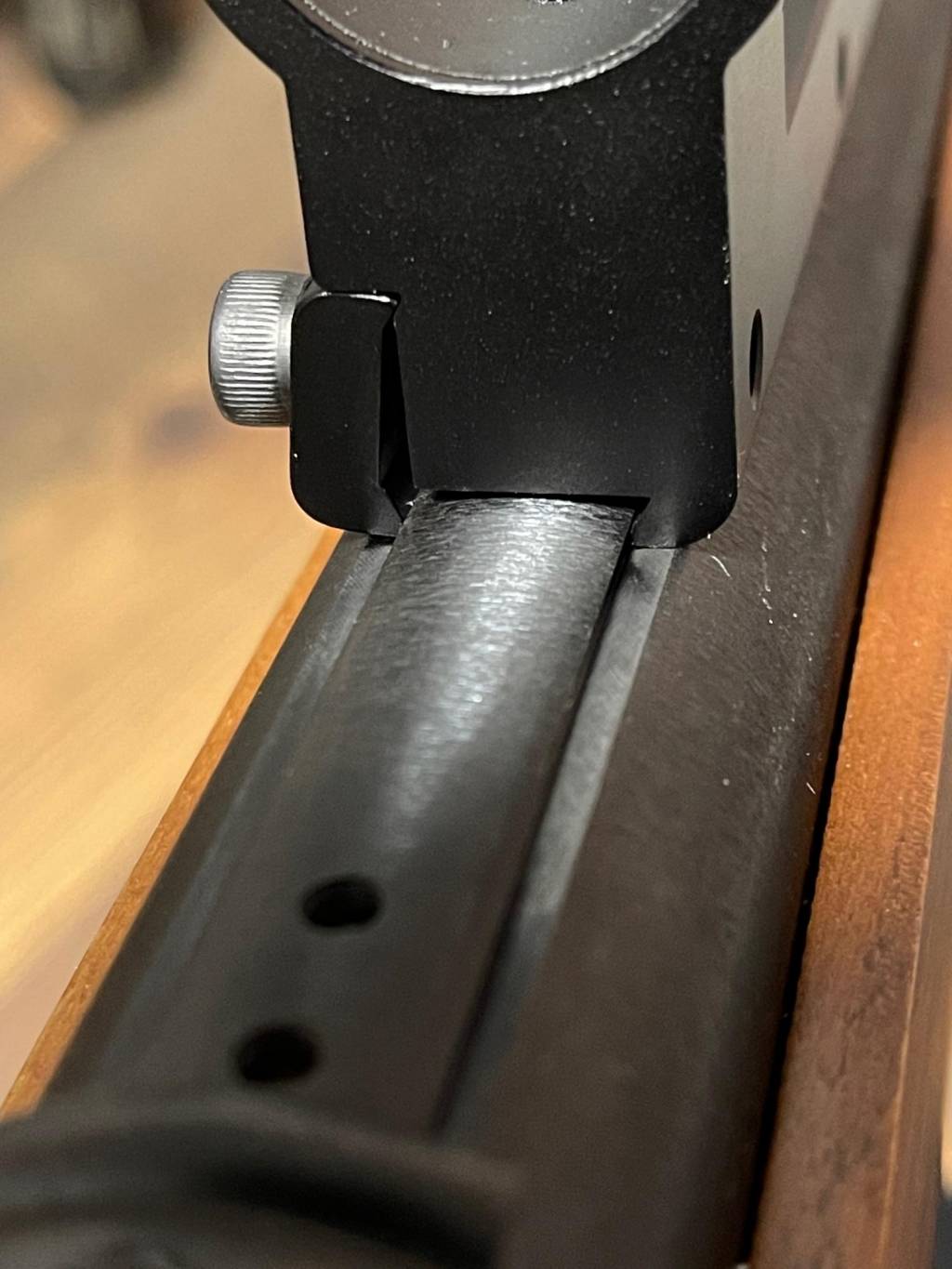

You may have to take all the screws out and flip that plate over to make it fit right since they don't always put that plate on there with the side you may need facing down. Try that, see what happens and let us know.
Right...

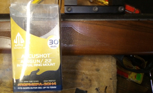

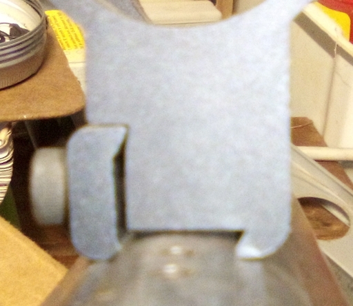

Notice the the clamp jaw edges .. one side is taller then the other.. ( i have a thread and pictures of this at gta ).
Heck got pictures..
Notice the jaw edges
Then one way looking squewd.

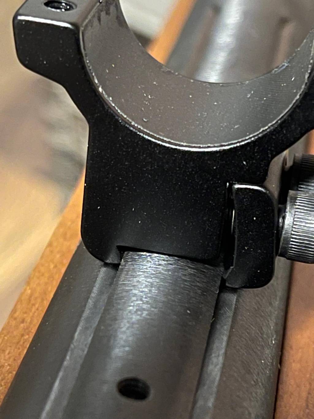

Then fliped and flush
Burr... Went out and suffered this miserable florida cold morning and mounted a new ugt one piece mount on my hatsan 95 with the jaw reversed from what your picture shows .. nice tight and flush...
See one way fits standard usa inch dovetail and flipped it fits metric 11mm..
Notice the box says airgun and or .22 rimfired..
