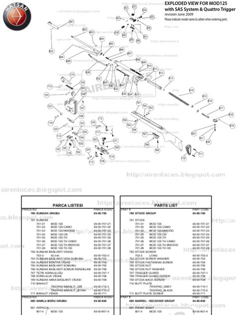

I have a Hatsan MOD 125 Sniper Vortex 22 cal that I want to convert from gas ram to spring.
Since it's difficult to find the parts for the conversion, I bought the standard MOD 125 spring model .177 caliber. The idea to basically swap barrels: Sniper 22. barrel to the action of the standard 1.77 and the 1.77 barrel into the .22 Sniper action.
I think the actions and the transfer port are the same (transfer port hole looks the same dimension, allthough the Sniper action has somekind of sleeve pressed in there. But with the sleeve it looks the same with .177 transfer port.
Now the question is: is the standard MOD 125 .177 versions spring the same that is used in .22 Sniper spring version? And also can I put the Sniper .22 versions gas ram into the .177 action? Are they equal?
The spring that was in the .177 version is I think 43 coils and 353mm long. Some 125 models might have 48 coil springs from what I can understand from youtube videos. That confuses me.
Thanks,
Jarkko
