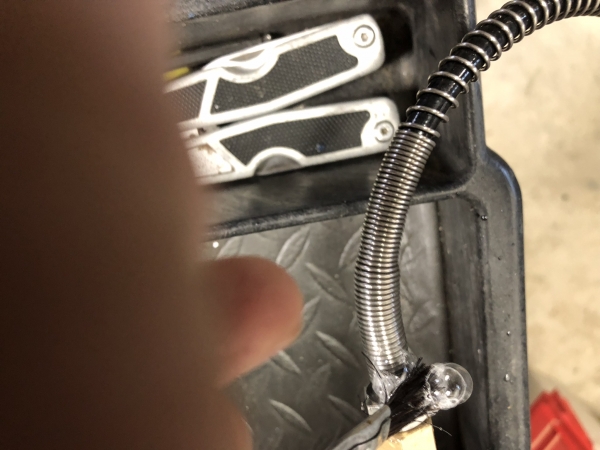

Hatsan Lightning has been excellent for me so far. Last time I used it two weeks ago, the fill whipmhad a leak at the discharge end. The leak was coming from the crimp from fitting to hose. No biggie, a quick photo and video of the leak sent to hatsan, and next day they emailed me telling me a new whip was in the mail.
1544088602_11509681015c08ec1a2398f0.00827482_AD43EF1D-791B-4EB4-8AF3-F526C722C817.jpeg
acid brush applying leak detection solution- see the bubbles?

Good to hear that Hatsan is taking care of you. Doesn't the Hatsan include moisture filtration? mr.grimm seems to suggest it does not. From which would one get better service, a vendor of Tuxing or Hatsan?
