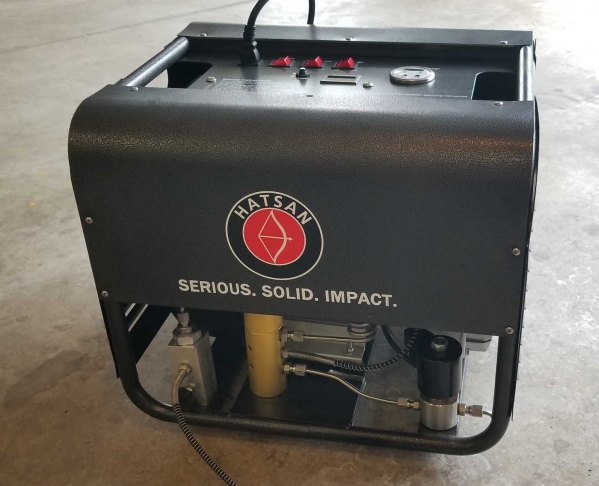

I got home from my trip an was able to setup, break-in, calibrate and fill two bottles with my new Hatsan Lightning Compressor today. My experience with compressors is owning a Yong Heng for the past 8 months and rebuilding it when it needed service. I have two bottles, a 72CF 4500 psi Tiger shark and a 90ci (14CF) 4500 psi Benjamin bottle.

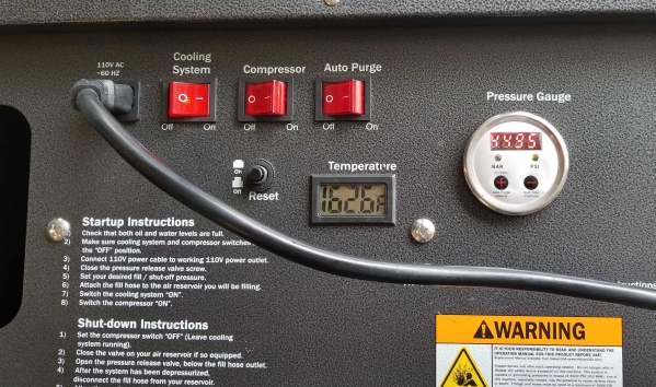

The digital gauge is a great feature. You can calibrate it to match your gauge on your tank. Mine was about 150 psi low. Both my tanks have Expert HPA valves and gauges that match each other, so I calibrated to them. Once that was done, the auto shutoff was dead on. Through the gauge you set Bar or PSI, auto shutoff and the auto purge interval in minutes. The auto purge is a great feature. I tested it at 3 min, 10 min and 15 min. I’ll keep it set at 10 min to allow one purge from 3000-4500 psi.

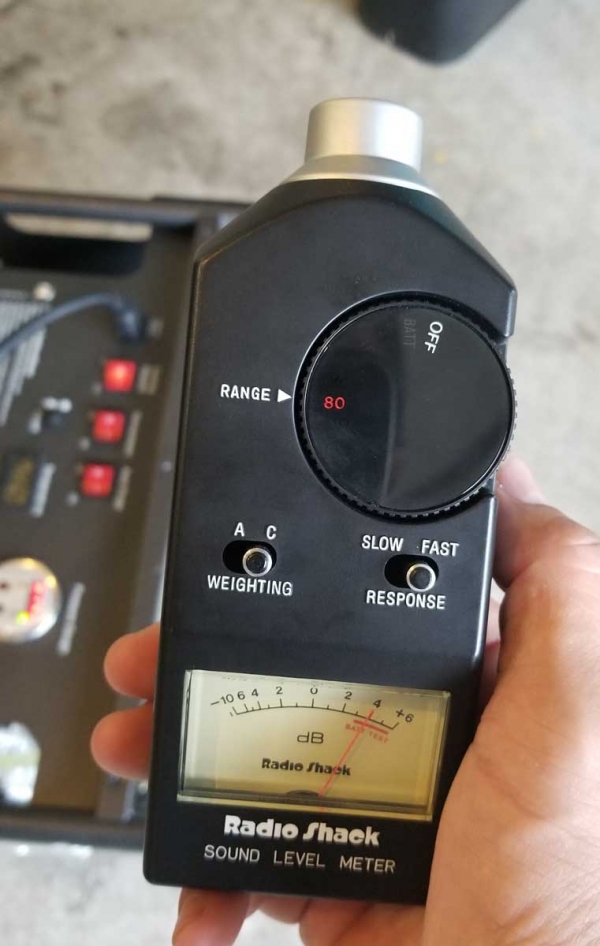

I filled three bottles so far. The compressor is quiet compared to the Yong Heng. At 3’ its 84 db, easy to hold a conversation over it. The Benjamin 90ci (14CF) bottle took a lightning 2 minutes to fill from 3300-4500. The Tiger Shark 72cf tank took 15 min from 3000 to 4500psi with one purge. After about 45 minutes of use/break-in, I changed the oil and it was mostly clear.

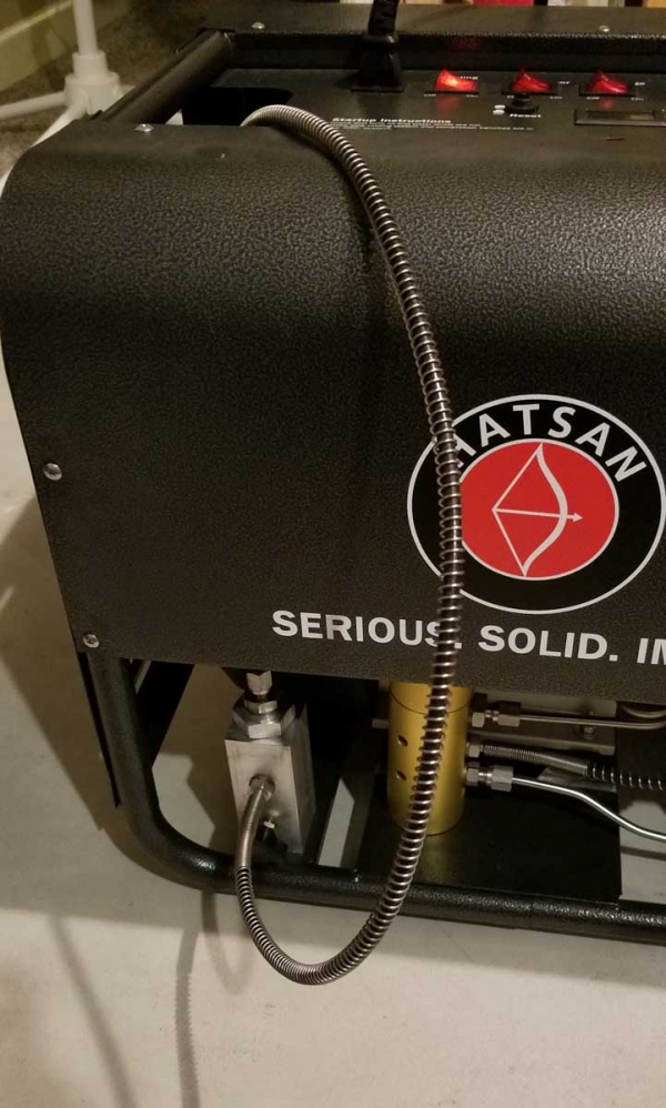

The block that the fill hose connects to should be turned 90 degrees or set back a couple inches. There is room for this and it would keep the hose connection inside the protected area less susceptible to getting bumped and damaged. I will probably rotate the block, since this wouldn’t equire a new air line, but I shouldn’t have to. Also, unless you install a QD on this block, the hose is always attached and dangling when you move it. A clip or holder for the loose hose would be a nice feature. Both can be done simply by the owner, but it would be nice if it shipped this way. Yeah that’s all I could find for improvements, so overall, I’m extremely happy with it.

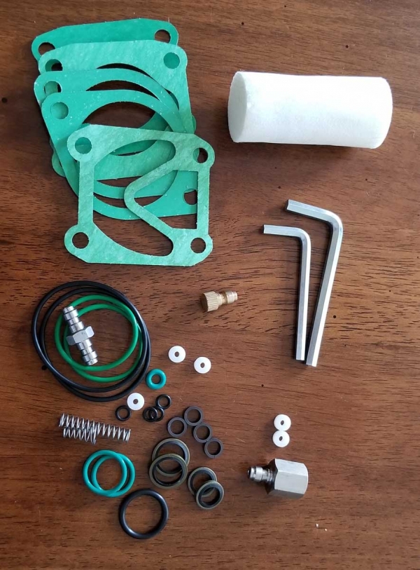

This compressor rocks compared to the Yong Heng. Its faster and quieter with more options. I’m guessing the guts are similar to the Air Venturi, but with upgraded SS fittings, moisture separator, auto moisture purge and digital calibratable gauge. I got a smokin’ deal though Lethal Airguns making it less expensive then the AV. It came with enough consumables to rebuild the compressor 2-4 times. Lethal Airguns is a service center and has answered every question before and after the sale that I’ve had. So, I’m confident if there are any issues they will be taken care of.

Compressor and operator panel
84 db
Extra "consumables" parts

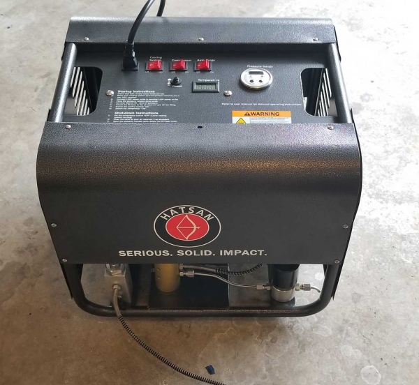

Almost perfect

Mark @marknagel, thanks for the review, appreciate it. One suggestion. Take a look at the outlet valve block (last photo, aluminum block with the manual purge valve and outlet hose). At the top is a large nut that would be removed to replace the teaspoon full of desiccant inside. There is a small metal "cage" inside that holds the silica beads.
My recommendation is to remove and discard the beads and instead put a small cotton tampon filter in its place. The silica will become wet over time and cause corrosion. Also, when you reassemble, put some anti-seize on the threads of the large fitting. If you don't, it will become very hard to remove the next time you try to open it up. I speak from experience.
I also recommend using one of the "gold" filters as both I and @humdinger have recommended on many posts over the past year. You'll be glad you did. For under $100, its inexpensive insurance...
Mike
