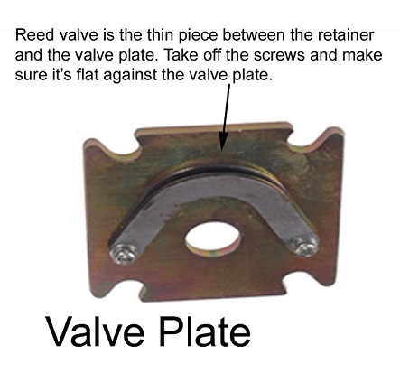

The low pressure side is easier to work on and diagnose issues than the high pressure piston. If you are comfortable that there isn't a problem with the high pressure piston then follow Bigragu's links and clean out any corrosion or rust in the low pressure side. It sounds as though back pressure blew off the air filter on the low side. Take off the pressure plate and clean off any corrosion build up on the reed valves and metal plates. I noticed lots of rust from moisture getting past the air intake filter when I recently repaired an Air Venturi compressor. Check to see that the thin reed valve that is held between the valve plate and it's U shaped retainer as pictured here. Remove the 2 screws holding the 2 parts the valve plate to reach this reed valve. I bent mine straight and flipped it over so that it would be tight against the plate.
