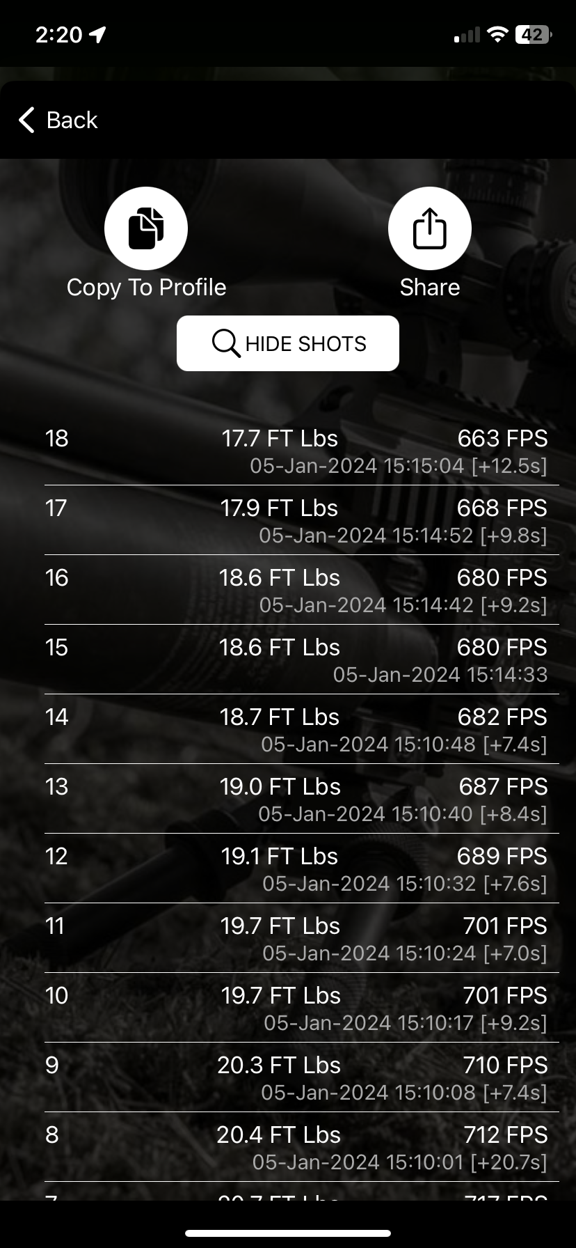

Regarding what is perhaps the primary complaint against this gun however, I didn’t find the shot count to be that much of a problem. Here is an 18 shot string using JSB 18.1 pellets. What I found is that the first 14 shots are relatively consistent and that will empty the first two seven round magazines that come with the gun and given what a small reservoir it has I found I could recharge it on my compressor in less time than it took for me to reload the magazines.

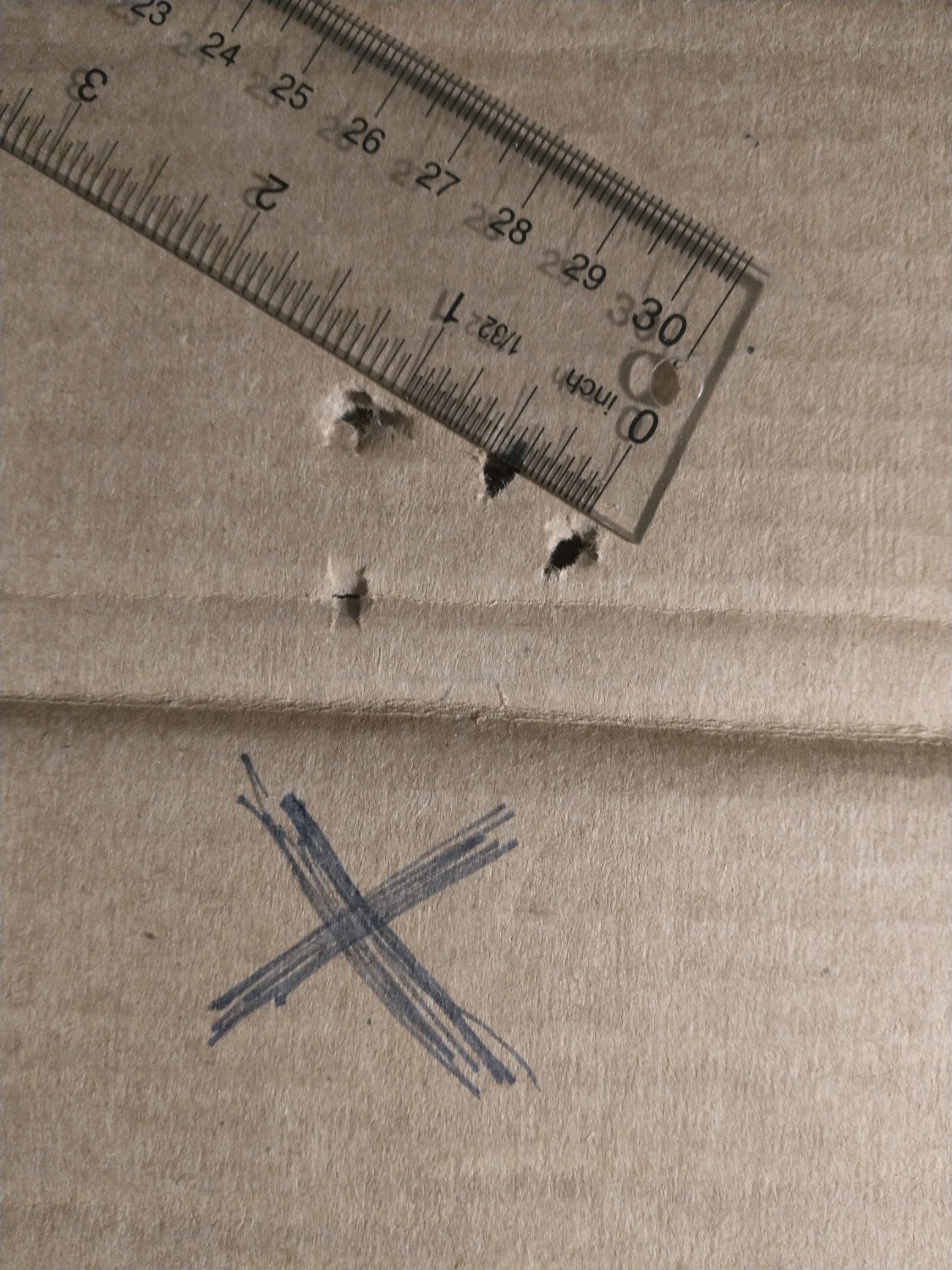

40 yards with my bottled Jet 1 running a 1800 psi regulated tank (16 fpe) shooting Air Arms 25.4s. It would probably be better, but I'm running a 4x Monstrum Stealth that has a 2 moa dot in the center of the reticle.
I'm sure they have the potential. The problem guns probably just need some loving done to the barrel.
40 yards with my bottled Jet 1 running a 1800 psi regulated tank (16 fpe) shooting Air Arms 25.4s. It would probably be better, but I'm running a 4x Monstrum Stealth that has a 2 moa dot in the center of the reticle. 5 shots

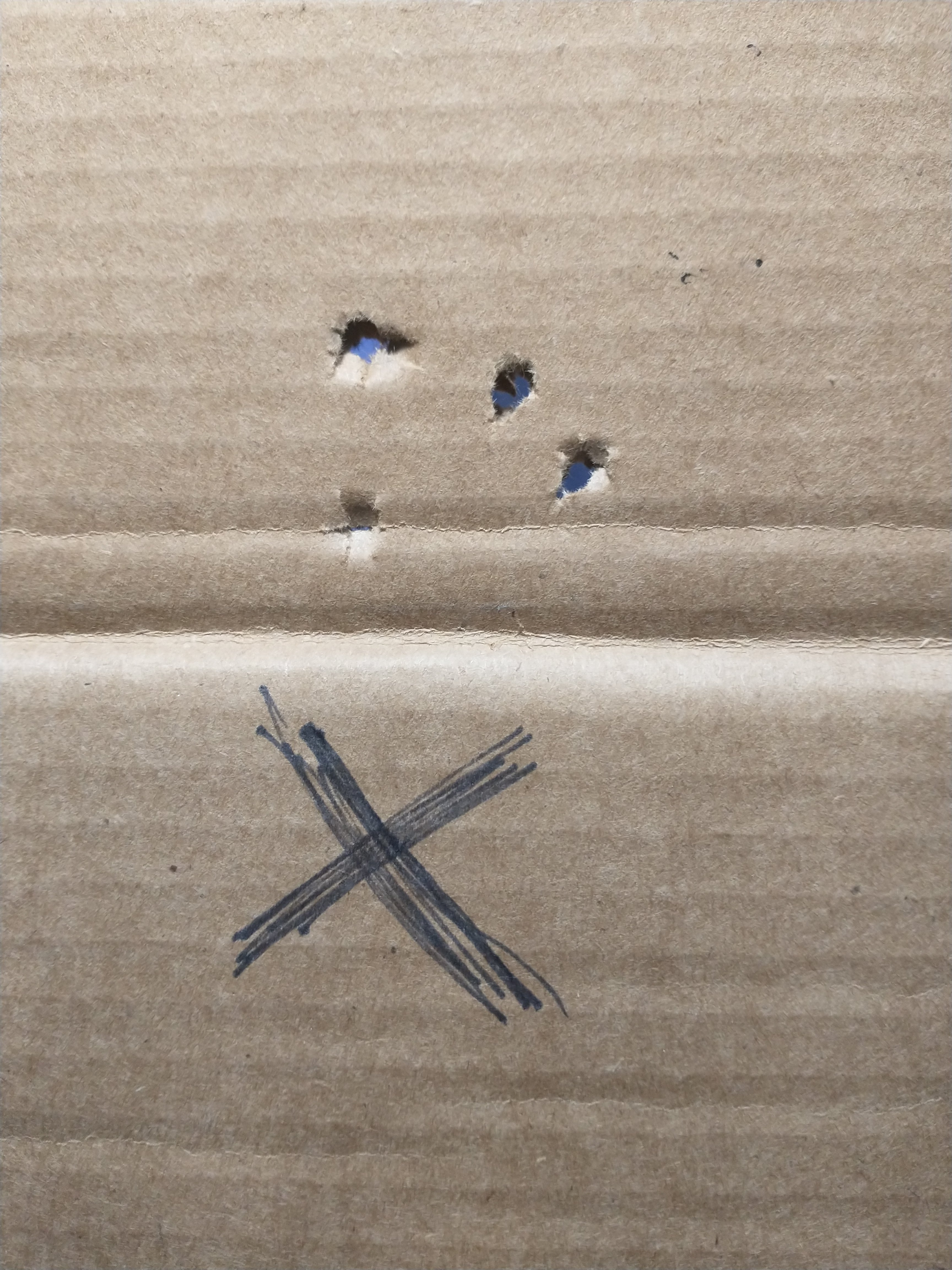

I got about a dime sized 10 shot group @ 12 yards today with 18.1 JSBs. It probably could do better than that as I was just sighting it in and verifying that the baffle strikes were no longer happening. I was actually quite pleased with the accuracy of it once I got the bugs ironed out. I was hitting targets out to 50 yards without many misses and just guessing at the holdover. I put a 3-12x scope on it and I could see the pellets in flight.
I'm not having any trouble hitting my 50 yard spinners either. I can see my pellets in my 4x scope when I have my 800 psi tank on it.

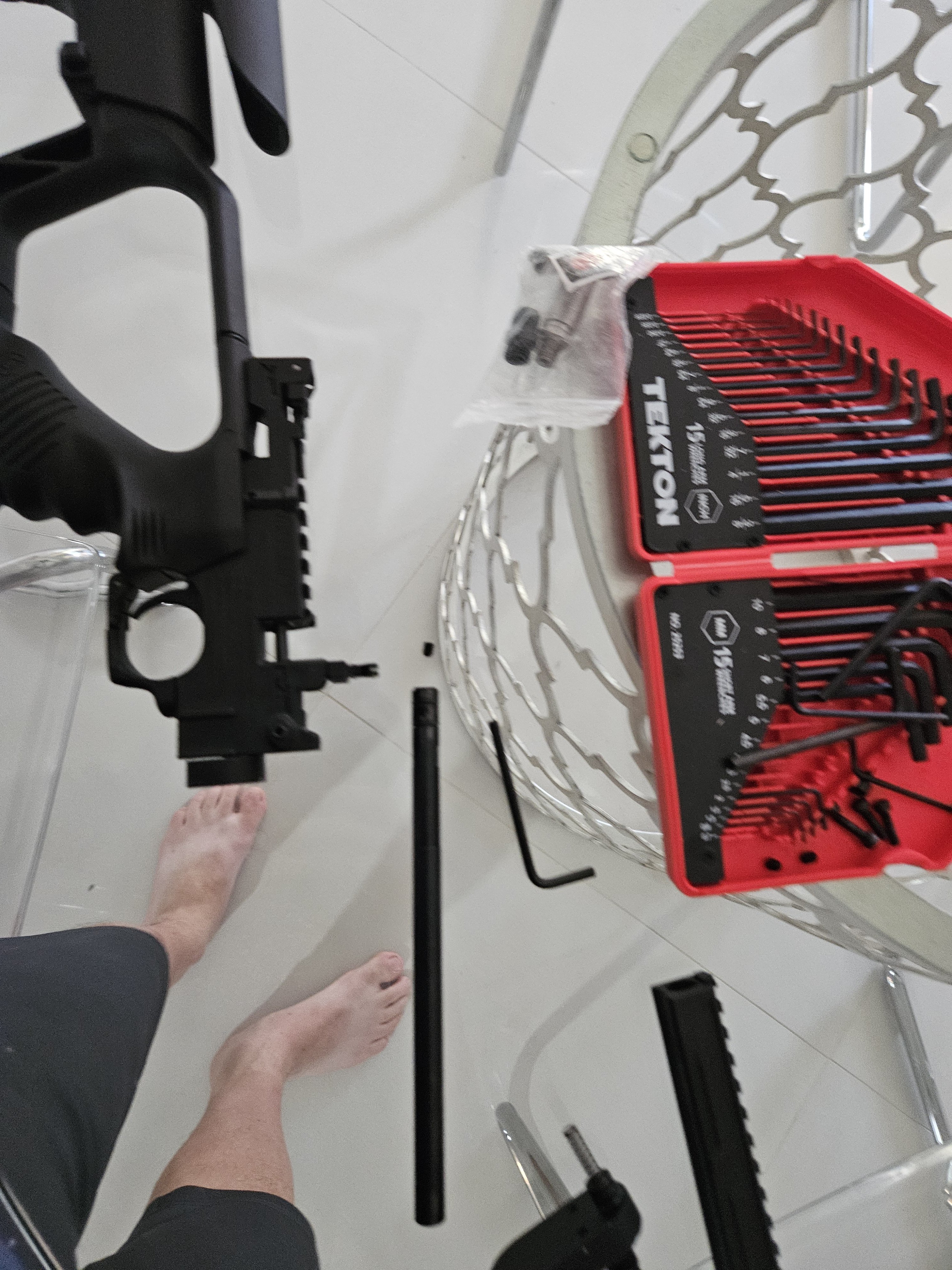

I just got mine and out of the box leaked air when I try to fill it. The air goes directly from the compressor to the bottle and out of the barrel. Took it on a parts and from searching the diagram looks like it's missing a O Ring that is sealing the valve on your picture.
What a junk, bought it from Amazon and they refunded me without asking me to send it back. So now I will just try to find that size O ring and make it work.

Did you try cocking it before filling? It sounds like the poppet isn't sealing. The o-ring is only meant to prevent blow by during the firing cycle.
Yes I did
After assembled it back started filling the tanks but it's leaking slowly and uses way too much air when fires. the O-ring is completely missing. The part number is 2313. I am trying to find what size it is.
