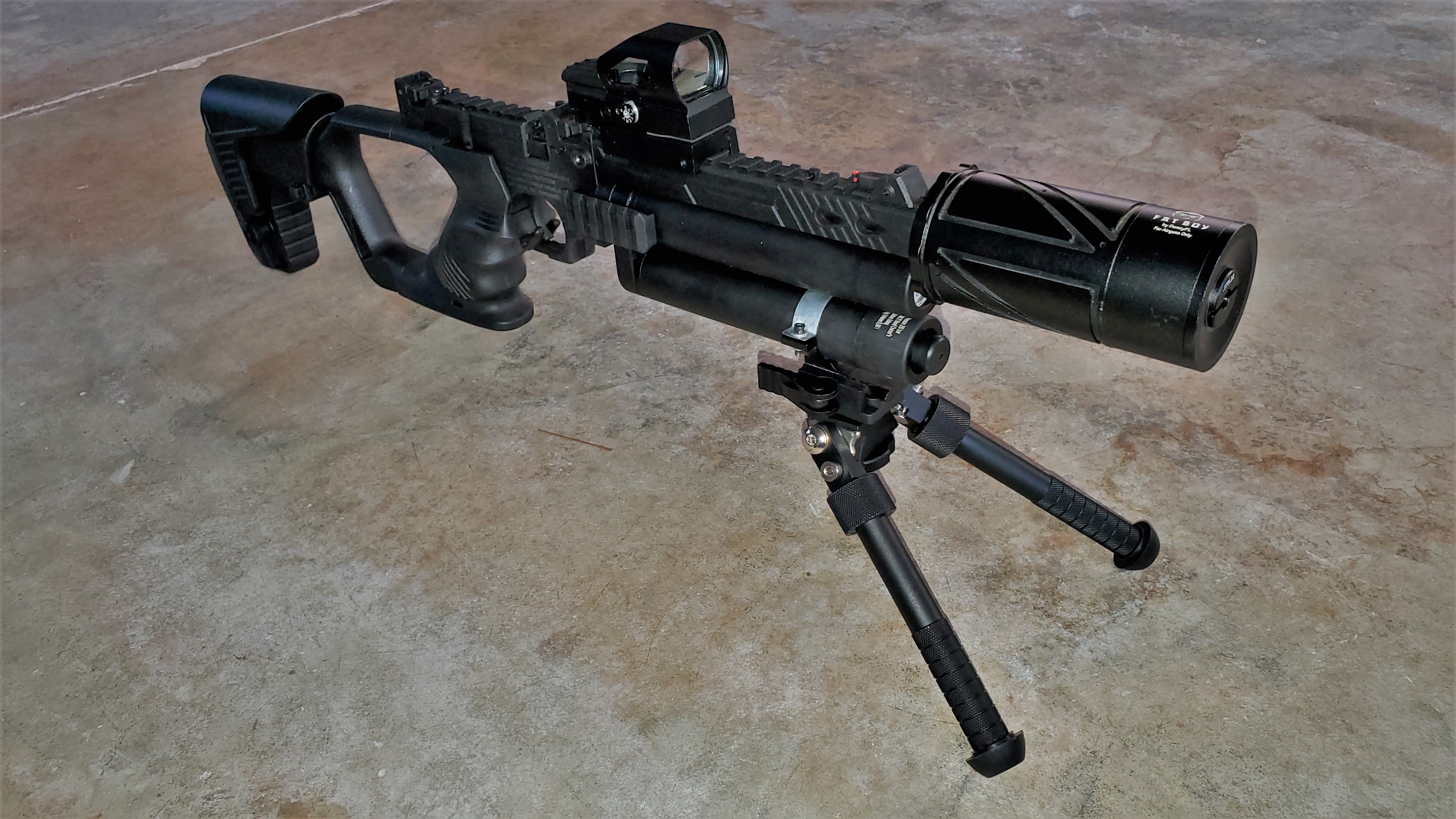

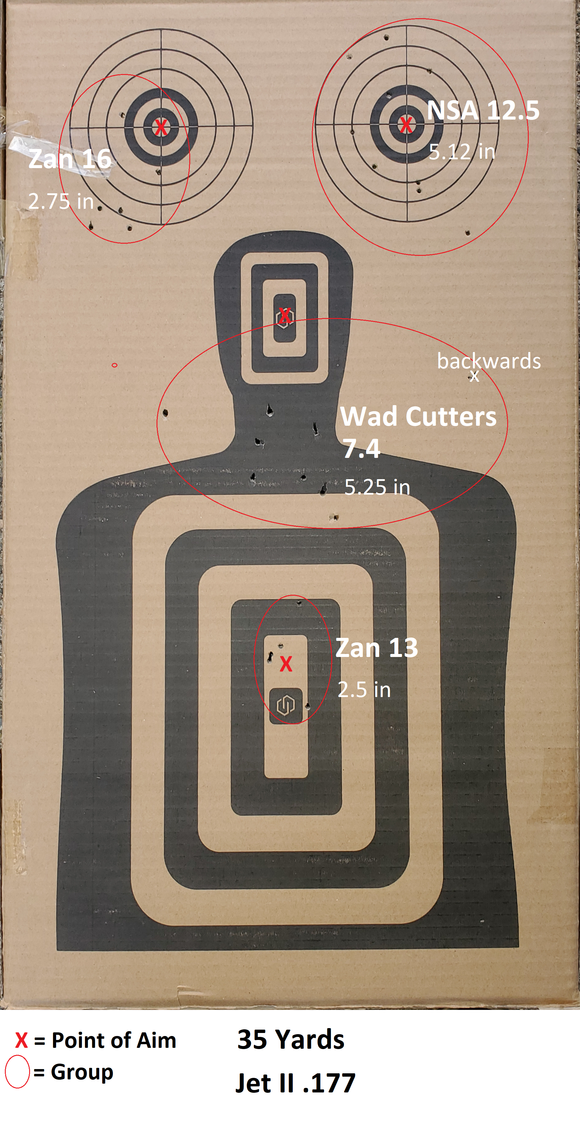

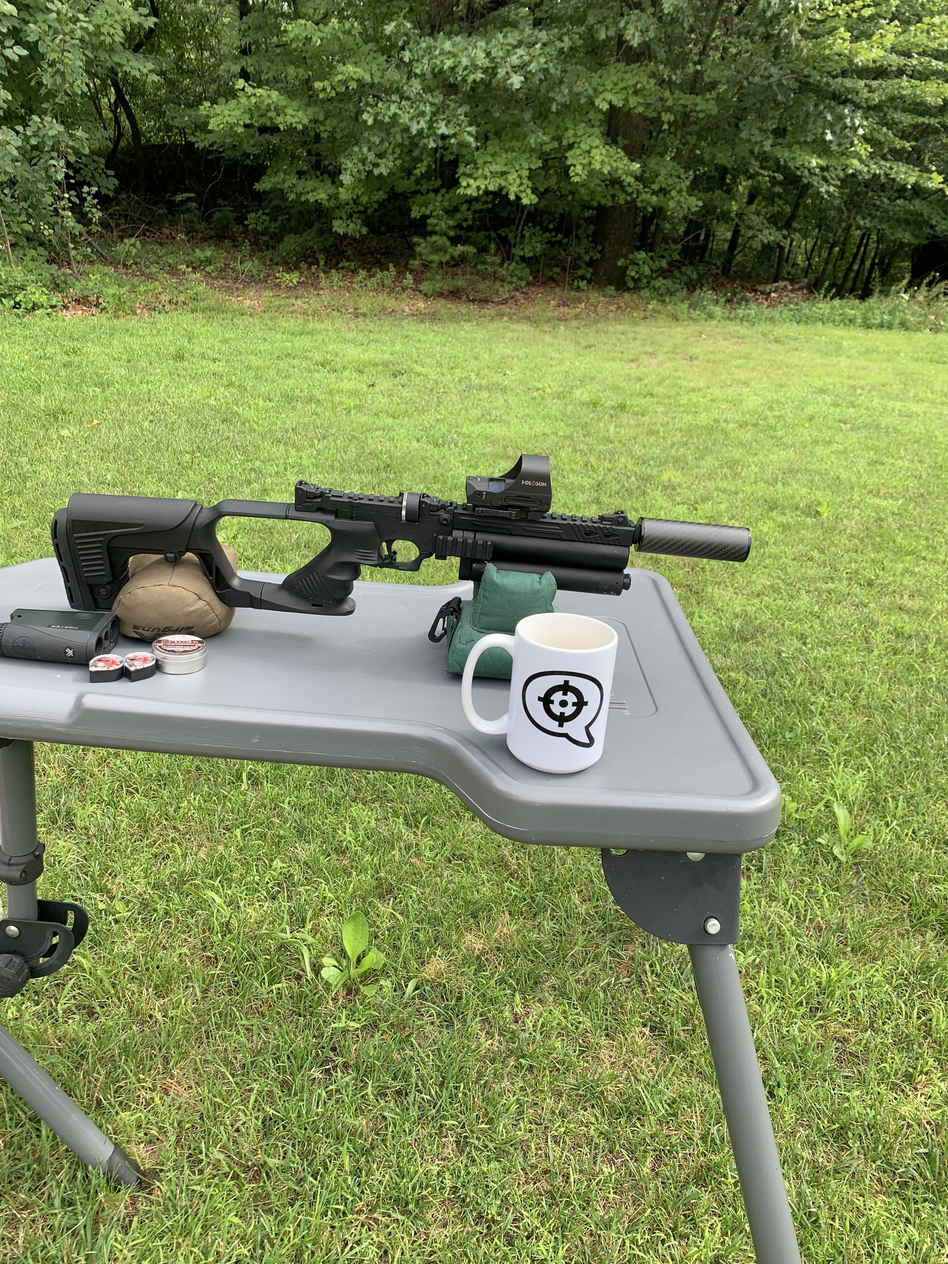

To start, my Jet is .177 caliber, so that is what I will be testing.
I believe 35 yards is the limit for this gun in it's original configuration, so let's see what kind of groups other Hatsan Jet owners are getting at 35 yards.
I found the "picatinny" rails are not to spec, so it was a challenge getting the red dot on, but it seems to be holding.
Below is my Jet II and the groups I shot at 35 yards today. It was cold so only 4 projectiles were tested.
View attachment 325800View attachment 325801
DONT THINK SLUGS ARE BEST OPTION TO ME 8.44 FX PELLETS I BET WAY BETTER OR LIGHTER 7GR JSB
