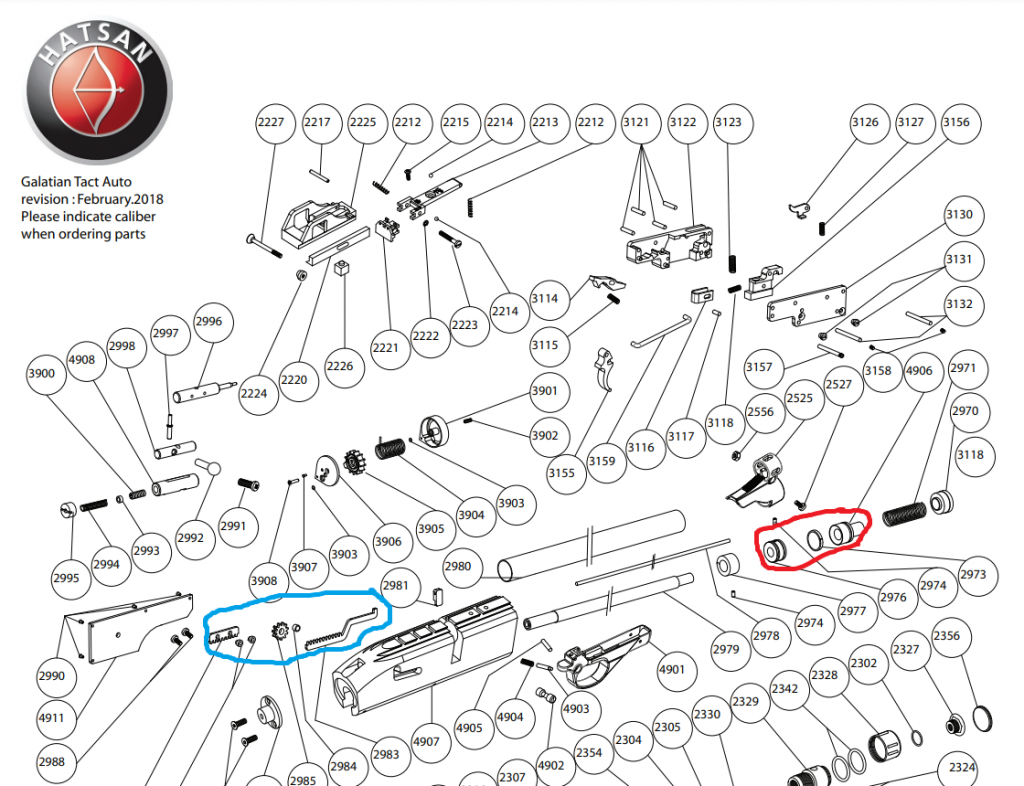

I'd polish the teeth on the parts in blue. Make sure their interface is smooth when the action cycles. You can take the shroud off and lay the gun on it's side with the access plate for the gears off and cycle the piston by hand to see how smoothly the gears operate. Or just cycle the bolt. Depending on the clock of the cog (you can take it off and install it at a different clock), it may run smoother or rougher... The ones in red... looks like yours has 2 pistons? I'd replace the orings on them. And use some silicone grease on them. Pake sure the bolt/probe is cycling smoothly as well
