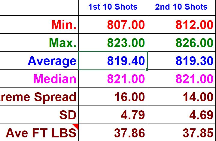

I put a Huma-Air regulator in my .25 cal Flash Pup. The device as far as I can tell works flawlessly. Right now I am tuned for FX 25.39gr pellets (I think these are pretty much the same as the FX 25.39s). My Reg is set at 140 and I have 2 and 1/4 turns out on my Hammer Spring. The stats I believe are great for an entry level gun as can be seen in the attached pic. I get about 25 consistent shots before the refill
