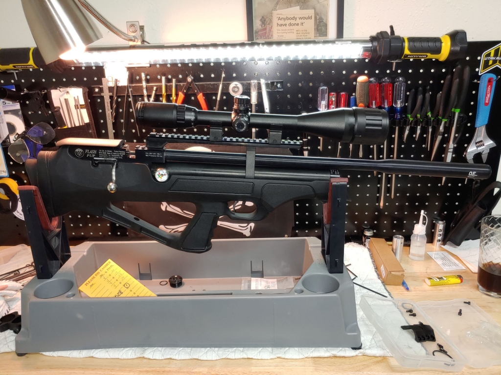

Hey everyone,
A couple days ago, my new hatsan flashpup in 25 Caliber arrived arrived, and it’s such a nice little gun. However, I’ve been having some pretty bad accuracy issues out of it so far. At 37 yards, I can’t even get 5 under an inch, and I’ve already wasted 500 pellets trying....
I’ve done just about it everything there is to do to solve this issue, such as cleaning the barrel, tightening everything, trying four different scopes, other pellets, etc. and I know for a fact it’s not me making it inaccurate....

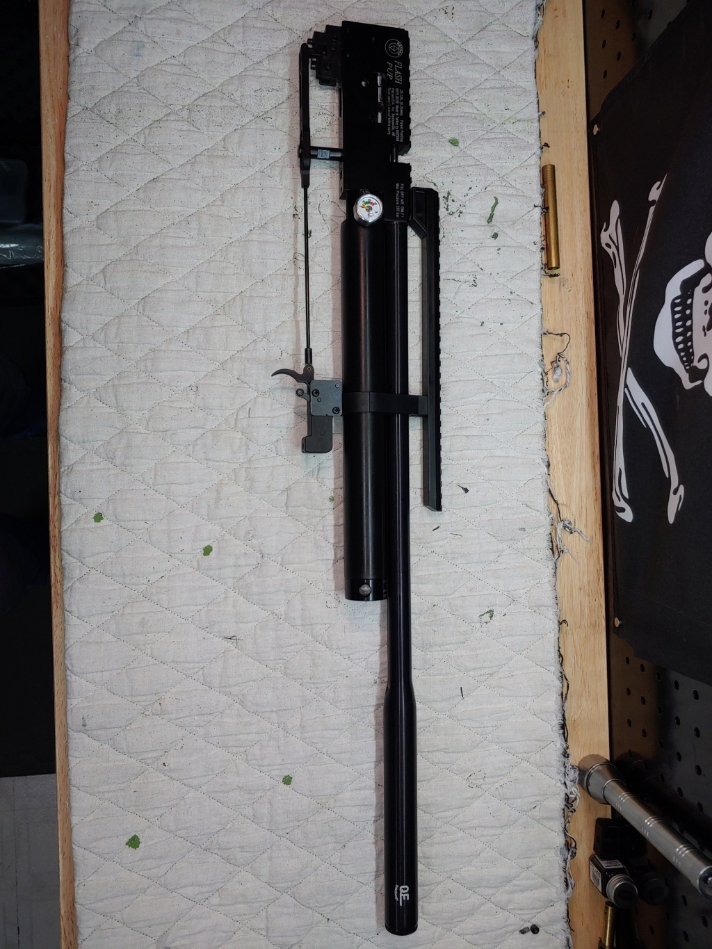

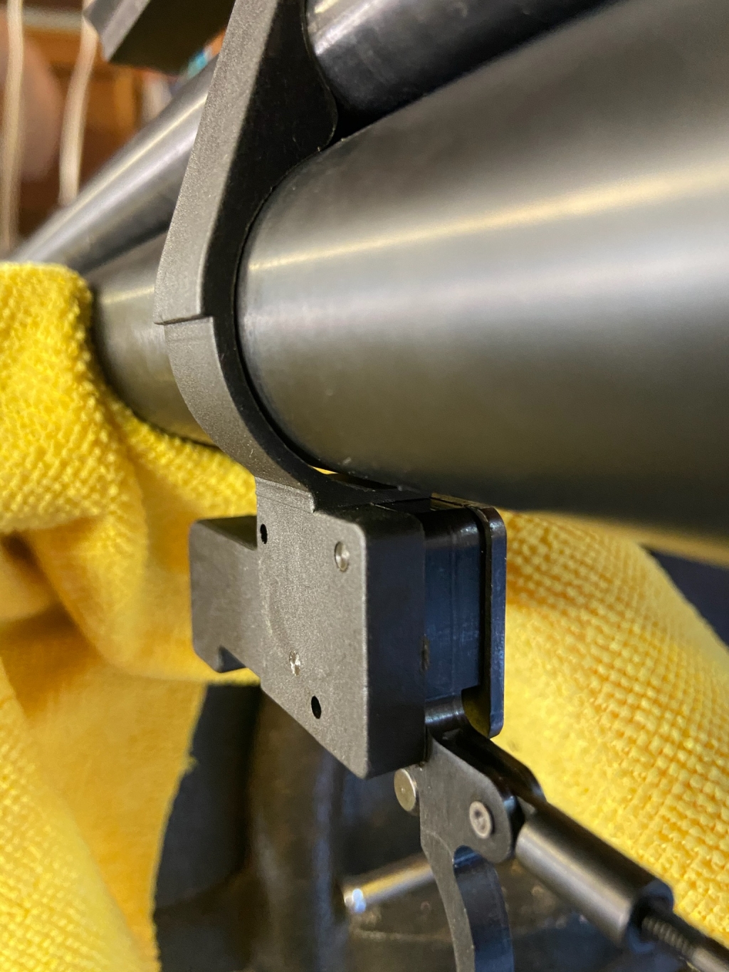

Today, when I was out testing the gun, I realized that the air cylinder clamp/bracket actually was moving when I pulled the trigger, up, down left right, in every direction. So for some context, this thing is looks like supposed to hold the trigger and the rail into onto the gun, so when I pull the trigger, the rail moves ever so slightly.
I took off the stock, and this clamp/bracket was not right in the bottom. I tried to tighten the rail screws, but they were already tight enough.
Do you guys think this is normal?
Any Flashpup owners care to send me a picture of what their gun looks like without the stock on, so I can see if there the clamp/bracket is supposed to have that much play?
If this is not supposed to be loose do you think I could just jerry rig it on? I’ve got some painter’s tape, and other resources, and I bet I could fix it.
thanks,
Sean
the gun

Well.... actually this is my FOURTH gun from pyramid air. I first bought a kral puncher breaker, and when it leaked, I got a replacement. Both krals were AMAZING! Sub MOA accuracy, like 0.3" at 40 yards! They were both nice.... until the REPLACEMENT leaked too. I wish I would have simply tried to fix the leak myself, they were such nice guns, so I got a Marauder, and when the marauder had accuracy issue AND it leaked, I bought this Hatsan Flashpup. I'd like to send it back, but unless I can get confirmation that the stock isn't supposed to move inside of the gun, and that the bracket thing is supposed to be loose, I can't send it back. I'd like to try to fix the issue myself, I really don't want to wait another month to get a new one.
