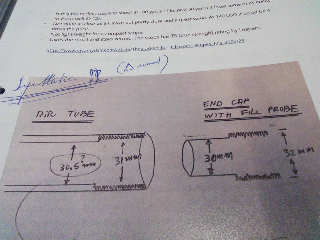

The picture below is for the S version, I sent that to Audrius because he is not a man of many words.The ID of the cylinder is 30.5mm -- that drives the diameter of your regulator.
The wood version is different. I believe it has an ID of 26.60mm, just like the most recent version of the Hatsan BT65. Again, that ID drives the diameter of your regulator. Better let the reg vendor know whether you have a wood flashpup or an S, and confirm the dimensions.
