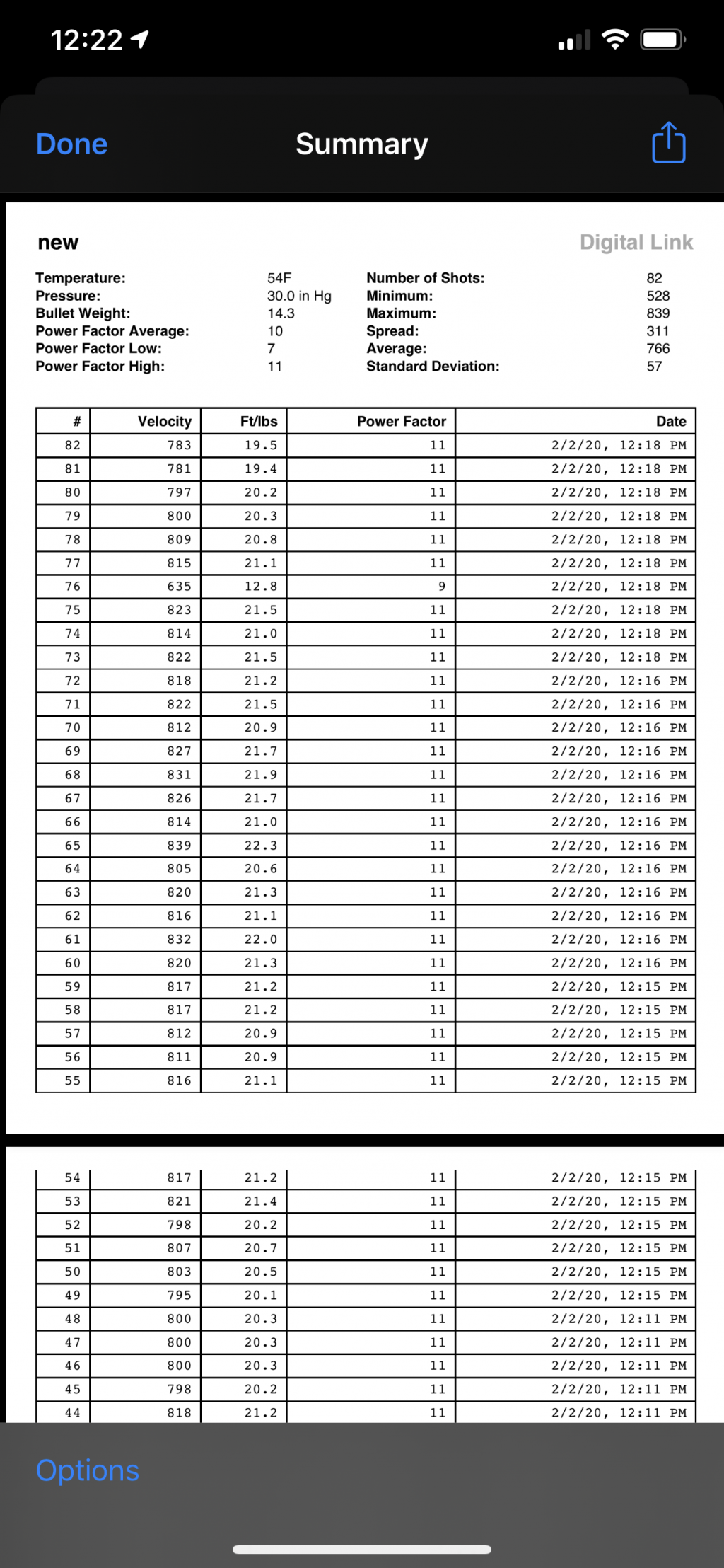

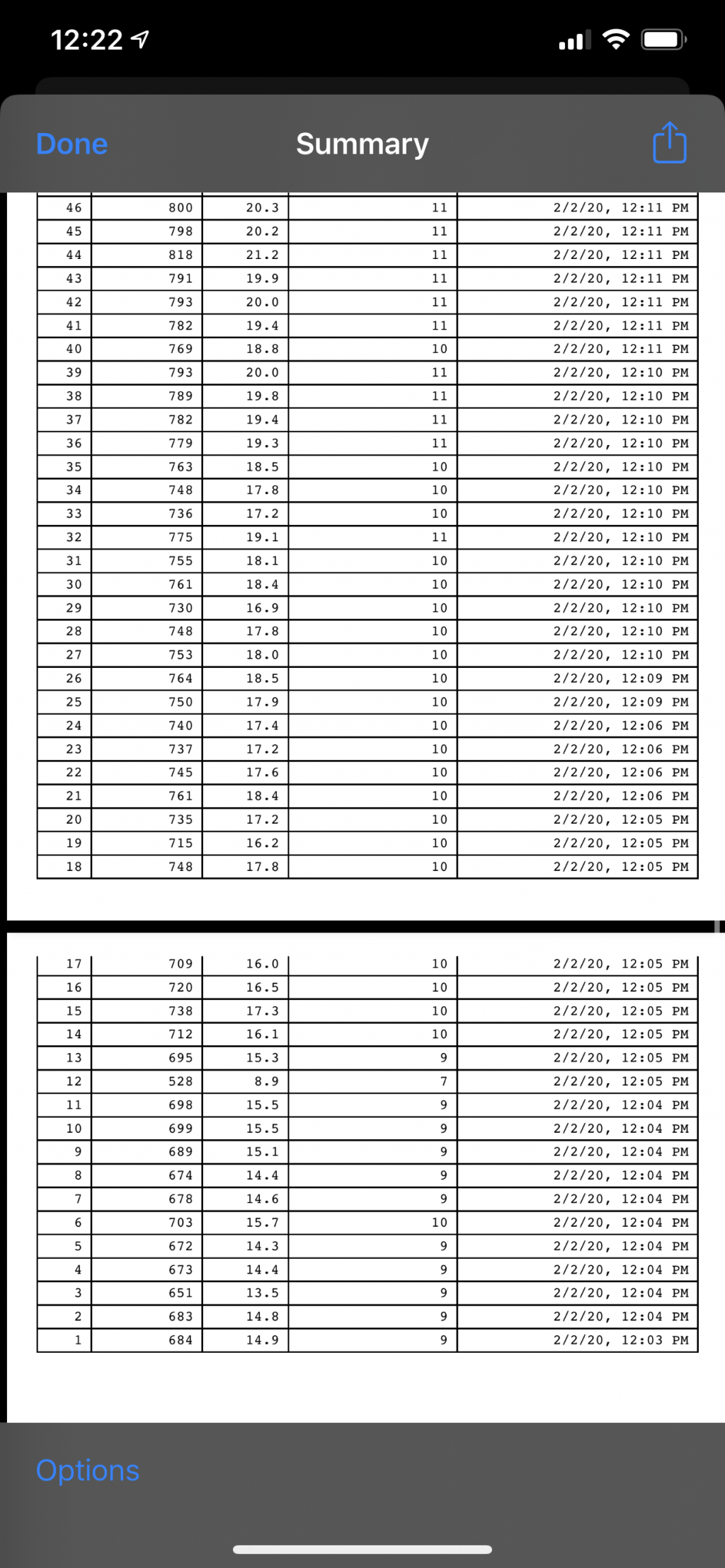

Interesting shot curve. The only balanced portion is shots 40 through 80 where the velocity rises gently to just over 800 ish and then back down to 780 ish. Looks like the first 20 shots or so have partial valve lock with pressure in reservoir too high for hammer spring setting. Have a look at the reservoir pressures for shots 40 through 80 and that's maybe a sweet spot where's your gun is really starting to breathe, but of course it's getting louder. It may be wasting air. Does the hatsan flash have any kind of transfer port adjustment? It might need to be throttled down a little bit with a bit more hammer spring tension to flatten your velocity curve out and get it quieter.

The nice spread of shots are from 167-136 bar or 2422 to 1972 psi. Based on the math it uses .8 psi per shot on average.

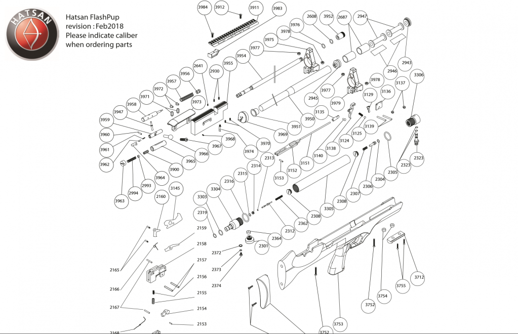

Also this is a part breakdown. If that adjustment is doable then i have yet to find a video or anyone doing it for sure. Like i said if its in the 700 mid 700 range then it is EXTREMELY quite. above 780 or so its loud.

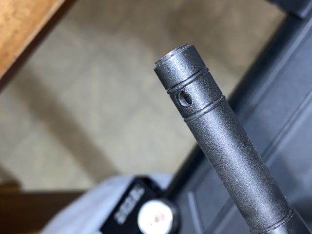

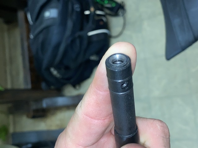

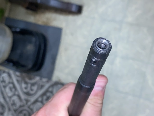

I have 2 Flash, one is quiet one loud. I swapped the barrel and shroud from the quiet one to the loud one and it was still loud. This proves the issue is in the action, not the barrel or baffles. I changed orings and made no difference. I bought new baffles, 50 bucks for a couple of hair curlers and felt, ridiculous, made no difference. If you find the fix PLEASE post what you found.
