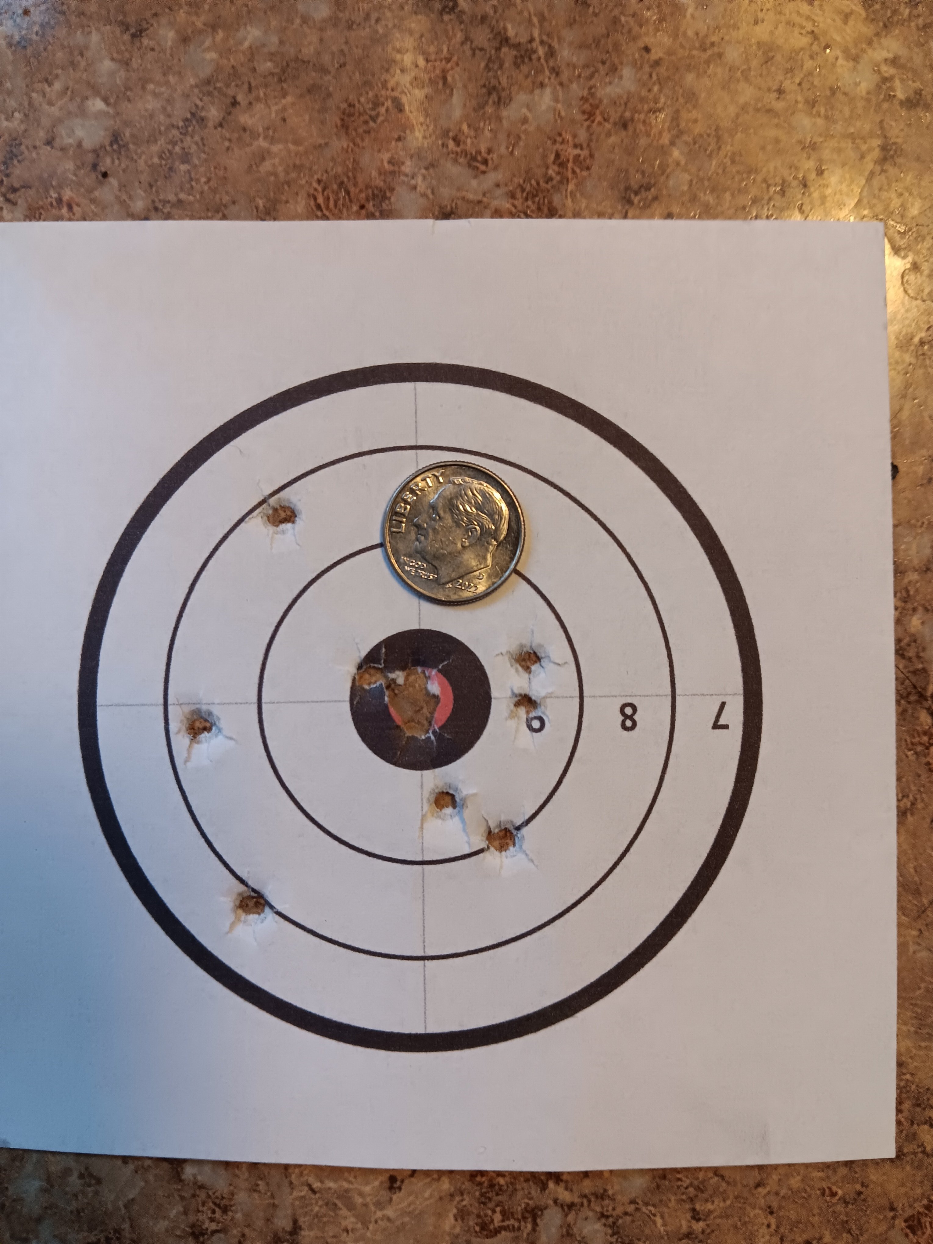

The trigger now breaks crisp and easily. Just like it has for thousands of shots. The stock feels like you are holding a woman's leg. It's shooting crosmans at 720 fps @4000 feet altitude. It will shoot a 3/4" hole at 25 yards with a flyer once in a while.
It's not fancy or expensive. Its a bit rough. And it won't shoot tiny dots. But it's a superb offhand gun that just won't quit even after shooting hundreds of shots a day, every day for a year.
