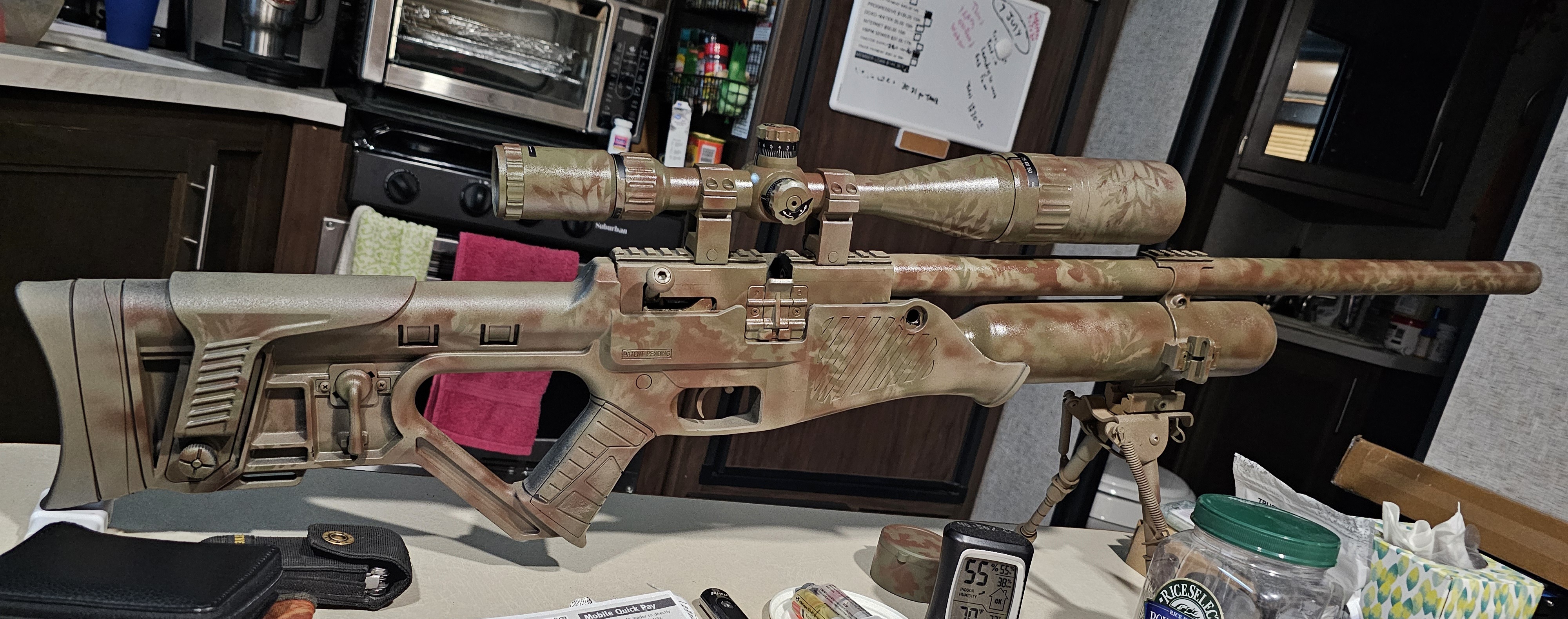

Tuning HATSAN factor sniper L .22cal
Nice! Looks heavy but that could help you out if most of you shooting is from a rested position... What Was the reg set at from factory?
So from factory the reg pressure was set to 150bar and the manner was on max . I tuned it down to about 100bar and hammer set to just more than half . Now she is shooting like a beast ! Accuracy is amazing . Only thing which needs to be improved on the gun is the trigger . It’s way too stiff . I adjusted it and was perfect . But I found that it started to fire without even pulling the trigger . It’s as if the trigger is slipping or something .
Don't have your trigger so lite it goes off with a bump or by itself. Screw some more tension back into it. Keep doing it until you can give it a good smack on the butt end and it stays safe. Then shoot it for a while , a few tins of pellets as the trigger will break in a bit and get a little better with some time. Only after that you can look into polishing up a bit. Most importantly stay safe!
