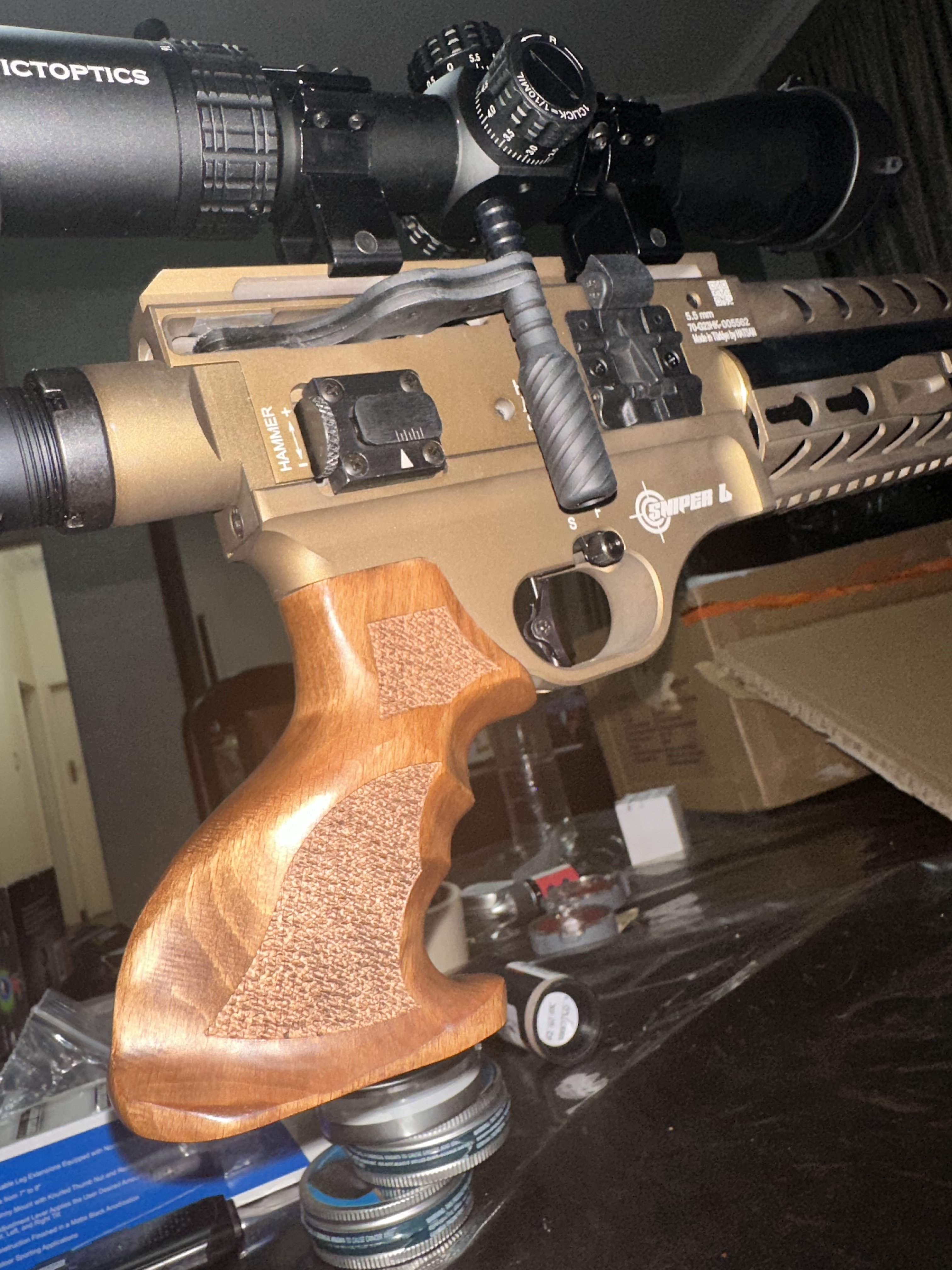

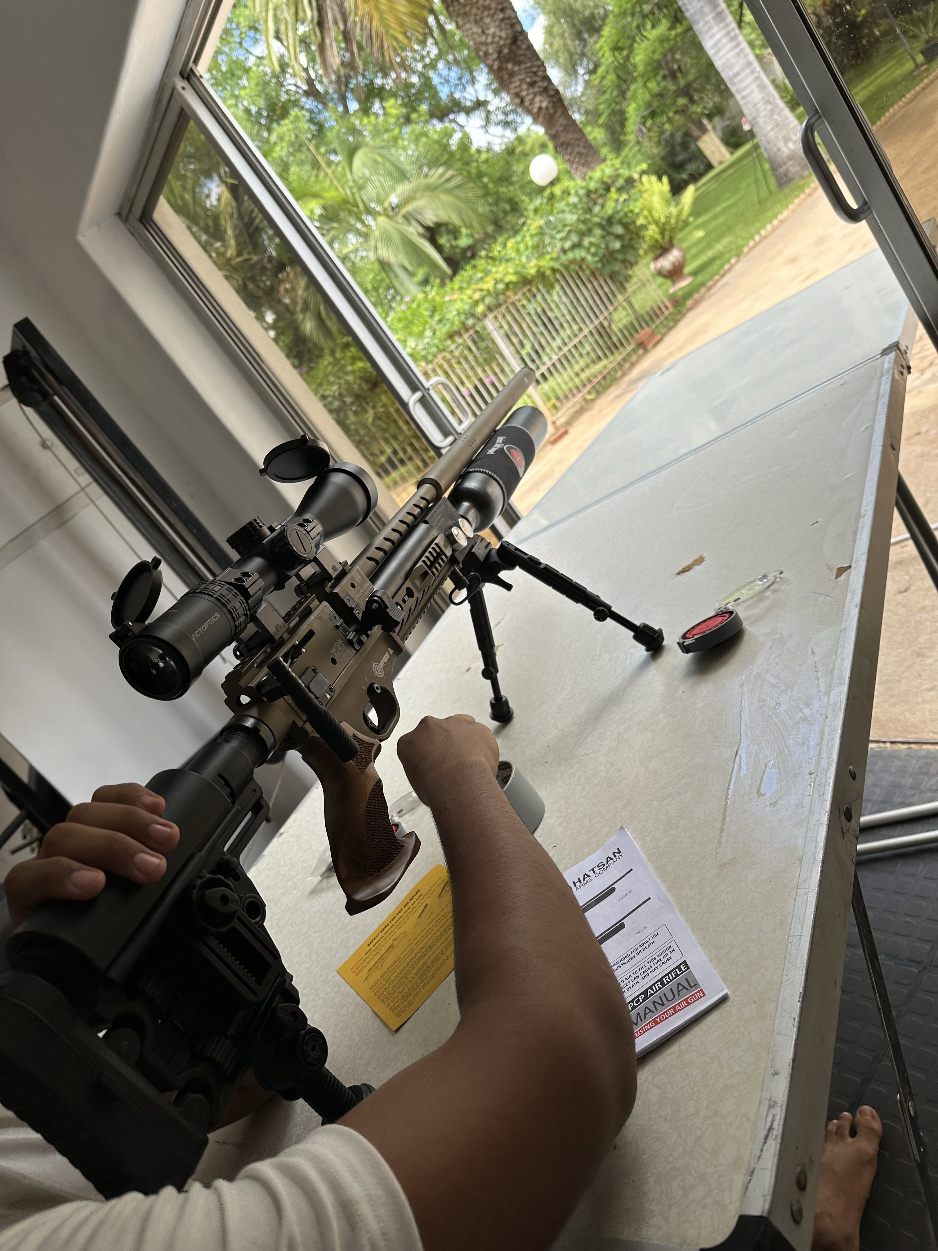

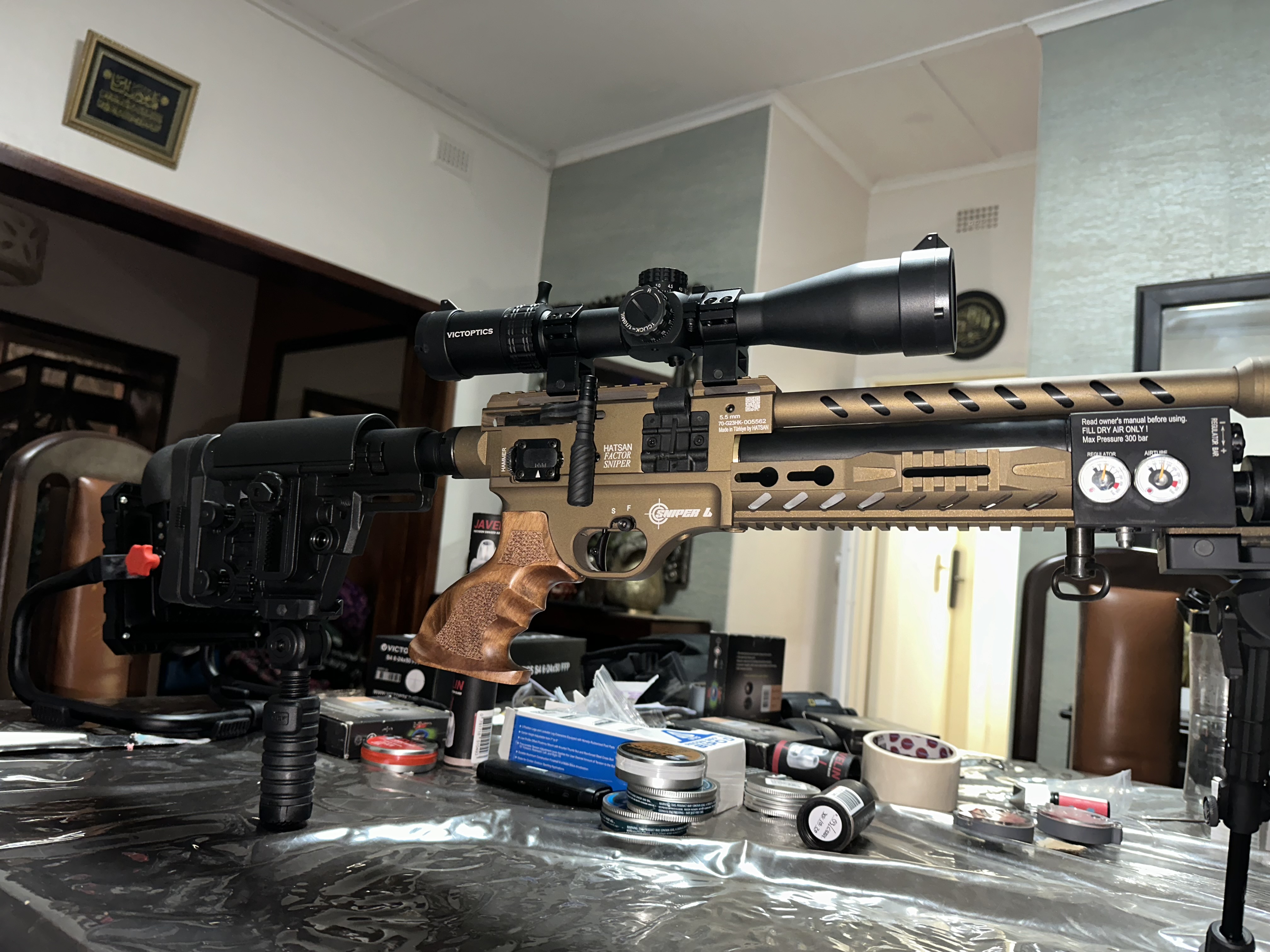

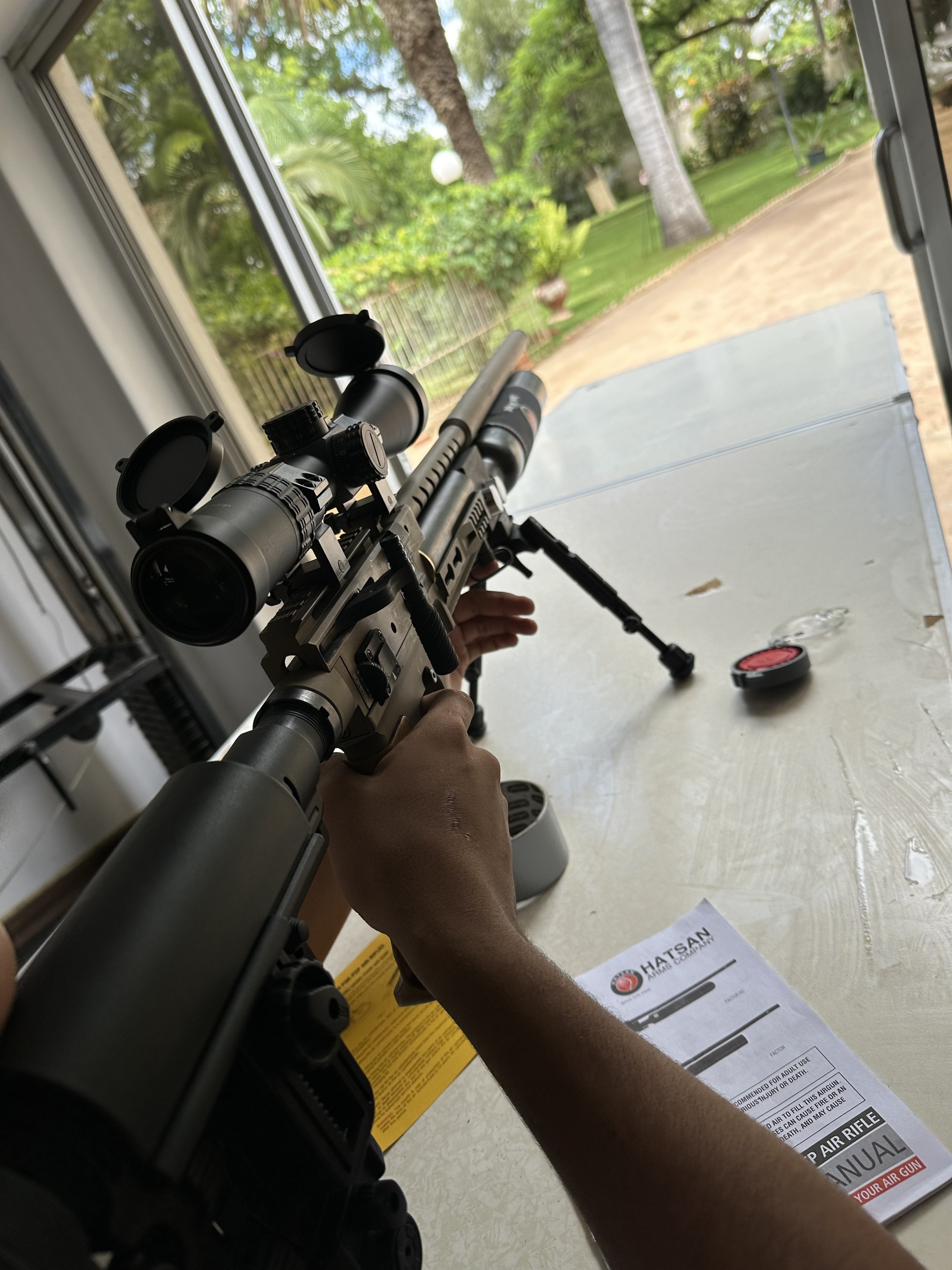

She has finally arrived . And I must say she is one sexy gun ! I tried her out. Rather louder than I thought . Maybe it’s just because of the manufacturers settings , it’s shooting all over the place . Noticed as the pressure in the tank dropped below the reg pressure it dropped with it . Once it got to about 100bar it was grouping a lot better ! A good ten shot 2inch grouping . Once it dropped below 95 it was all over again . Tried to drop the reg pressure setting to 100bar and tried it out but it’s not good enough. There are some good signs that it will perform a lot better once we can see what we doing with the chronograph .
