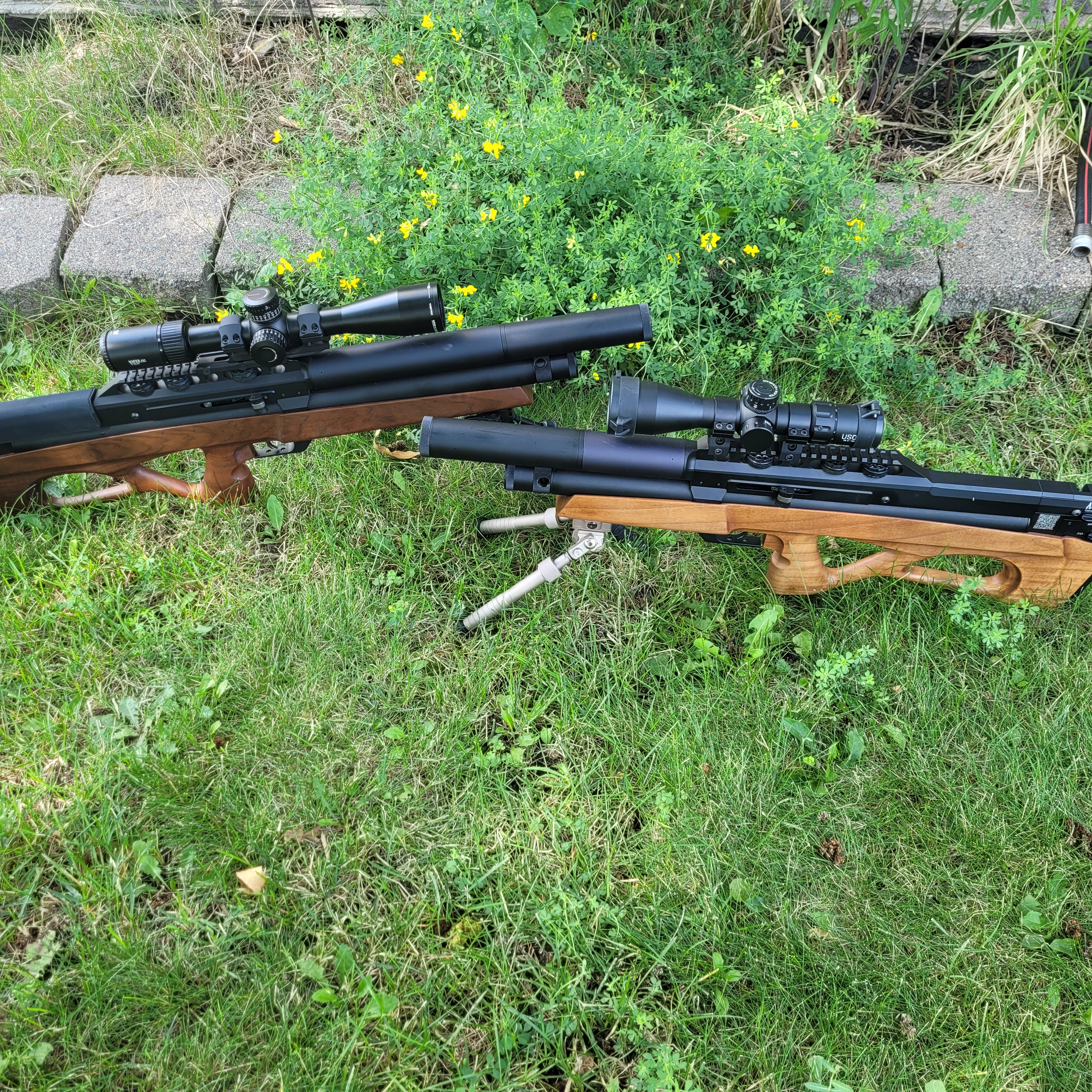

I have an R5 super long. Lately I’ve not shot it like I once did. The threats to the chickens have stoped showing up🤷🏻. It’s simple fairly quiet for the power. Easy to tinker with.
