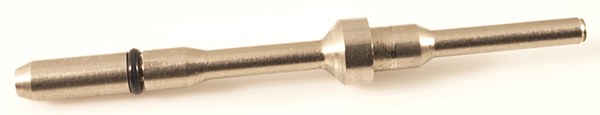

Hy all I need some help .Can someone give me the odds in mm for original Hatsan TA44 (Bullboss etc) valve pin pse.? Tnx in advance!
