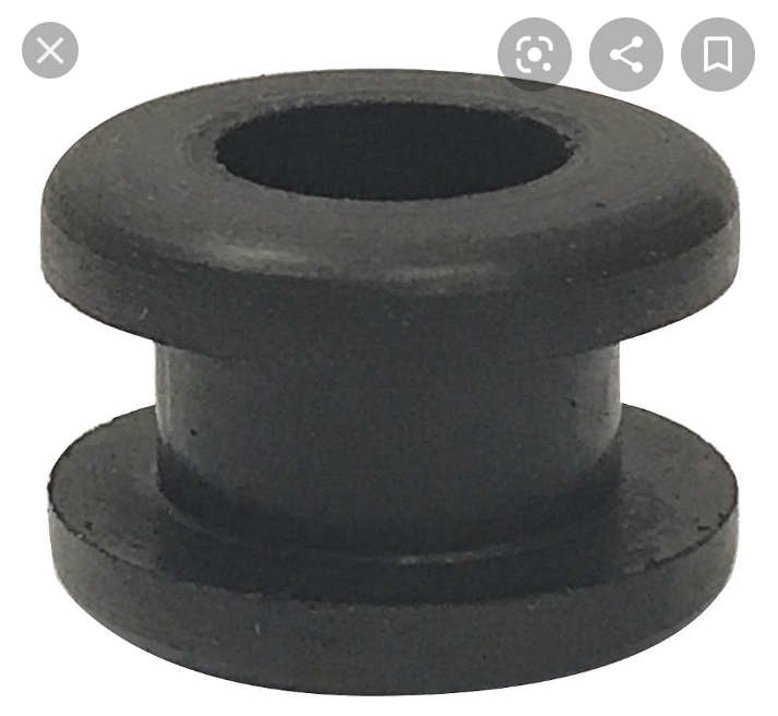

Find this Rubber grommet that's a tight fit at your local hardware or automotive store buy 2 if 1 isn't quiet enough return the other if it is. Rubber must be tight fit bring the unscrewed tube with you for fitment.
You can also use a 2"-3" tight fit rubber hose. Longer maybe up to 4" if not quiet enough up to you but more you stuff inside less shots you get taking up air space.
