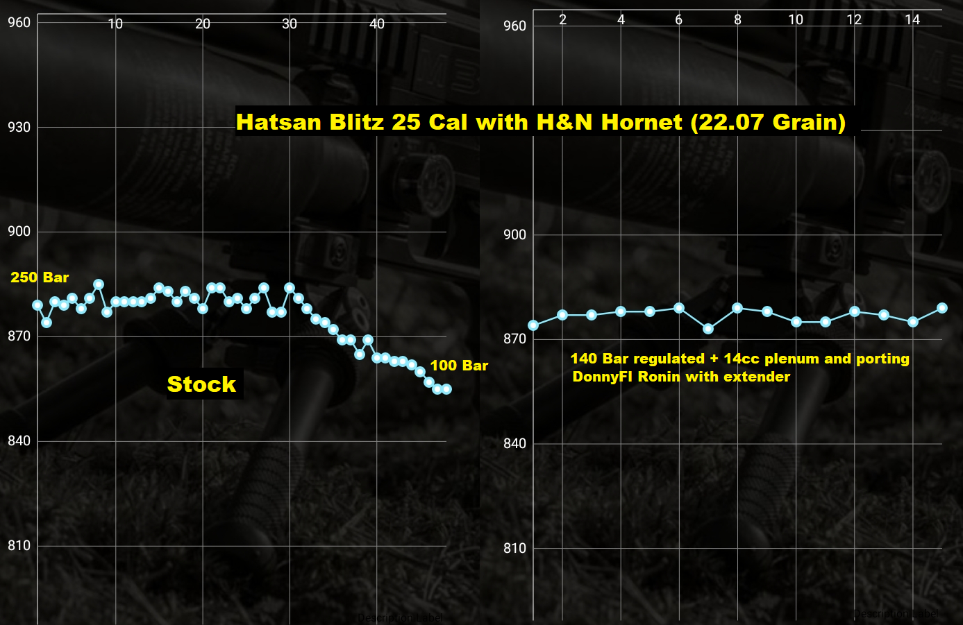

Here's the early testing of my modded Blitz 25.

I ran it set to 170 Bar and I ended up with poor accuracy and pellets in the Ronin but little extra speed. I then ported it and set the reg down to 140 and retested for this posting. It's been slow going as I had to take a break for heart surgery on Friday. I just got home but now I feel much better and I can continue working up the Blitz.

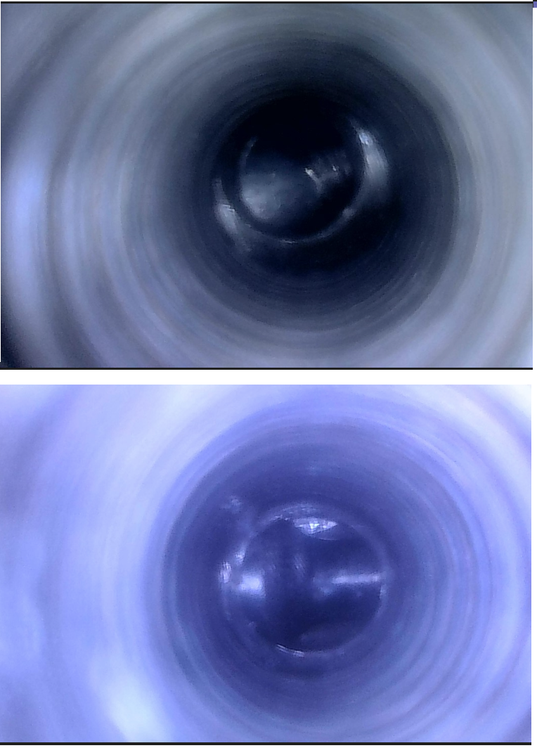

Here's before and after porting the barrel. The factory setscrew pads are mis-timed at 178.4 degrees above the barrel port which was only 67% of caliber in diameter to boot. It's now 80%. I may polish the probe tip. The base of the valve's exhaust port partially blocks this view so I took it out for the craptacular borescope image. The valve needs to seat in the action about 1.4mm deeper to clear this air passage properly. I will do a little profiling on the valve skirt to eliminate the obstruction. It just needs a little notch in it's base where it lines up with the passage.

, I was gonna ask you how do you port the blitz what do you do take off the barrel where do you get to the port I might want to open mine up a bit as well.
You can view the port/barrel connection through the hex screw plug that sits under the action and just forward of the screw hole for the stock securing screw. It's secured with thread locker/sealant. You will have to take the valve out to see all the way past it and up into the port. I use Loctite Blue on the hex plug when I reassemble. You have to remove the barrel and drill out the feed hole with a 13/64" or a 5mm drill bit. The barrel is held in place with 2 hex set screws from the top. The holes are the rear two of the three in the front rail. The barrel lines up with these screws with flats ground into the top of the barrel just forward of the port. On mine (see the previous pics I posted), those pads were not ground perfectly above the port. They were about 2-3 degrees off which makes the barrel twist out of alignment with the port when you tighten the set screws. I used a brand new cobalt drill bit with a bit of side pressure to both make the port the right size for the caliber but to also move it over a tad so the setscrew pads are now 180 degrees above the port.

So far, the alignment and porting added 60 fps to my H&N Hornets even though I went from 250 Bar to 140 regulated. I think with the valve skirt cleared a bit from the port I can get another 30 fps. I'm not sure I want to do that yet as 875 FPS for the Hornets is right where transonic buffeting starts to be a problem. With the FX Slugs I can go to 1025 fps without the buffeting IF I can get the needed 60FPE out of the gun, which I think IS in it.

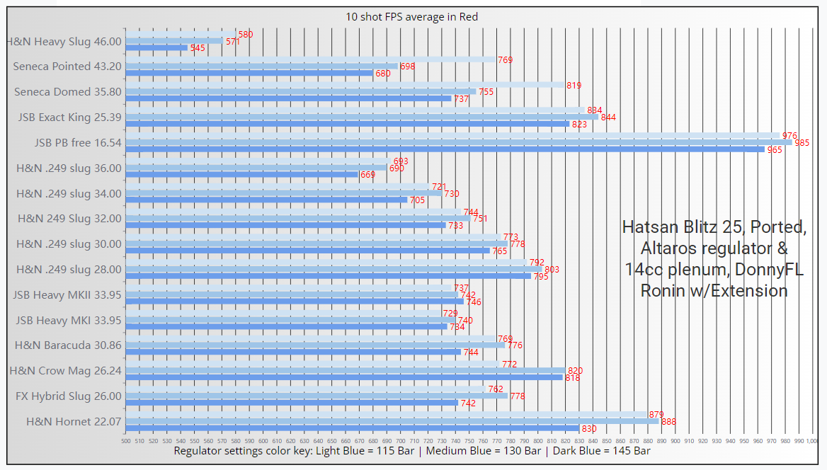

Tuning results:
16 different models of ammunition, including 5 different weights of the H&N .249 Cal slugs, the FX Hybrids, JSB's, H&N's and Seneca pellets. Every round was shot ten times each at three regulator settings. My Blitz is the late model 25 Cal version. I ported the transfer port in the barrel from stock 67% to 80%, added an Altaros regulator with a 14cc plenum and a DonnyFl Ronin Moderator with the 6.25" extension. The hammer has not been adjusted.
Measurements were made with the FX Pocket Chronograph V2.
