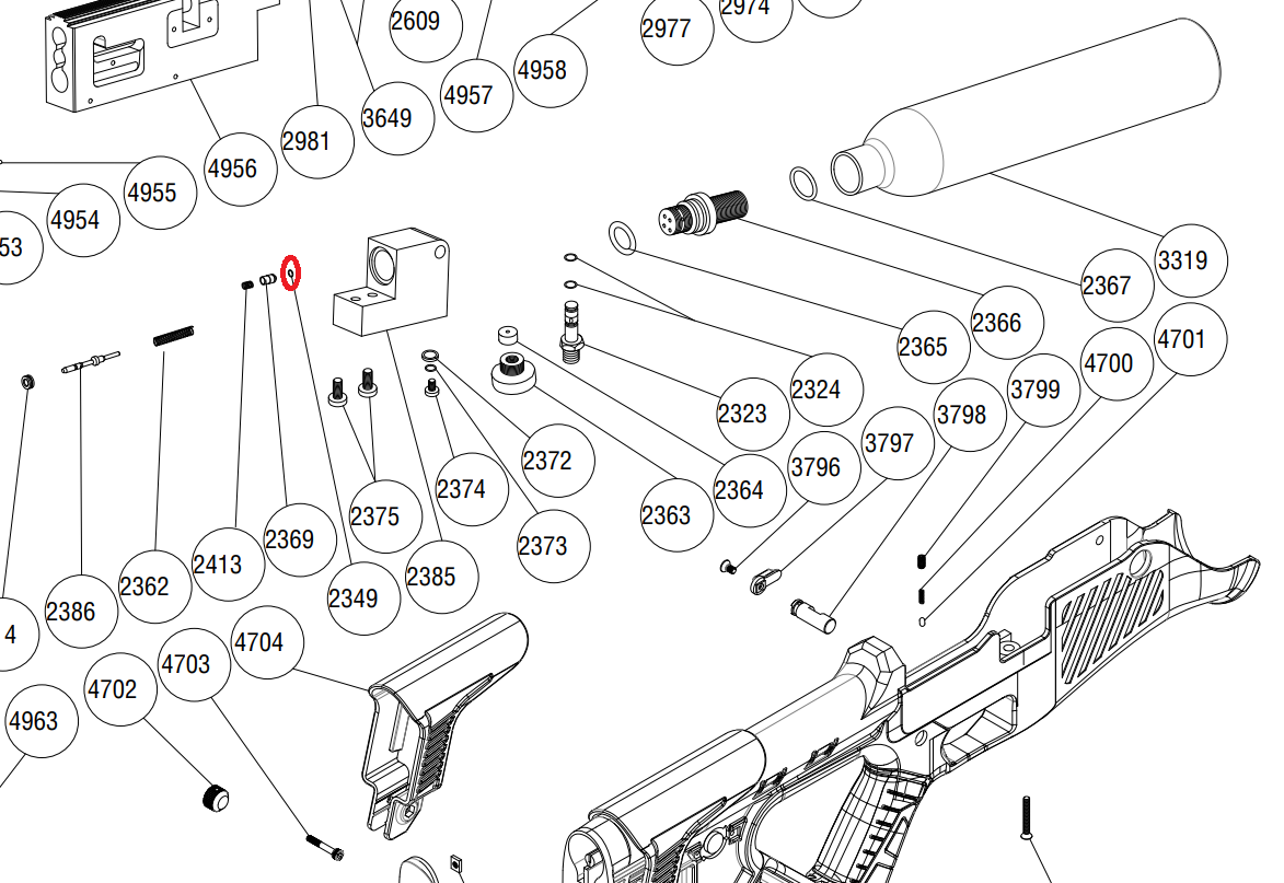

If that is the case, that would be very odd due to most valve designs... Generally it would be more likely to not seal with less pressure rather than more. Not saying it isn't possible.... If there is an oring involved, then for sure more likely. I'll take a look at the diagram of the parts.... Ok, so, I did, and unfortunately, I can't ascertain which part is responsible for sealing the gun once it's filled.
Did manage to find this video, so giving it a look now.
So, after giving that a look, I'm about 99% sure part #2349 is an (or, rather, THE) oring that is responsible for sealing the gun after it is filled. May need to replace it and possibly debur and or polish it's seat somehow. Ideally this type of seal or valve would be acetyl (delrin) or something comparable. But I'm willing to bet my neutron star fill valve is going to be almost identical to this. But I havn't ever had to service it.
