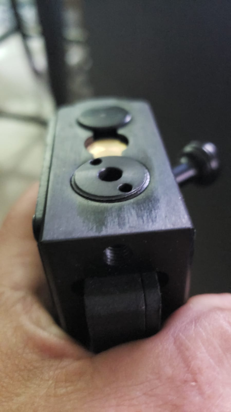

About the back screw being to far out, I do not think it is.... I'm attaching a picture.
"RE-COCK" meaning this is a SEMI AUTO and the sear is designed to re-set / re-cock itself with each trigger pull.
If that is happening ? and able to Blap blap blap shots one after another then the system is recocking / resetting it self.
The issue sounds like the cocking mechanics ARE NOT going far enough rearward to allow the magazine to index / rotate so fresh pellet rotates into position for loading on the bolt closing cycle.
