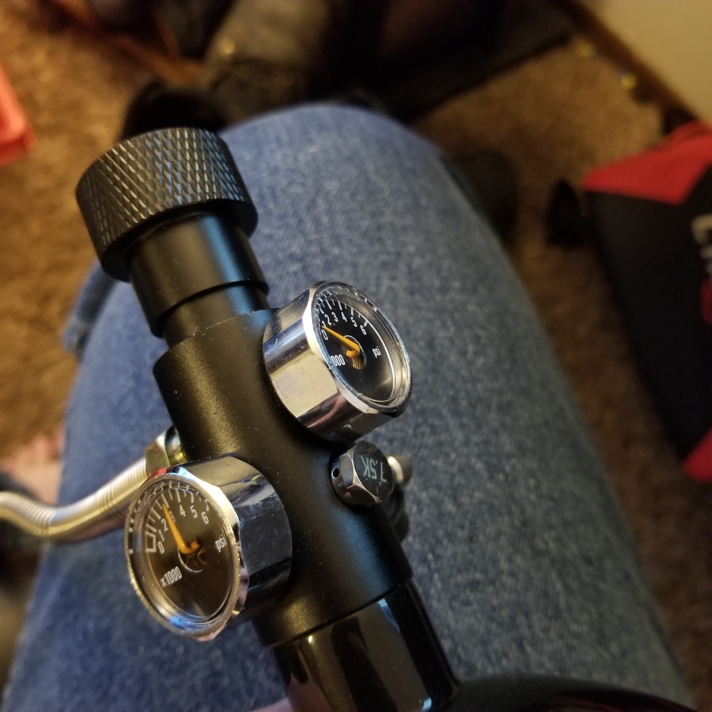

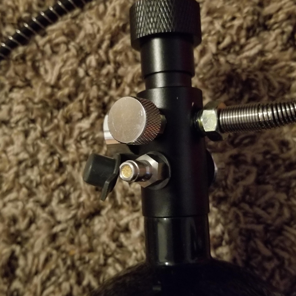

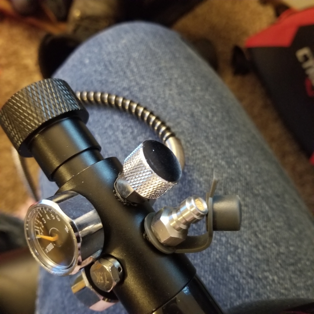

I bought a new hatsan carbon fiber bottle and had a few questions. First in the manual it say tighten the valve into the bottle to no more then55ft lbs. The valve has nowhere to put a wrench so I assume hand tighten. 2nd to fill the bottle it has a male end to attach a foster fitting. With that do I have to open any valves to let air in or does it have a check valve that let's in air on its it's own.

Very interesting valve, it looks like Hatsan's version of the Ninja EZ valve. If indeed that is the case that male foster fitting is a check valve and you can fill the bottle directly without opening the valve. I own the Ninja EZ valve/90 cu-in bottle and the valve/setup look nearly identical minus the style of pressure gauge.
I like this style of fill system because you don't have to fill through the valve you can fill directly into the bottle. It also eliminates the need to do a pressure equalization mating dance between the compressor and the receiving bottle.
Reactions: Rasberryrl

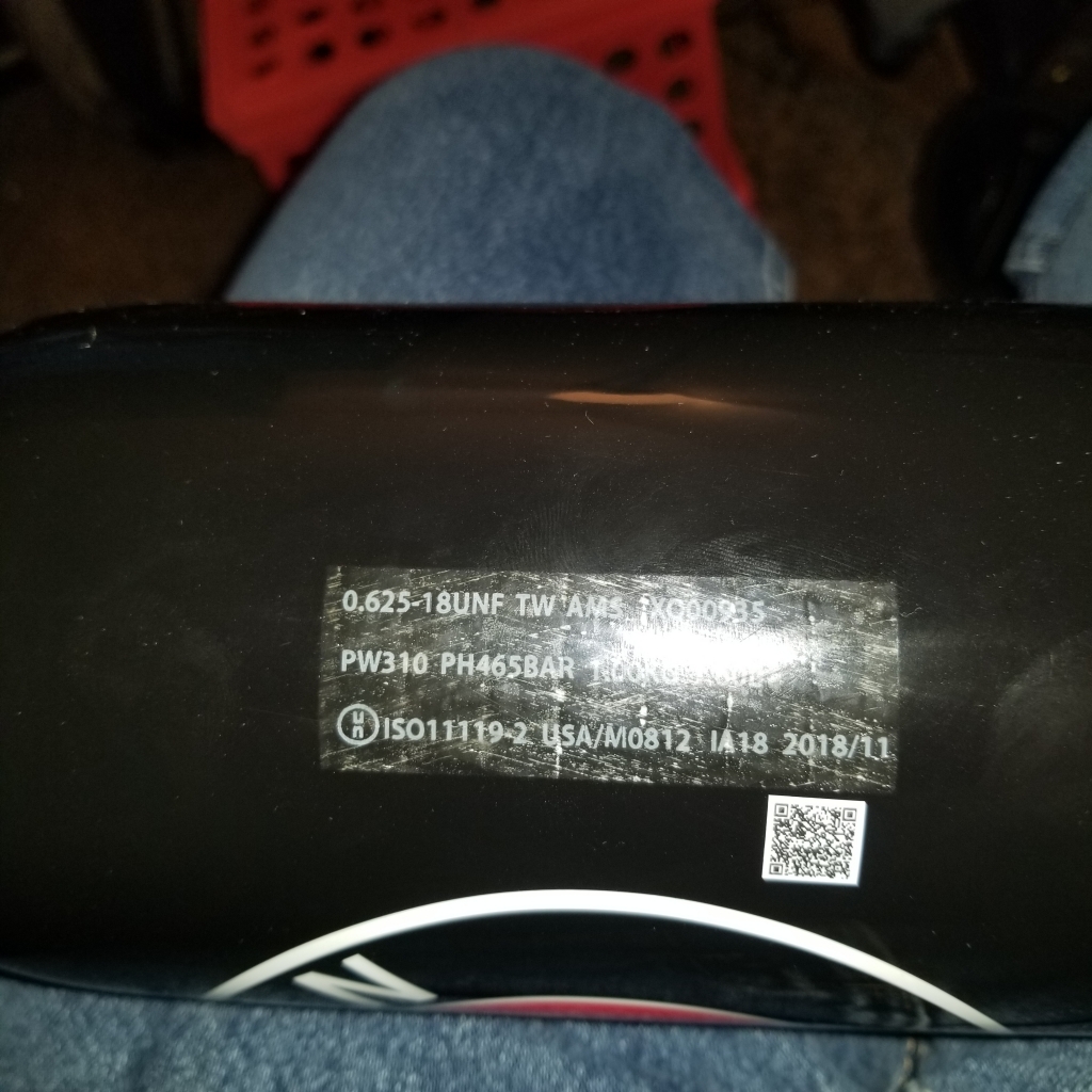

Can you post a photo of the label on the tank? Specifically what I am interested in is if it has a DOT certification number.

I have figured it out to fill you just pug on the male foster and fill no fuss on that I will try to get a pic up of the DOT cert later.
Good stuff, looks like Hatsan's version of the Ninja EZ Valve which is a cakewalk. From a price aspect I'm a bit surprised:

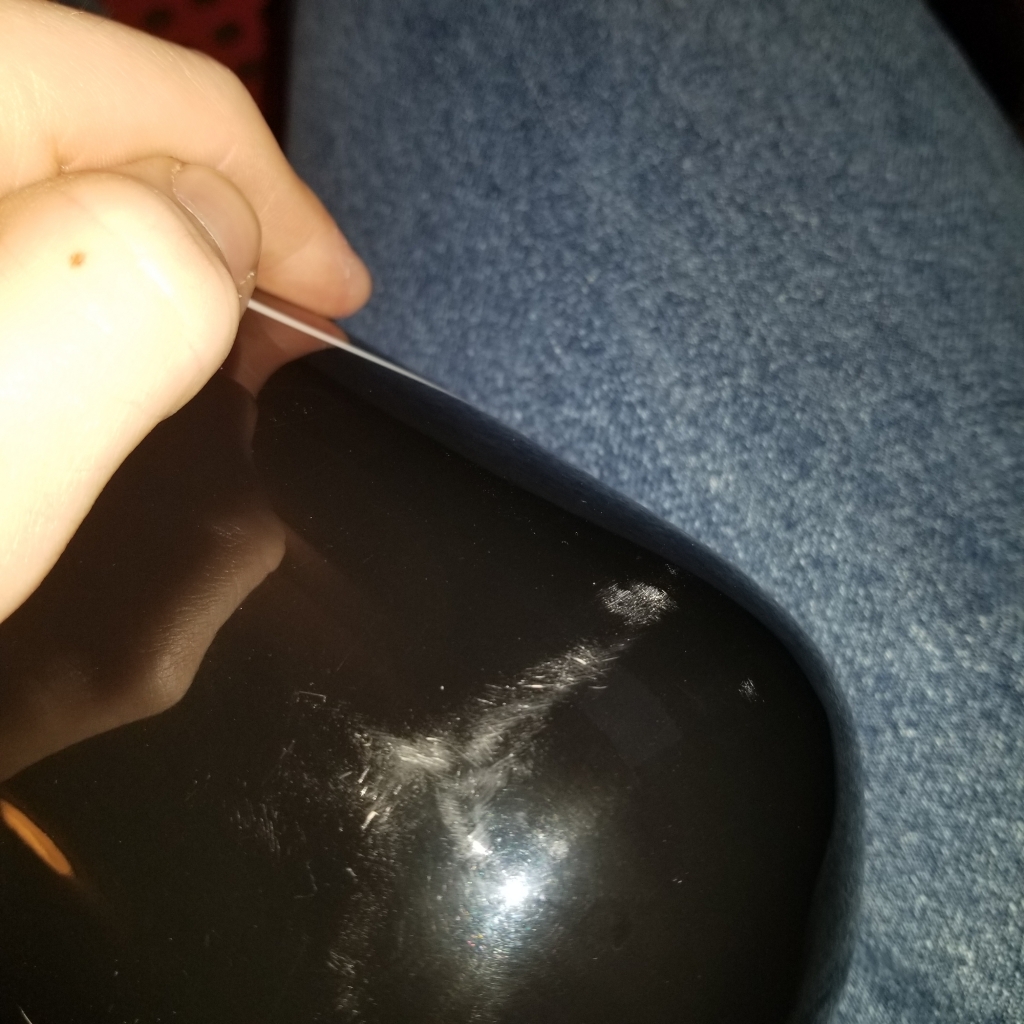

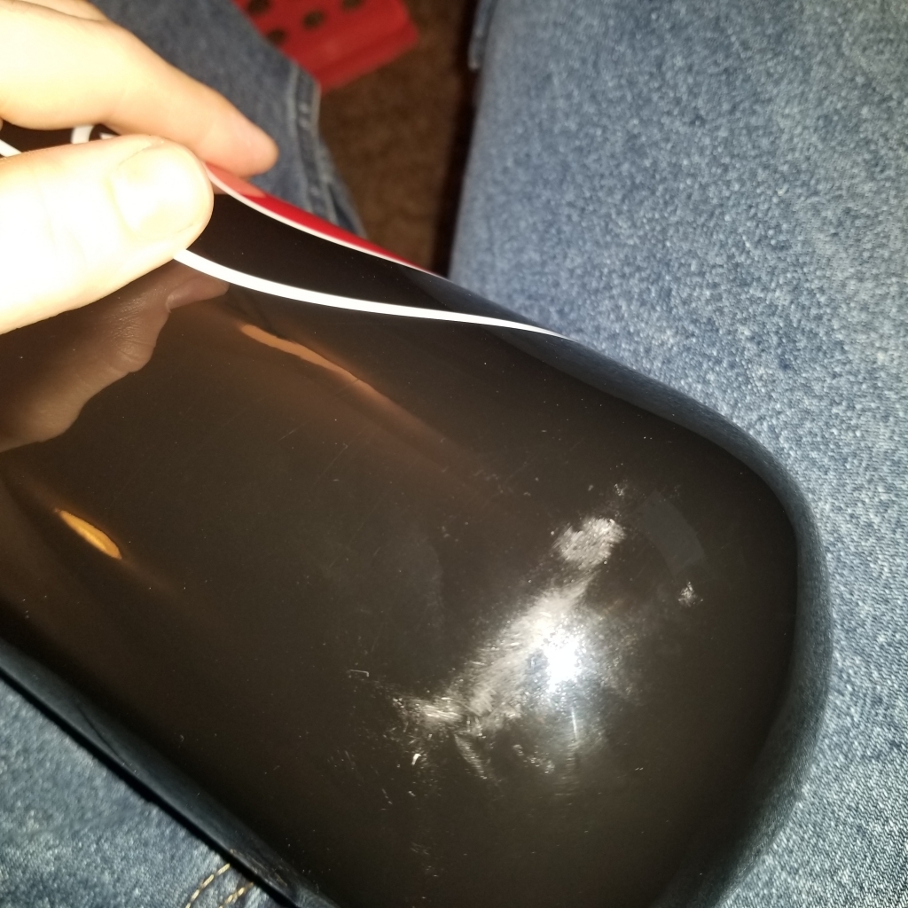

Oh nice, thank you for that link, that's a good price point. Is the paint just Hatsan's version of painting over an epoxied resin CF bottle or is it the actual protective coat giving up? With regard to the bleed valve what is the bleed process? With the Ninja EZ Valve you have a rest position (valve off), turn it to slow fill, and then when you return it to the rest position it self bleeds. Sounds like it's a two-process system with the Hatsan? Open the black top valve to fill (is it slow fill?), close the valve, and bleed the line with the chrome side valve?
Sorry for the tons of questions I am legitimately considering this purchase so I'm trying to lean on your tactile and first hand experience. The manual evidently is wrong since it's talking about opening the valve to fill so I don't have a lot to lean on.
Thanks for your time and thanks for the link! GUess if the paint is scratching off we can find out true DOT, CE, and bottle manufacturer, lol.

EDIT : So, I went to fill my Hatsan tank today and I'm not sure what to do. When I opened the valve, the whip went crazy like a car wash air filled buddy, so I closed it and saw nothing happen. I'm not sure how to fill my 1.6l bottle from my Yong Heng safely and correctly.
