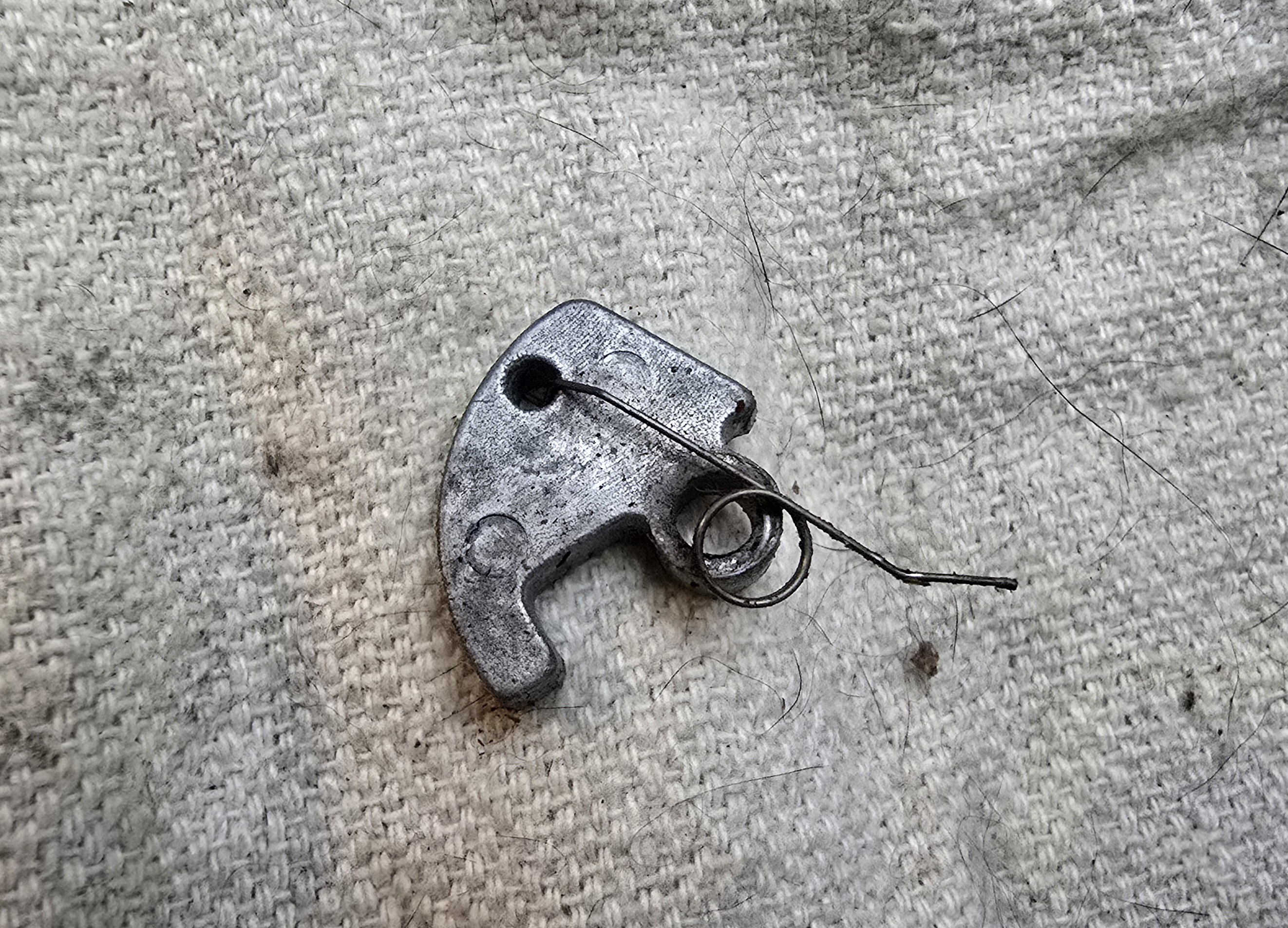

Bought a Hatsan 95 a couple months ago. Went to shoot it earlier today and found this part coming out of the trigger assy. Not 100% sure on the name of the part. I believe it's #109 on the part diagram. What is the best route on resolving this? I prefer not to exchange the entire rifle as it seems to be accurate (I've read about bad barrels,etc) Thanks

Kinda discouraging it broke. Only shot 100ish rounds through it. When I got this i tried adjusting the trigger and didn't seem to respond to adjustments, likely due to it being broken?
The funny thing is it still appears to work without the broken piece, I suspect the other portion of the part will dislodge itself and wont work eventually.
you know i have stared at that for too damn long not to realize that it is the point where the spring connects
i would just drill the sear and mount it back up but
i would look for a light sear spring steel spring is just cutting through poor quality cast metal and then they remove half the material so the spring will hook beyond stupid
i looked for M2 threaded eyebolt to repair what you have but come up empty
a small stainless ring might work for a while, i would have to look for something that made a light bulb go off in my head

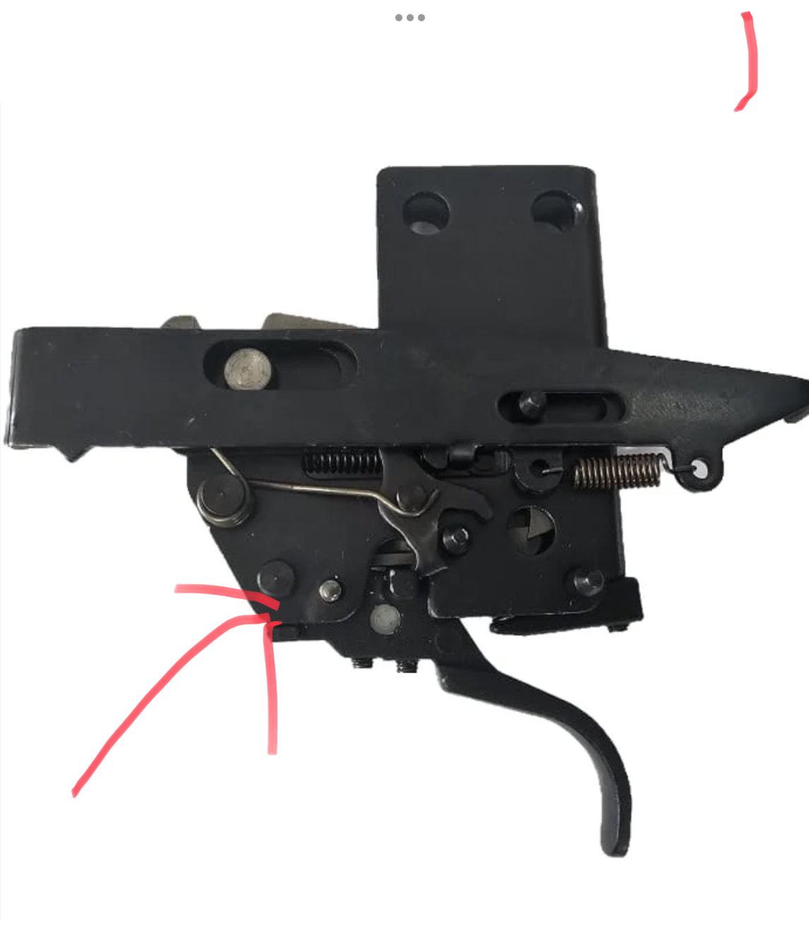

That’s a original Quatro. The pin is 5 mm iirc. It’s the same diameter as the broken piece you have. You need it to be C clipped in or you makea inner metal bushing that fits the smaller pin you have.
it’s a great trigger that can be really predictable with a few mods. Both screws can be replaced for longer ones to adjust finner.
will it ever be a REKORD. ,no but close with no creep. 1 lb break like glass.
Reactions: Brian T
View attachment 580654That’s a original Quatro. The pin is 5 mm iirc. It’s the same diameter as the broken piece you have. You need it to be C clipped in or you makea inner metal bushing that fits the smaller pin you have.
Excellent description. I can make a bushing for the existing pin when i get into this.
Im new to the inner workings of triggers, etc. Your info is helpful and much appreciated.

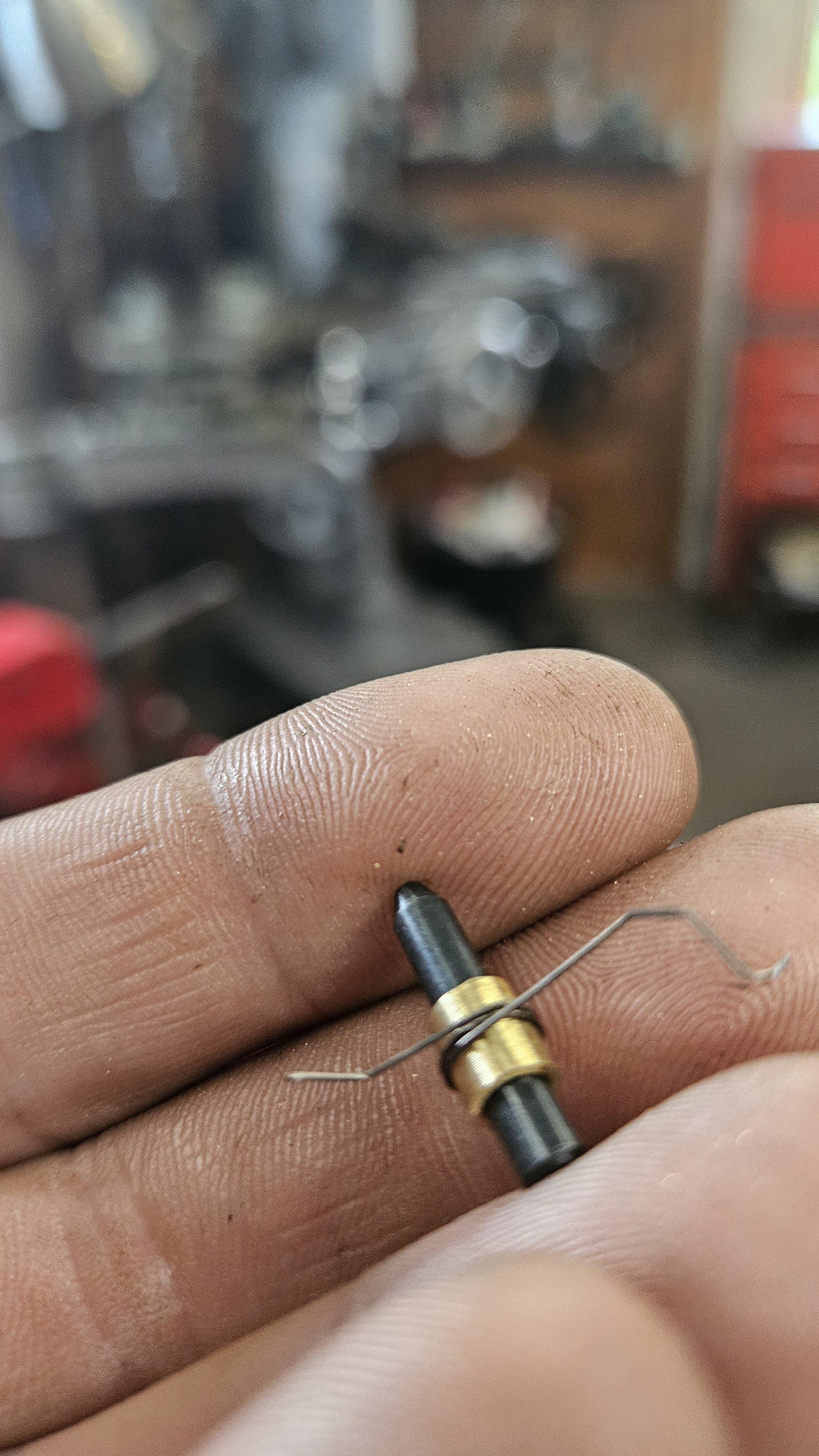

I made a bushing. The 5mm dimension seems correct. I made this in brass quick, is this what im trying to achieve? I believe I will omit that spring?

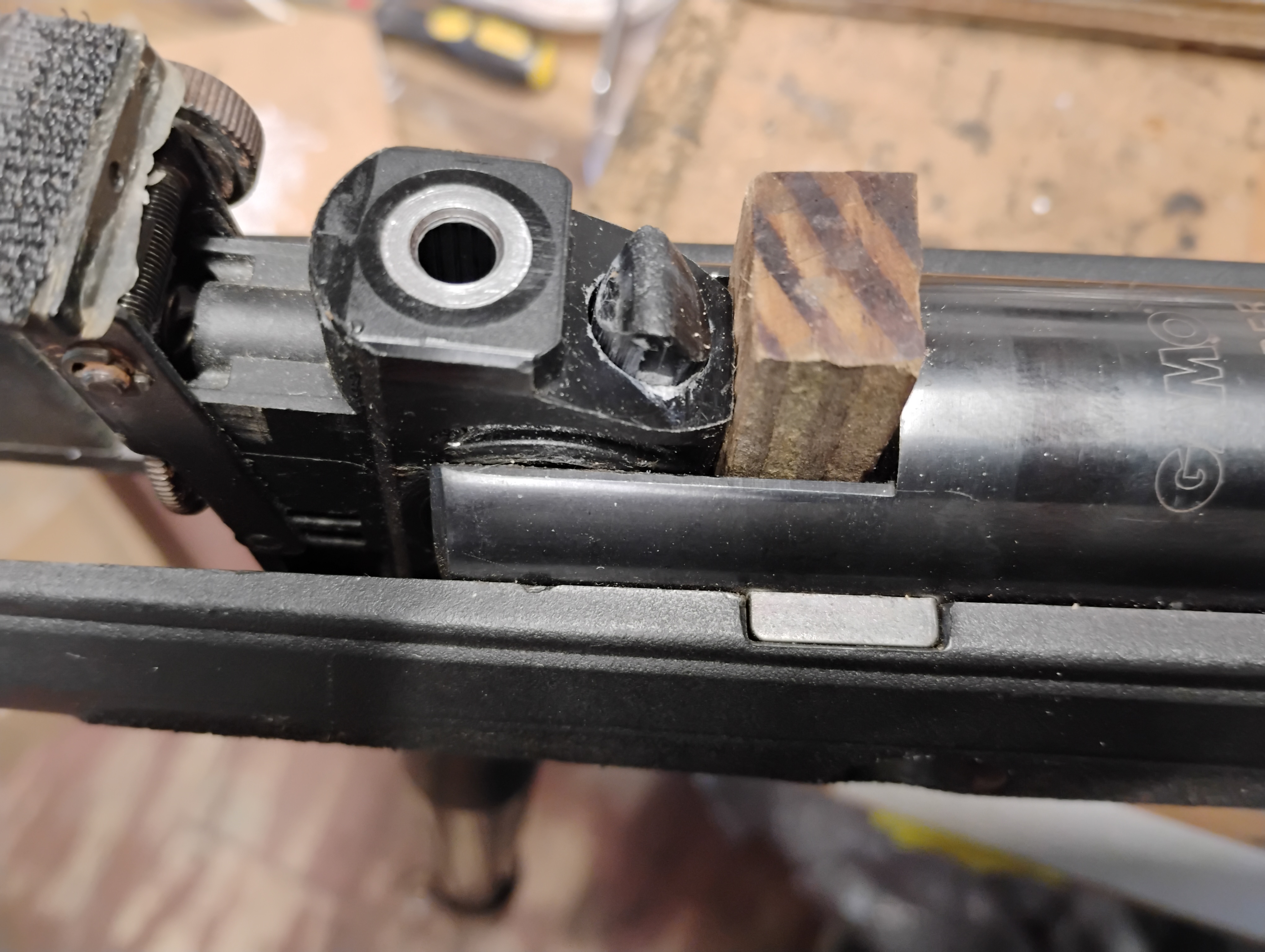

Bob was who contacted me for my trigger part. He kindly sent me a HW97 hand made breach block to hold it open uncocked for cleaning.
I homemade a block to keep a break barrel fron "accidentally" decocking when cleaning or whatever
Bob's timing was perfect as I had just got the idea to do one my self. The only problem is Bob's breach block is a work of art and a shame to get it full of cleaning fluids. 😆
