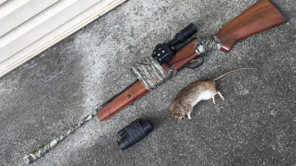

I’ve had mine for about 4 months. My biggest complaint is the trigger is too heavy. I have adjusted it down a bit. Mine also shot the Crosman pellets pretty good. But best average i could get was 1 1/8” shooting at 22 yards. I’ve now switched to H&N field target and when all goes well I can get an inch group at that distance. Id suggest sorting your pellets by weight. I believe it helps prevent that occasional flyer. It is very “hold sensitive “ mine needs to have the buttstock pulled tight into my shoulder. The cocking will get a little easier. And you yourself will lean the best way to hold the gun to get the best leverage. It’s a fun gun to shoot. I hope you enjoy yours.here is my early econo. Night vision set up. And also the reason I got the gun 🐀
