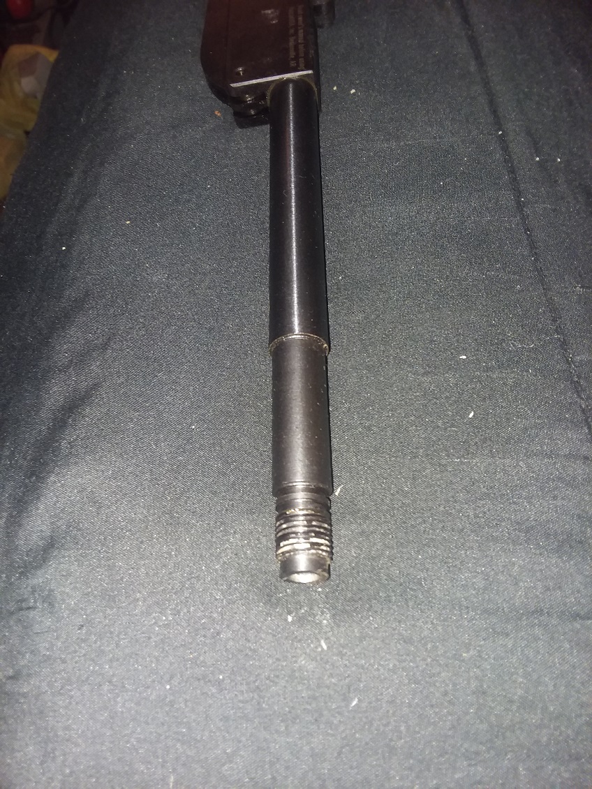

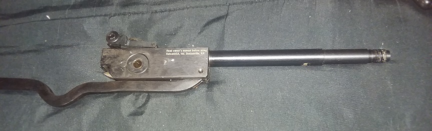

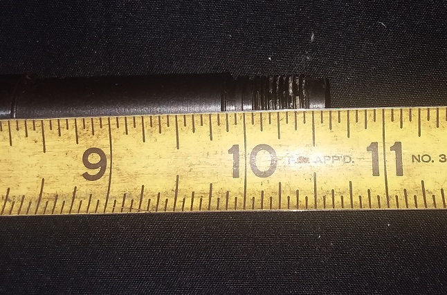

There's nothing in there, the shroud just slides on. No gear cuts on the barrel like there were on the older moderated versions and those were there to help hold that moderator on. The barrel was actually milled with steps in it and about 7 3/4's inside the shroud when you look in there is the lip that shroud nut presses on when it's in place. The shroud will turn and even more so once you loosen that nut inside which is the only thing holding it. There is no glue or filler in there. Just be very aware Hatsan used their usual cheap pot metal making them those shroud nuts so be careful when removing it. The barrel itself from breech to muzzle only measured 10 5/8's inches, even took a pic of that.
The crown in mine while not bad wasn't that great either and no, the barrel wasn't cleaned yet. No sense in it considering what I was about to do...lol.
Had to dig a bit to find the file but here's the pics of my .22 QE I took during it all:

It is fairly easy. Barrel was already off the rifle, heat gun on low and straight into the shroud. Used a screwdriver through the barrel pivot hole for leverage on the far end, ratchet/socket on the nut and while still a bit tight, it came off. There was some kind of thread lock mess on mine, may or may not be on yours. Used Vibra-Tite VC-3 when I put it back together. As mentioned while you have it open, check all those baffle pieces to see if there was any kind of clipping since it's been known to happen.
Also need to check the side of the shroud on re-install and make sure the QE part faces to the side like it's supposed to. Don't ask how I know...lol.
