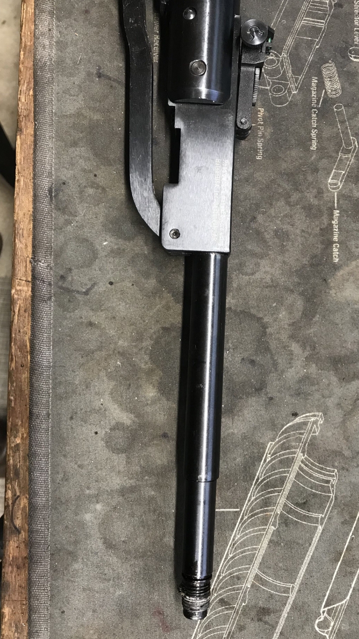

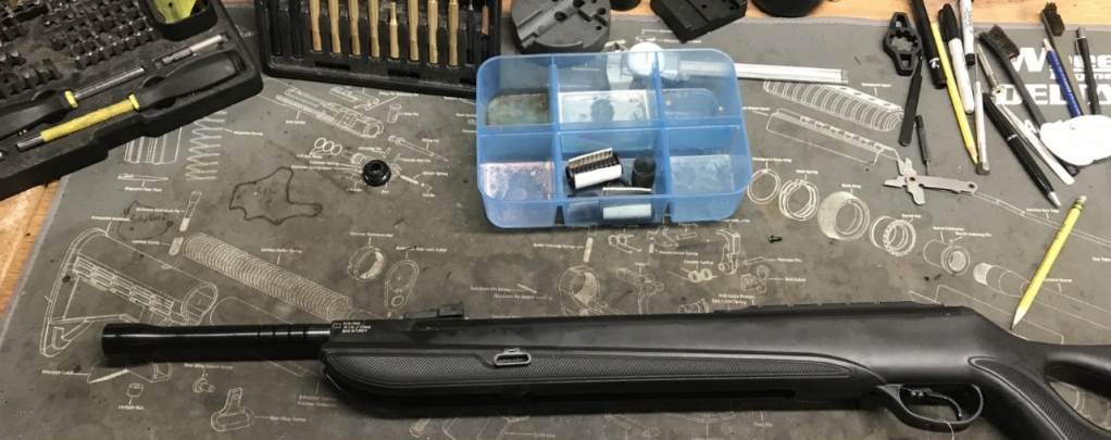

Do you know what these are? I am modifying a air rifle that will be using them. It will be done in a few weeks. Then I can share it with you all. The gun is done.

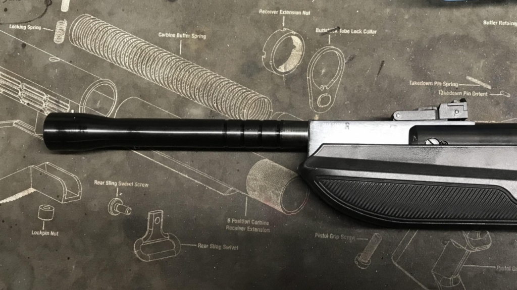

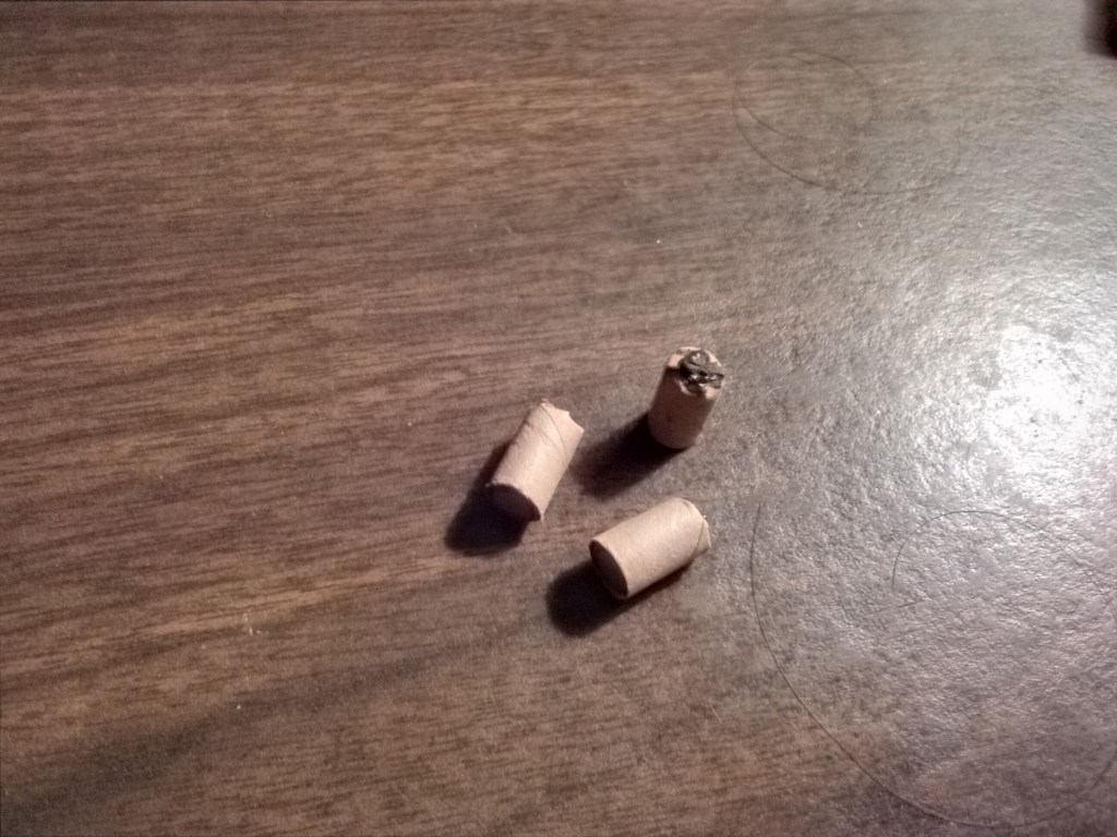

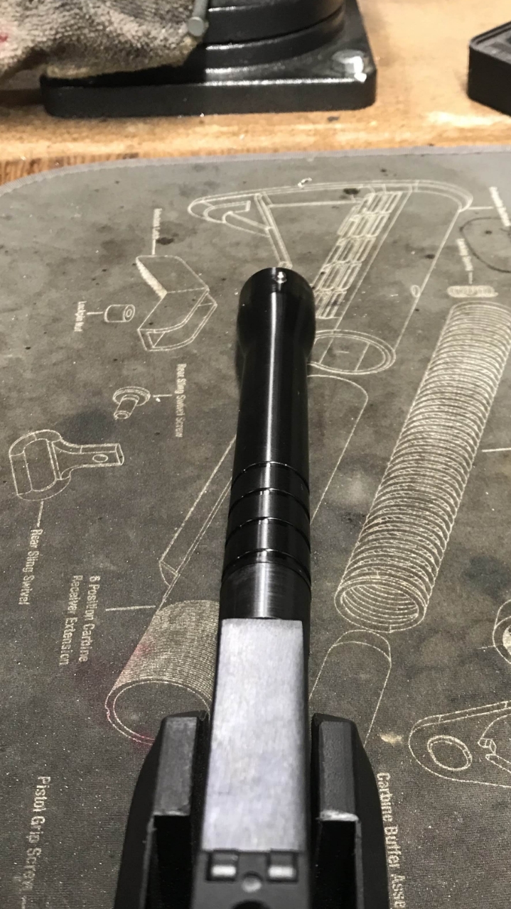

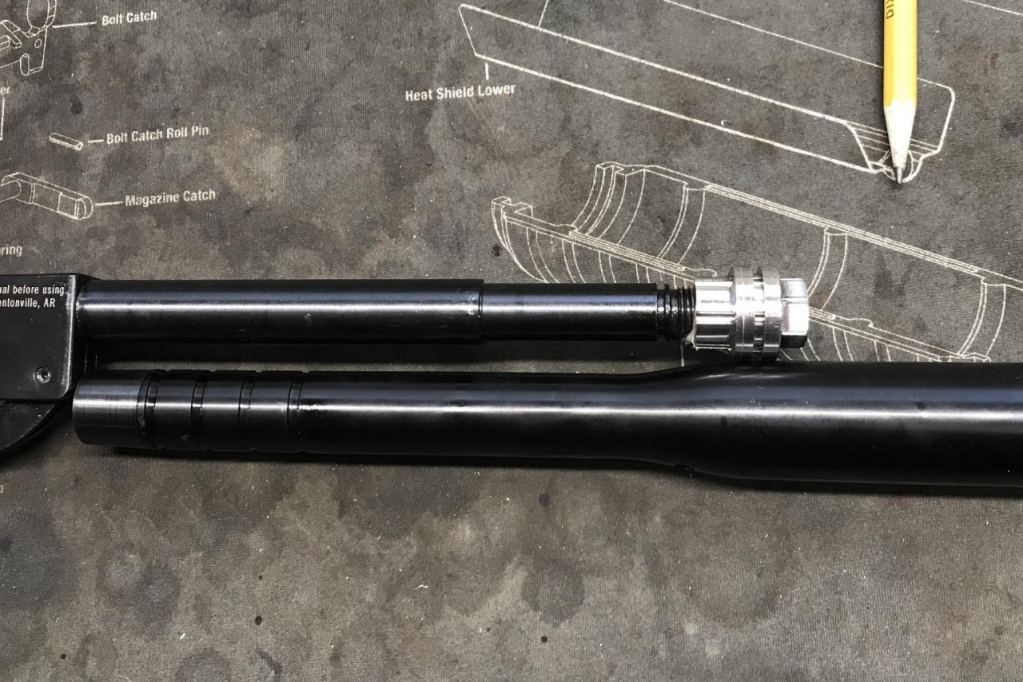

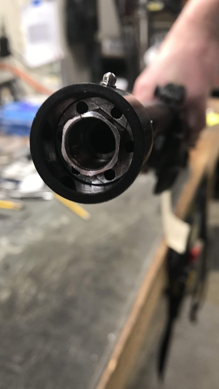

I'm working on a rifle now. It should be done in a few weeks. Modifying a Hatsan .30 caliber break barrel. When it is done it will be a smooth bore 8mm shotgun choked to 7.77 Here's some of the ammo. A paper casing. Holding 47.3 grains of 6 shot around 21 pellets. The casing weight is 1.7
I know it's a .30cal springer but I wouldn't expect much in the way of power converting it into a shotgun. Meybe 10-15ft of usable distance for a small bird or rat?

My concept is from the civil war. Buck and ball loads. But has been modified I also use it in my 28 ga Muzzleloader shotgun. The cartridge is a thin piece of tubing made to 7.874 there is a wad in the breach end. The case is cut in ten places around the top for crimping. They are filled with shot. Then they are crimped and a small drop of dopp wax keeps the crimp closed.
When the gun is fired it compresses the wad splitting the paper casing and opens the crimp. The barrel is slightly choked further opening the casing as it leaves the barrel

I will have something no one else has. I like building things. My total cost is $169. And the knowing how to ream and polish a barrel cartridges are free except a couple of my shotgun shells and a hour or so I could be wasting in front of the TV
