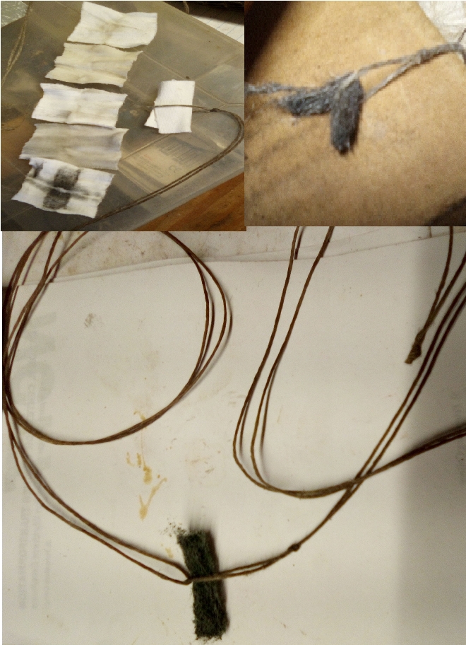

I've run a oiled steel wool "patch" through a few times to help smooth out bulky rifling job .. should not take but a handful of passes or so .. ( I guess a experience judgement call on it all in the end )
Well though I had a better picture but there's the wool patch and the back and forth pull string used on mean ones ..lol ( like a hatsan🥴)
Looking,... the back and forth puller string seems to hold a cut scotch Brite patch .😉

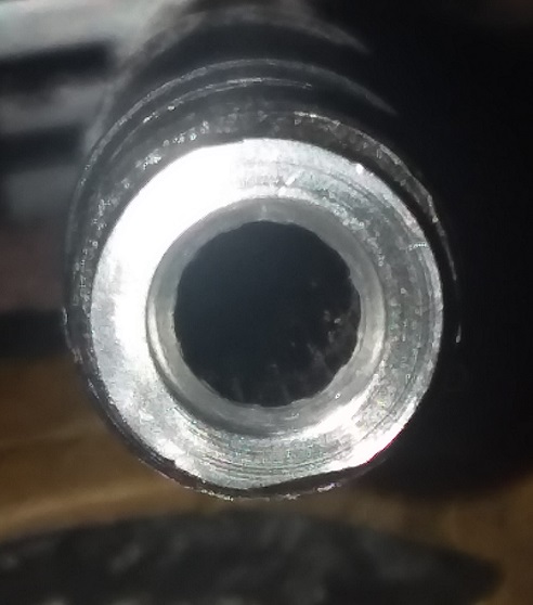

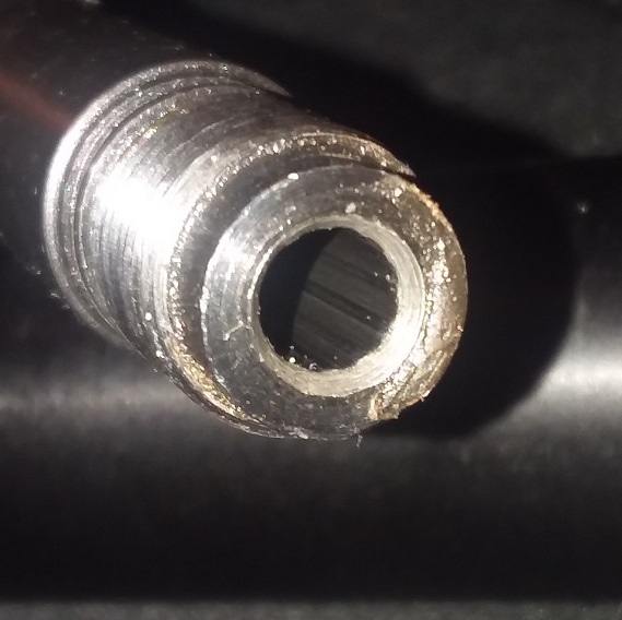

The crown mess Bear mentioned. From factory on the left, after on the right using the brass screw method. They don't do a very good job and fixing it helps. A good clean out with JB Bore paste and a brass brush for 20-25 passes doesn't hurt one bit either.
View attachment 450524View attachment 450525
