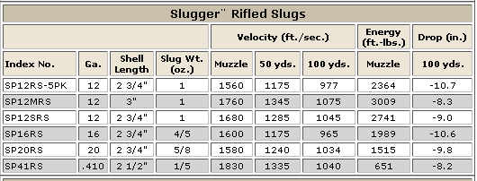

??? Is that physically possible? Explain.
It is way above my head to explain. Look at the table below comparing rifled slugs in a shotgun.
On the 12 gauge, the slugs all weigh the same 1 ounce.
Subtract the difference at muzzle and 100 yards for each speed.
At 100 yards the one that started at 1760 fps has slowed down faster than the one that started at 1560 fps.
Hope this helps explain what I was saying.
