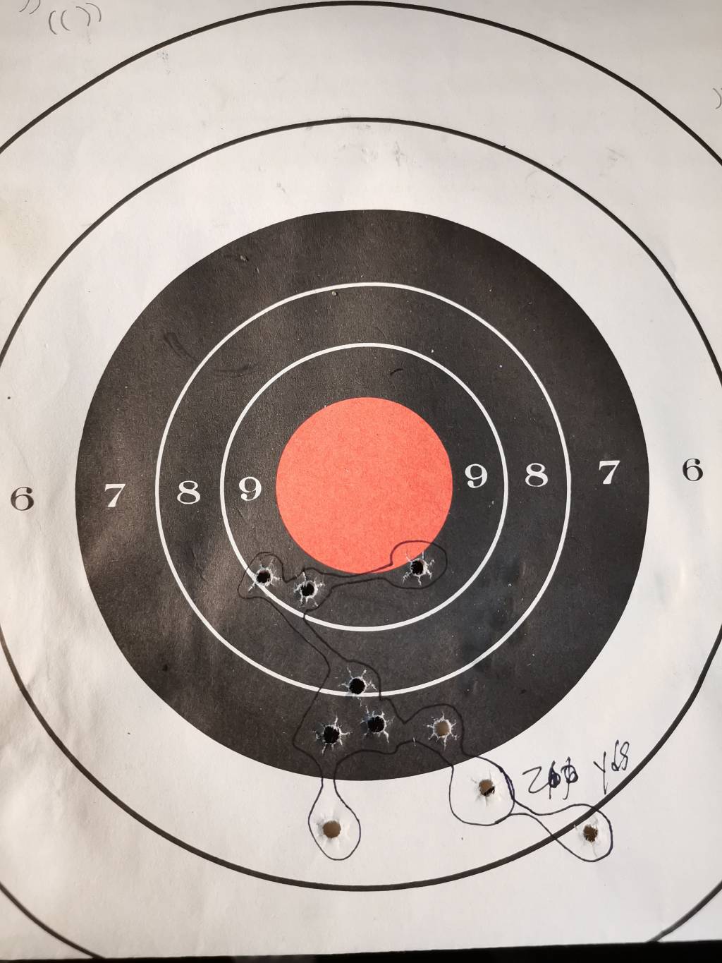

My Edgun R5 Super Long absolutely loves .30 Hybrids @ 930-935 fps. Here's a 200 yard group
