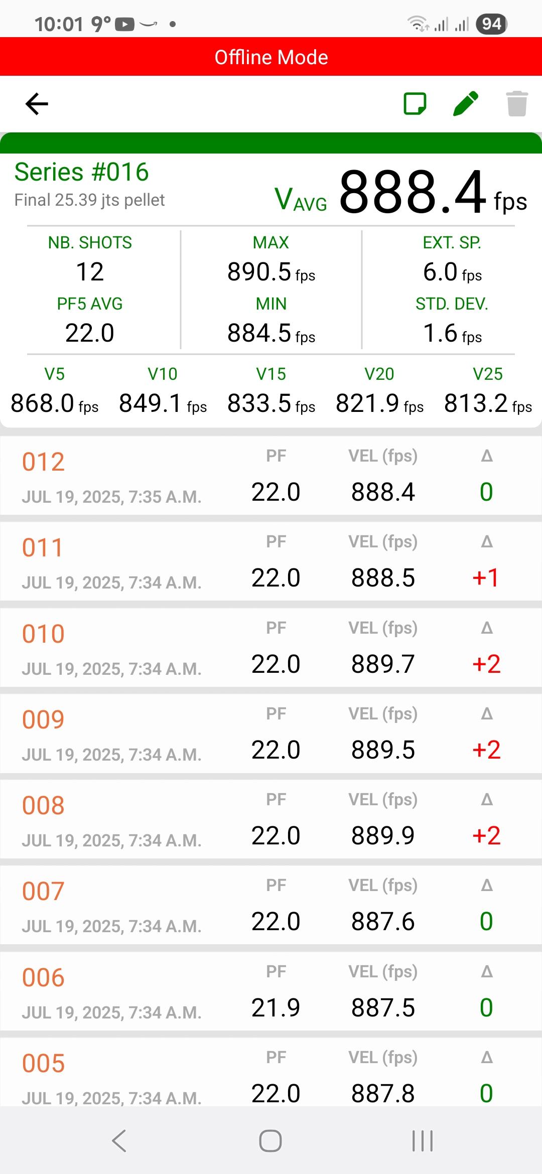

I just did a reseal to my X following the video above. It went without any issues except the O-rings I was replacing had failed by becoming hard and frozen in place. I suggest you go as far as you are comfortable to replace the original seals and then maybe shop for aftermarket O-rings from Internet vendors because the factory O-rings are not all that.
