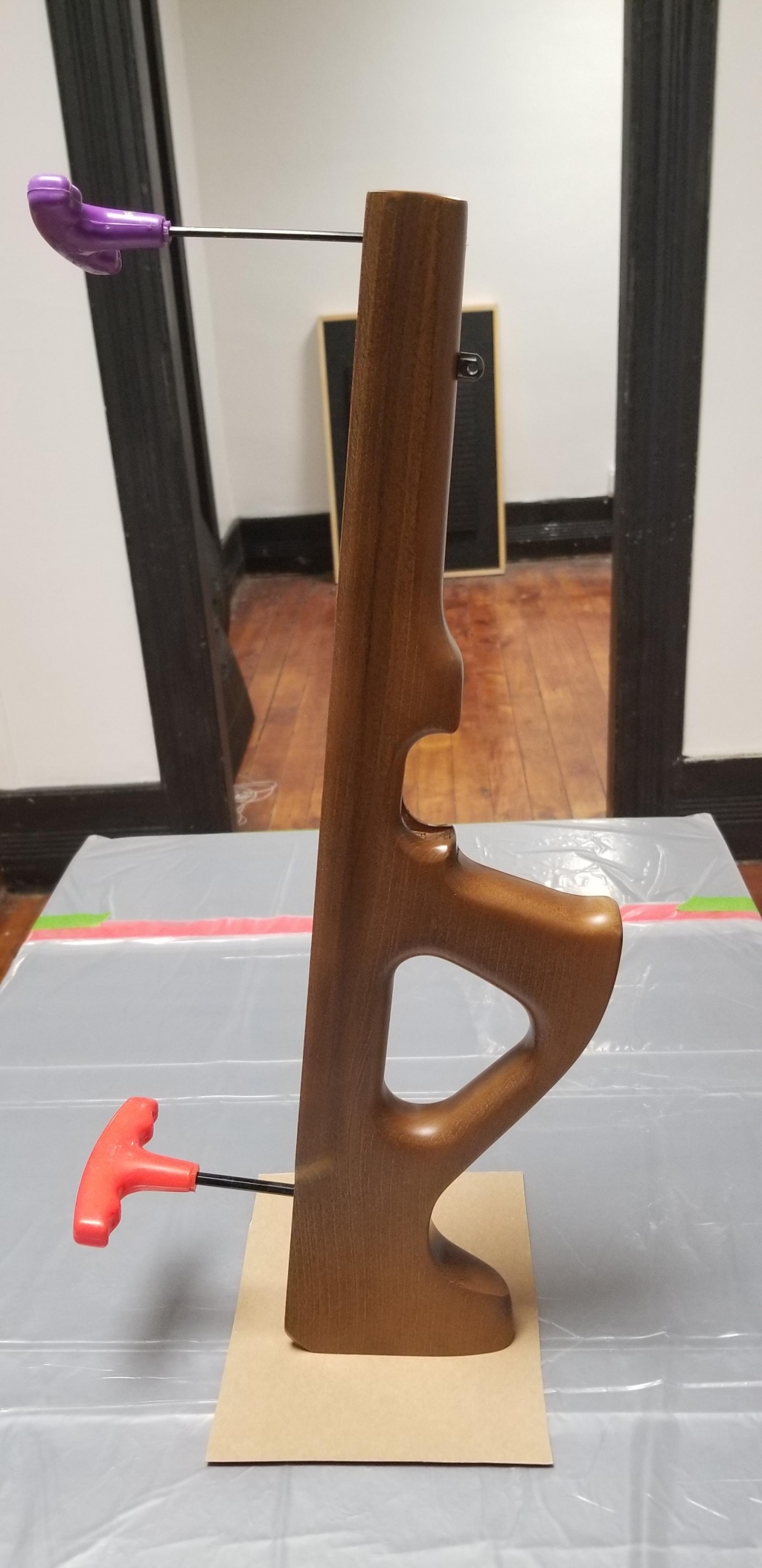

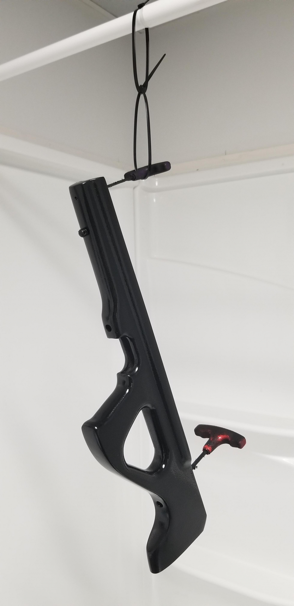

There's a few shots: Prep / Curing / Reassembled:
The final topcoat gave a nice added layer or protection to the OEM wood finish,
it enables me [or someone else] to **remove the finish - Which is a nice option,

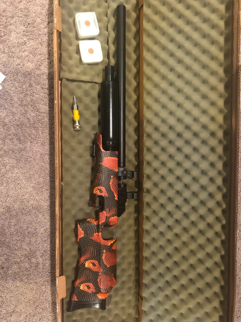

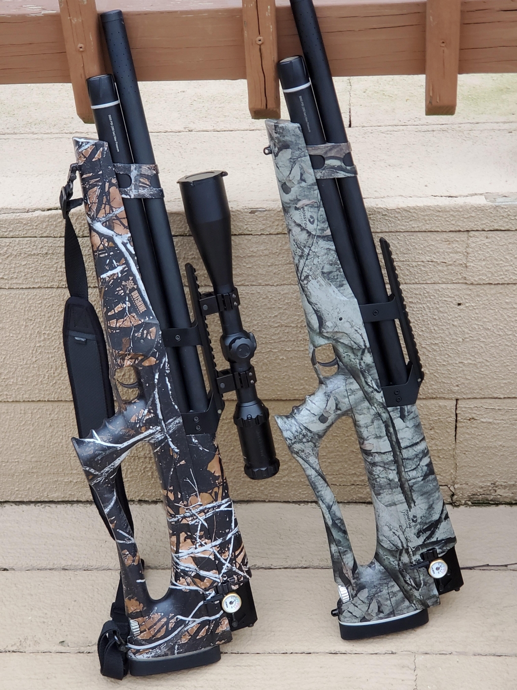

You've probably seen these before but here they are again. Note, these did not have the FX soft touch but were just hard synthetic. After hydro dipping the shop applies a soft touch coating. Gets you're camo and soft touch combined. They feel great in hand and so far its been pretty durable. Had 5 done so far and 4 there right now getting dipped this weekend. Plus maybe a couple more in a week or two..not all mine of course.
I would talk it over with your shop and see what they have to say.
