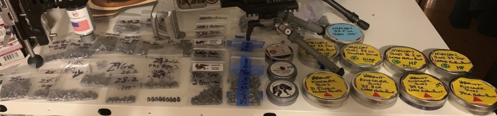

The .249" will shoot well but they need to be shot pretty fast. I think it has to do with getting the flat base to seal correctly. I've had great results with the 28.2gr. 29.0gr, 29.2gr. and 29.5gr. but shoot them faster than most will try... 940-980fps. is typically the best range.

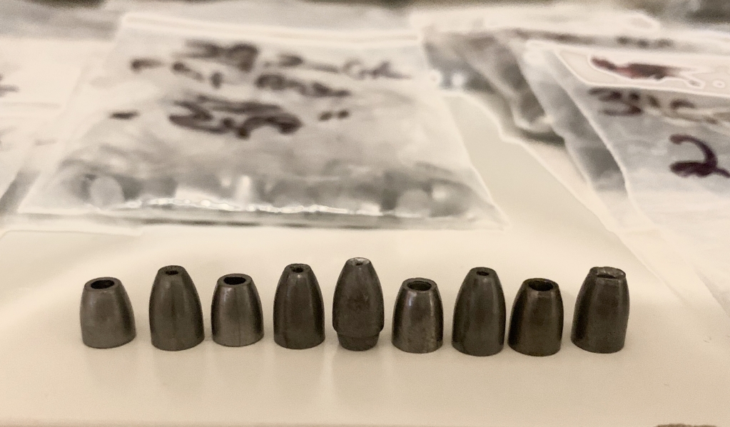

I've had good results with most of the .250 slugs too. When I was testing all the NSA slugs, I would shoot the .250 slugs and then size a bunch to both .249" and .2485" and test them back to back with the .250" version, surprisingly the accuracy didn't change a whole lot when shot at the same velocity, a little but not much It's pretty crazy stuff. I certainly don't have all the answers, I can only speak to the results of the testing I've done. The 32.8 and 34gr. Varmint Knockers I've been shooting are all .249" and they are crazy accurate. I also had some unbelievably great results with a .2485" Rat Sniper that's no longer made, There's definitely a lot more to it than just the diameter although everyone will tell you that's the main factor to a slug shooting well.

Nice! That's funny, remember I said how it's just crazy and there seems to be no rhyme or reason to things. I've had absolutely no luck with any dimple nose slugs and can't figure out why. The only one that I've had shoot great was the 31.3 Rat Sniper I mentioned above, that isn't made anymore. They were probably one of the best I've ever shot but it was when I first got my 600mm slug liner a long time ago. I tested them in my 700mm liner with the same great results and then ran out. Didn't even have to tune either gun, they just shot! They aren't made anymore, so it really doesn't matter! I think because it was very similar to the slug he's now making with FX, Similar, not the same! Wait a minute...Nick never made the 33.5gr in a dimple nose...just the 34gr I believe. Are you talking about the large hollow point or the small 2-S hollow point? Who knows. I attached a picture with some different shapes and hollow points. The 2-S is the one on the rebated boat tail slug and the others with a tiny hollow point. .
I have never even shot a slug below 850fps which is the velocity I usually start my testing. I would rather find a slug that I can shoot fast because the whole reason I'm shooting slugs is for the high BC and retained energy. I never said velocity was everything, I said it's pretty important with the NSA .249" I think they need to be pushed fast to get the flat base to seal. I like they flat base and dish base the best, not much luck with the deep recessed base. They might shoot great if they were seated deeper but I think the deep recess keeps the bolt probe from loading them deep enough. Just a theory but it's because they should seal the best with the thin edged skirt and be super accurate and they are not! .
After all the slugs I've tested, I settled on the VK 32.8 and 34gr. They both shoot very similarly and the 34gr has almost the exact same point of impact as the 33.95JSB at 50yds which is pretty handy. With that said, Nick at NSA has been very generous and super to work with, the same goes for Dale at Varmint Knocker. Both are super great guys!
