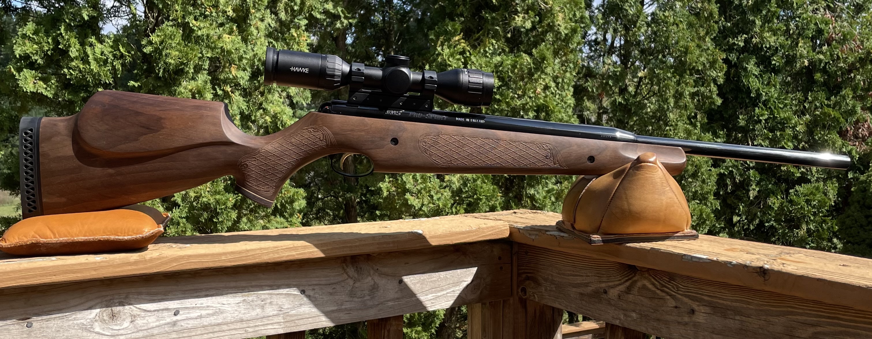

I have the TbT kit in my Pro Sport. Totally changed the characteristics of the rifle. Going from a rude 16 fpe to a mild mannered 11.5 fpe was worth the kit. PA only sells Pro Sports in FAC configuration so the TbT kit seemed the best option for the rifle. The cock and shot cycle is much better and way less violent now and accuracy improved. YMMV
