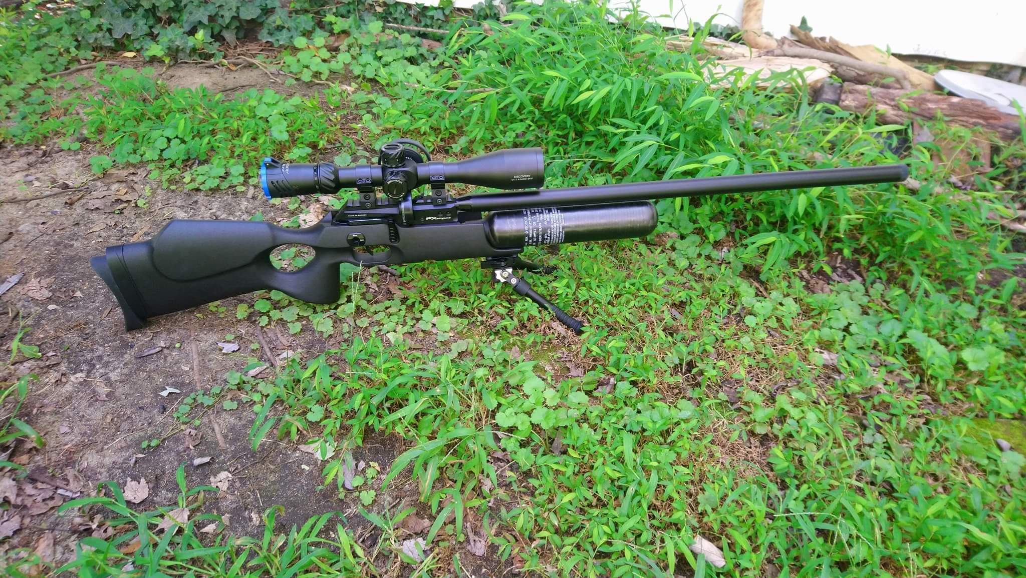

FX Crown mk1 continuum, 700mm slug A liner, .22, Griffin 36gr .218 boat tail slugs. @65fpe @150bar with 7gr added hammer weight and substantial port work to the barrel. Would do 1/2 moa no problem. But make no mistake, it took TONS of testing and tuning. I since converted that barrel to a 500mm superior with carbon reinforced liner, and it is VASTLY less tune and ammo sensative. I never tested the 500mm at 100, so no clue what it will do. I almost never shoot that far. And even more, I almost never use slugs, or even the 500mm barrel. Favoring pellets @33fpe from 380mm pellet A barrel.
Gun preferred no moderator combo I could come up including very short ones. Favoring no moderator at all. Probably 5yrs back now.
Gun is almost permanently in this config now.

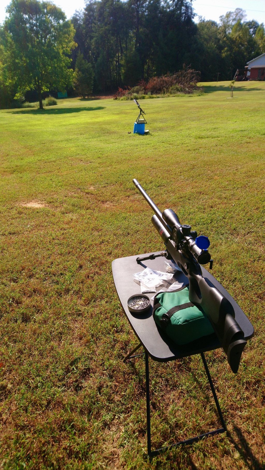

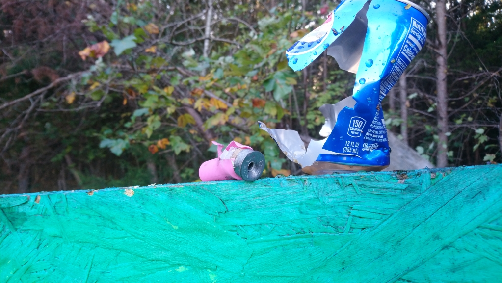

Never photographed groups because they were just absurd. And frankly unbelievable. I rarely shoot groups anyhow, and I have possibly never posted any here at all. But here is a shotgun primer I punched out @100. 🤷‍♂️
Also my rickety shooting setup that day. Was using the bag heavily, and pressing the gun down to keep it stable for accurate shots.

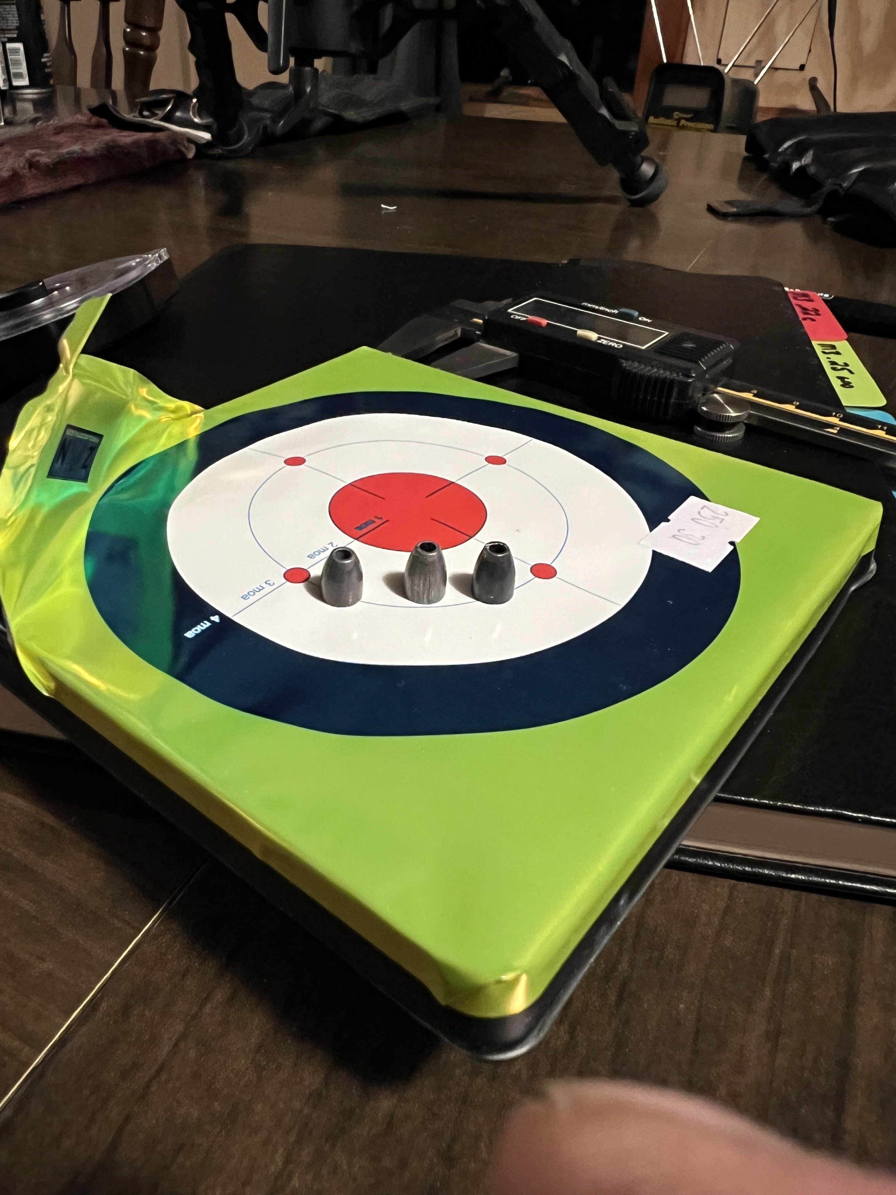

There are so many things that go unseen that can get a guy all screwed up. I’ll lay one on you guys that I’ve been dealing with for the last two days. It’s educational and might help guys understand what we’re up against if you are after the utmost accuracy. I built a barrel for another one of my M3’s. Have a topic about it. Gun wound up becoming most guys dream gun. I decided I just couldn’t leave well enough alone and put an L-tech on it. I have them on my other slug M3’s and like some of the features. I knew there was going to be new tuning parameters but I already installed two so I felt confident.
After a good bit of testing and adjusting, I found magic. Only shot out two 114 yards but was quite thrilled. The gun was as good or better than it was pre L-tech. Later that night I decided to shoot some more and that’s when the train went off the tracks. Velocities jumping all over and groups sucked. I tore the gun down four times playing with seating depth because the jumpy velocity is a symptom. About an hour ago I was at the point of deciding just to start smacking the back of the slugs with stupid high reg pressure to see if something would change. I turned the reg up and the hammer spring, then started loading a mag. I noticed something I couldn’t believe. Zan has two different 30gr slugs. The original that my gun shoots 943fps and all groups are under 1.5” at 100 are 7.54mm long. These other Zan slugs are 8.11mm long. Their speed is all over the place because they are too long for my leade. And they shoot like sh#t.
So because Zan changed a little something that they might consider better, my pride and joy now shoots like a turd. If this is their new slug, I have to recut my leade. Moral of this story? Mufasa, sometimes you can do everything right. But outside forces are working against you. I was chasing one thing that I perceived as the problem, the new L-tech, but it was another problem that just should not happen. Here’s a pic of what I saw when I realized there was a problem.
Ok, it just got even more interesting. Opened one of the latest packs of Zans that I received. Now we have new packaging and a third length. These are 7.94mm long. So my question to all the stellar slug shooters out there is, how serious or knowledgeable is a company like Zan if they think they can do this and customers can enjoy exceptionally consistent accuracy. I promise you that you can’t when you are not feeding your gun the exact same thing every shot. All of these Zans were bought within the last month. Three different freakin lengths in the same weight. And guys wonder why MOA is elusive.

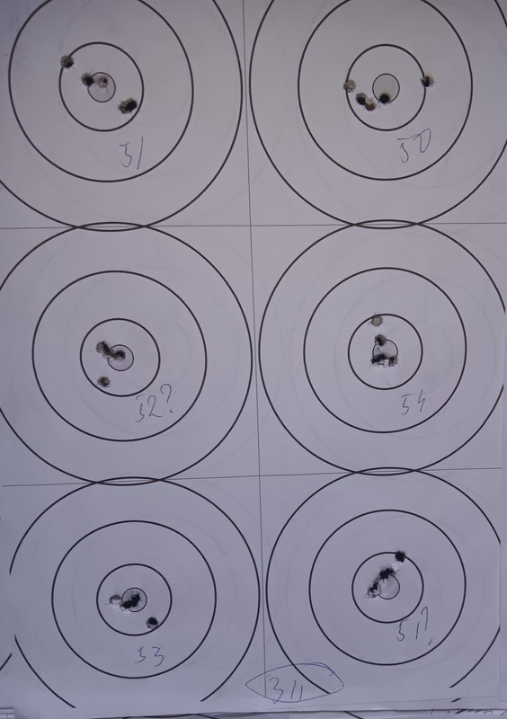

This is what i did on the last training before the 100m/110yard match from last sunday with the panthera. My Panthera is really accurate. I won the match. It is easy moa and better.
Grtz .Bert

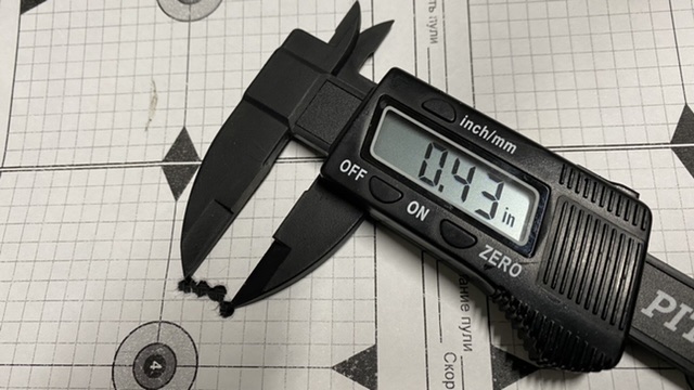

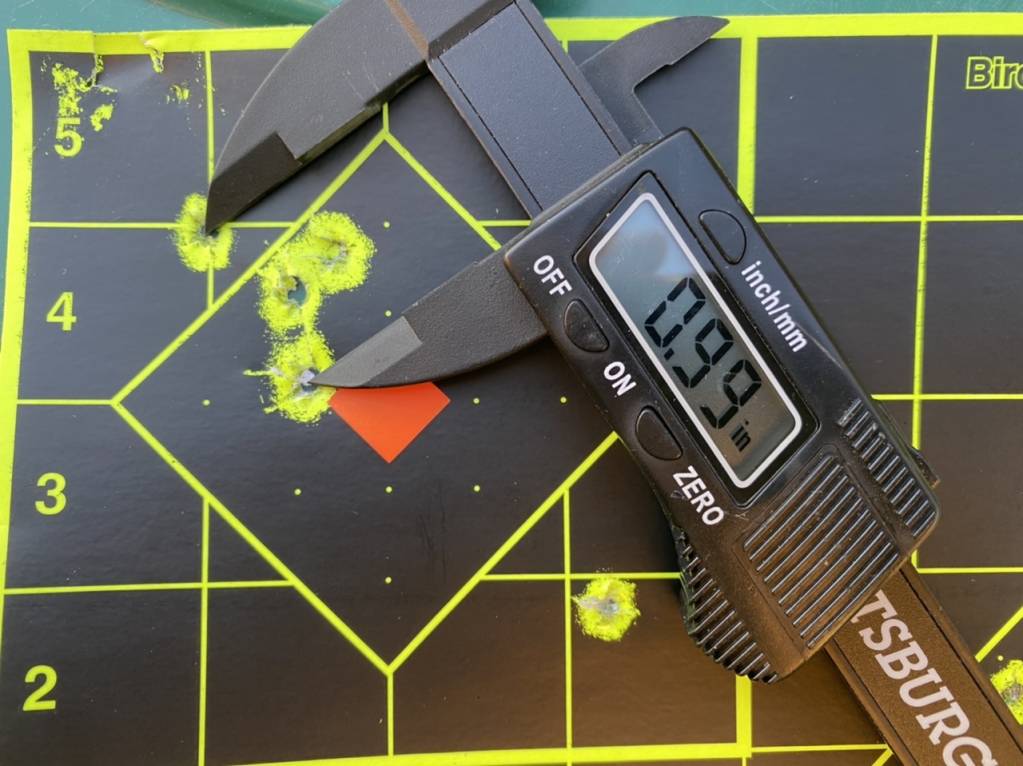

Very nice shooting there! Here is my cherry picked group because think this was my best 100 yard group.
In case anyone ask, it was NOT dead calm! had to hold between 1-2 mils of windage and every shot was a different hold. Definitely difficult but absolutely satisfying! That should qualify as sub half MOA.
