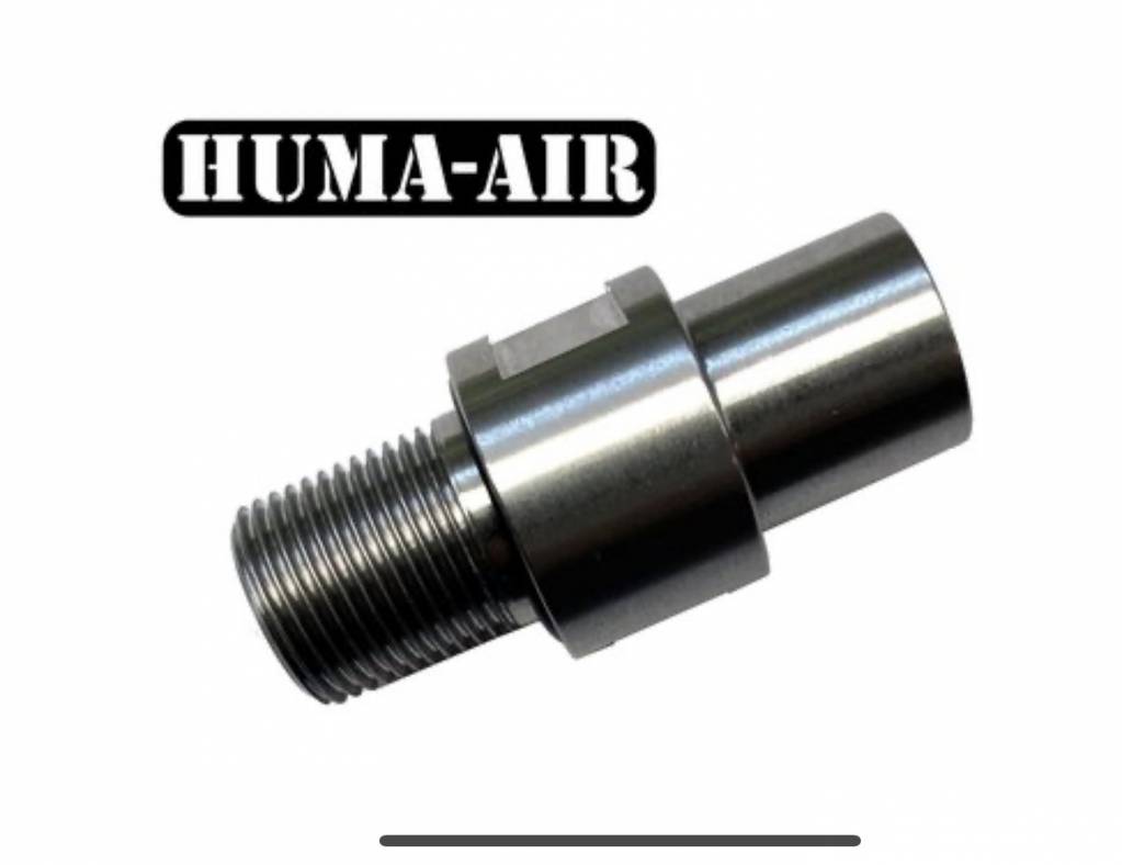

Yes I have fitted a couple now, very consistent and gained a bit more powe but be sure you order the correct one as there are two thread sizes, one for the older X blocks and one for newer X HP blocks.

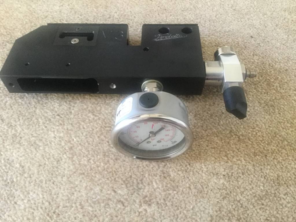

Also, as far as I know there are no current reg testers that accommodate the newer thread so you need to set the reg with a gauge on the block.

Yes they say the measurements of the threads outside or major of the thread 16.6 16.7 which is the hm1000 reg they got labeled and 19 mm hm1000x I just ordered one for my hm1000x my major of my threads were 16.5 but my hm1000x is older so I ordered the hm1000 reg from huma my s/n starts with hm also and the newer hm1000x s/n starts I guess with hmx so I hope I got the right one coming
