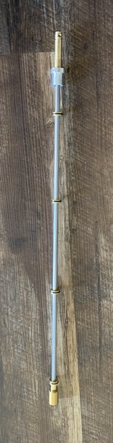

I use these brass weights that I slide around. They are inside the shroud. Works like a charm!

@jmoss80917 if all else fails the local hardware store usually has a section in it with brass bushings and the like. You can probably get one real close to the size you need. Then, with a hack saw, file, and power hand drill, you can make the weights you want fairly quickly by drilling the inside of the bushing to the barrel diameter so it is a fairly tight friction fit, cutting them to the length you desire, filing down the outside diameter, and even make an o-ring groove if necessary. Also, order a small bottle of Vibra-TITE 213 VC-3 Threadmate to position the weights here you want them to stay once you've completed harmonics tuning testing.
