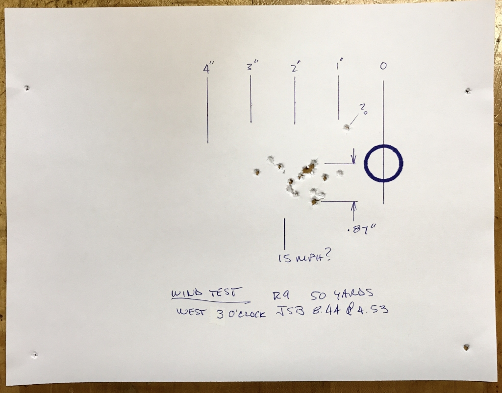

Just looking for info from others on their experience reading wind. I have the most trouble when its coming straight at me. Hopefully we can benefit from others tips to improve our shooting in windy conditions.
