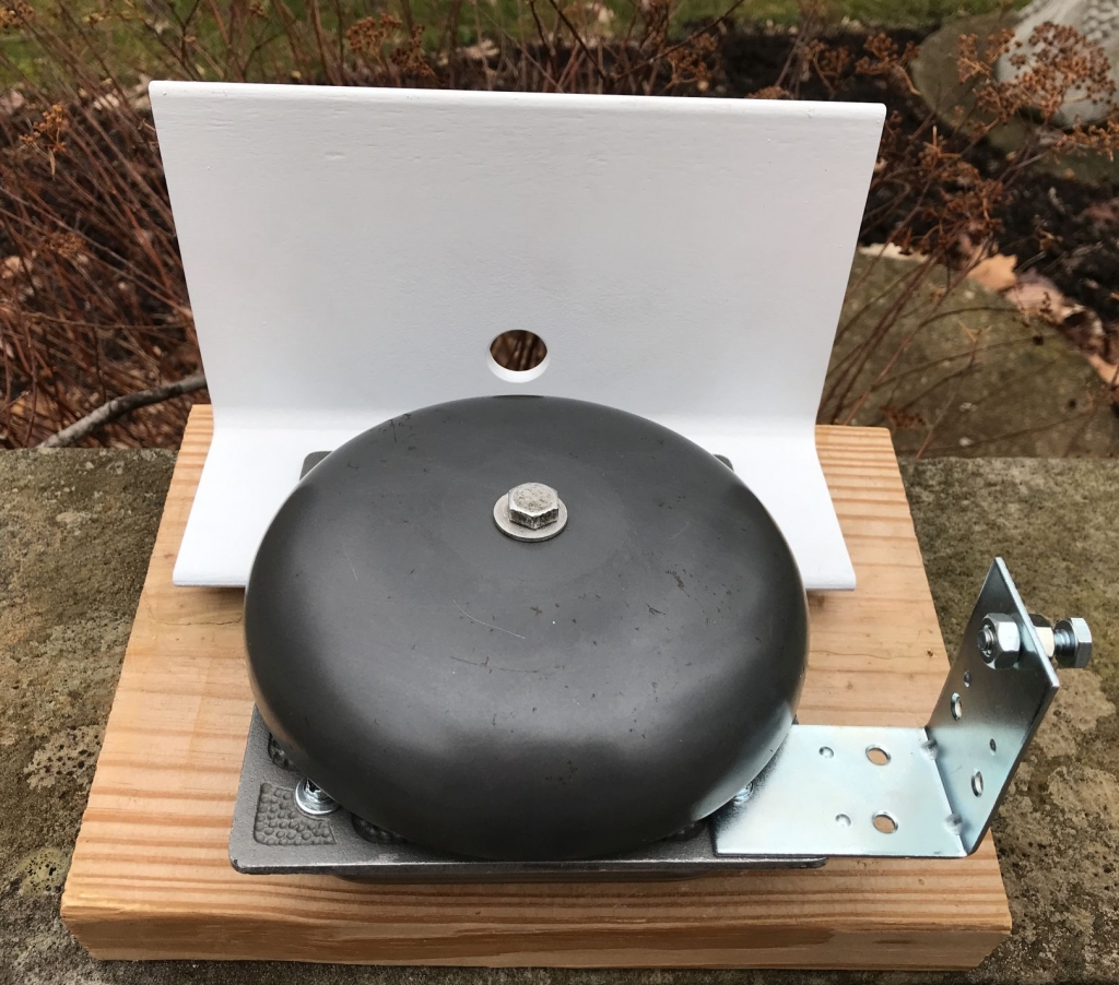

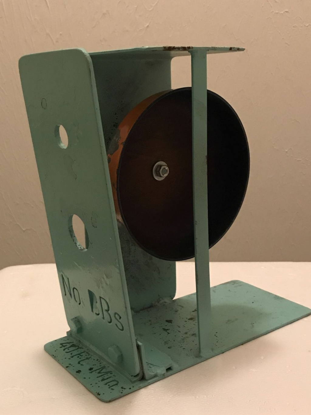

Sure... the green bell target with the two different size holes was designed and sold by Frank Bobbio several years ago... but he stopped selling them because of liability issues, probably because idiots still shot at it with a BB gun.
The white faced one was the one that I came up with... I don't have a welder or torch to cut thick metal, so I found the angle-iron online that could be custom cut to size.
Both steel bells on both targets are almost 6 inches in diameter at the bottom.

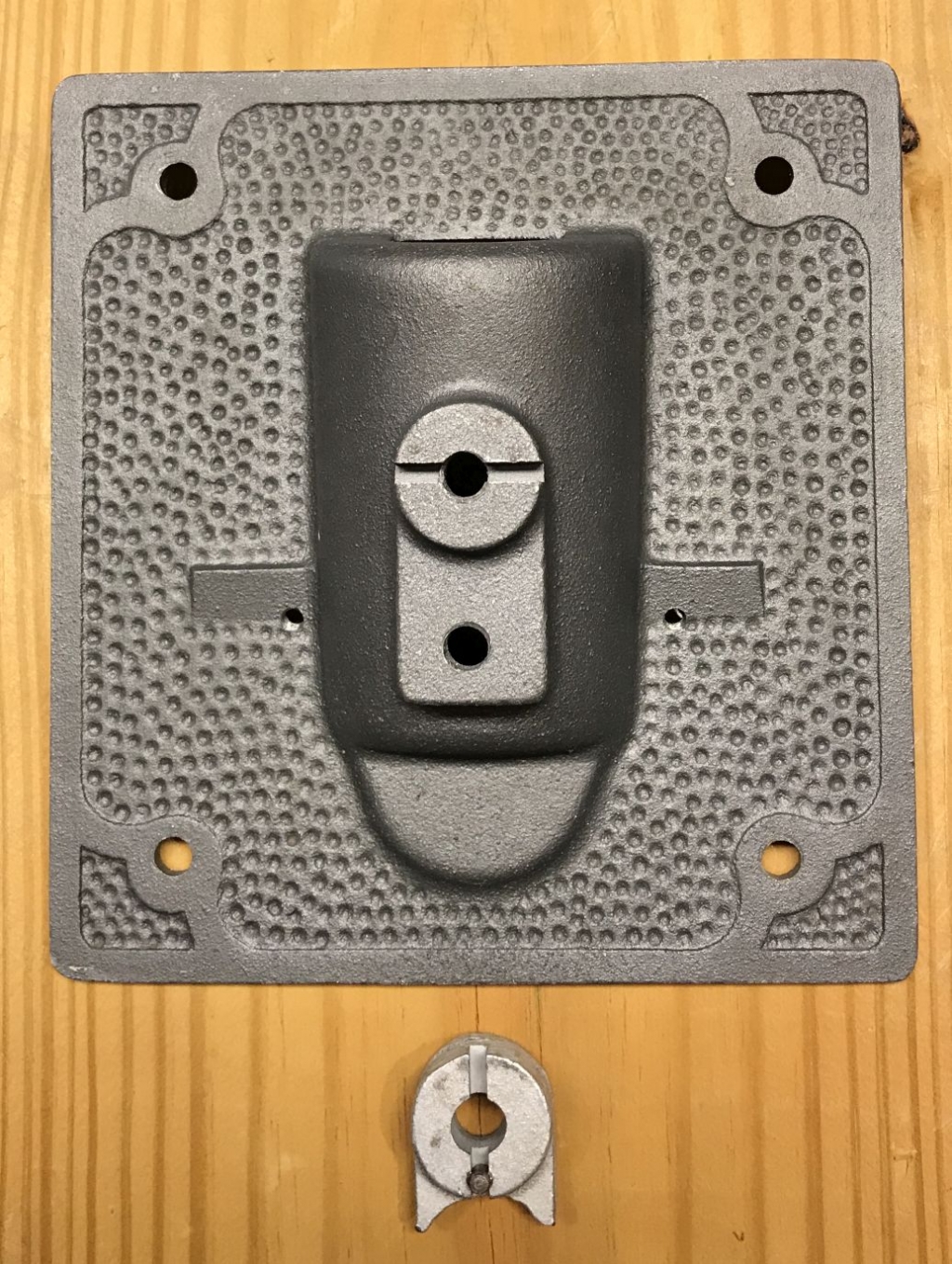

The IBM school bell came with the mounting plate and electric ringing mechanism... actually bought two of them at an antique shop for $6.
I removed the electric ringer, and used the mounting plate that already had the holes for mounting the hardware that I used.

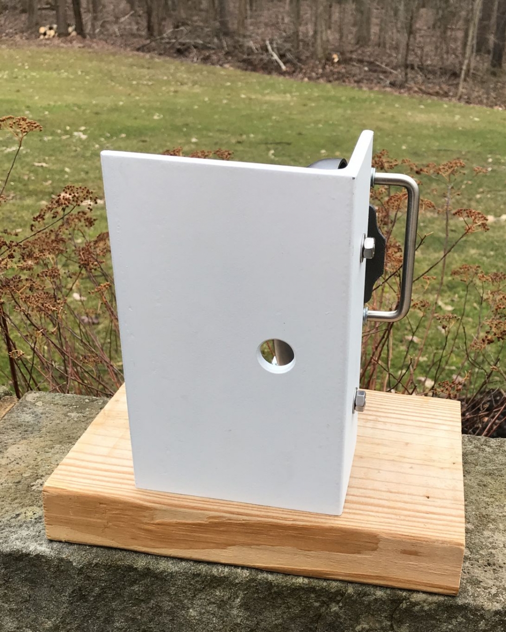

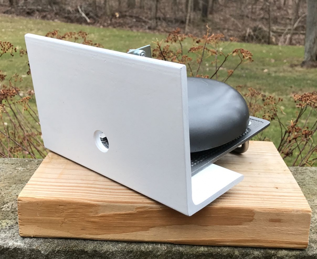

I used 1/4" x 3" x 5" steel angle iron cut to 8 inches from Speedy Metals.
My main concern was have the angle iron high enough and the bell mounted low enough so that the bell was completely hidden from view, so the top of the bell could not be it by a pellet.

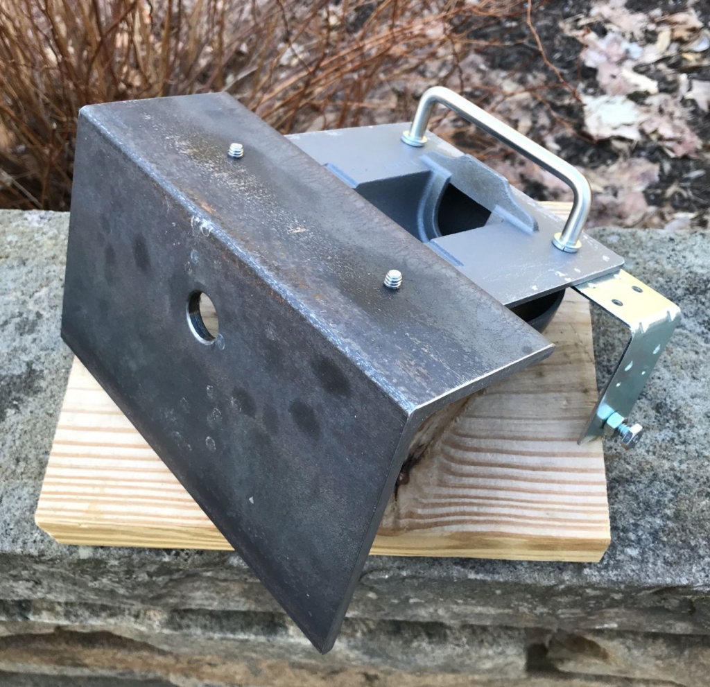

My target can be used horizontally (flat) or vertically... I mounted a door pull on the underside of the rear mounting plate to angle the face plate downward a little to try and angle pellet splatter downward when the target is horizontal (flat)... I used a metal corner brace to use the target in a vertical position, with an adjustable bolt... hardware & paint all purchased from my local Home Depot.
Fortunately, I do have an upright drill press that I used to drill the hole in the face plate... biggest drill bit that I could find locally was 3/4" so that is what I used, although I did manage to find a 1" and 1 1/4" on ebay, so I may make the hole bigger at some point... good metal drill bits are kind of pricey !
An adjustable hole would be nice, but I tried keeping it simple... I did buy a couple of 4 inch steel bells on ebay to use with some 3.5" x 3.5" angle iron that I purchased first, but the height was too short to obscure the view of the 6 inch bell... I'll probably drill bigger holes in them when I get around to making them.
If you make a bell target, I would love to see photos of it.
