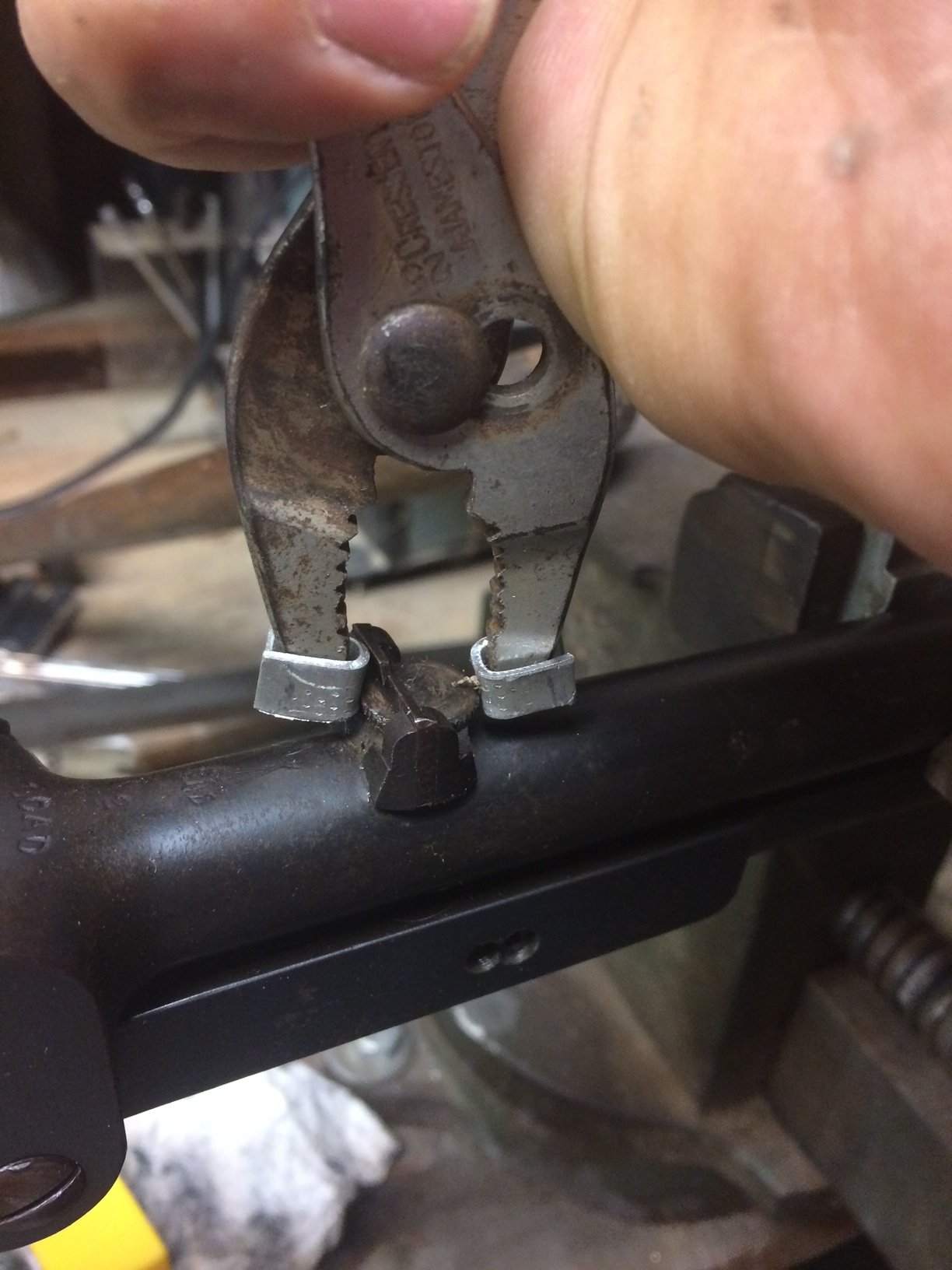

I made up these aluminum pliers soft jaws to get this turret sight adjusting screw moving on an old BSA prewar. Gripped the straight knurls nicely with out marring. Saved them and have used them a few times since. I probably got those old pliers for nothing. This old boy will scrounge hand tools any where! Anytime! You never know what tool will get the job done until you use it.

Not bad .. comming up with soft jaw ideas is a must on some things.. copper tubing works making them as well , gluing on rubber or leather pads ,ect 👍

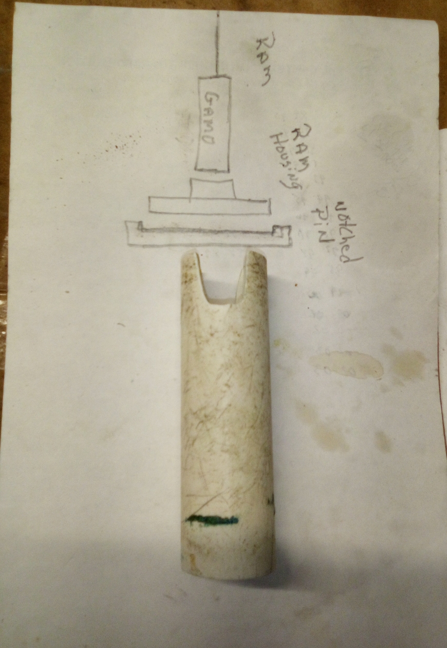

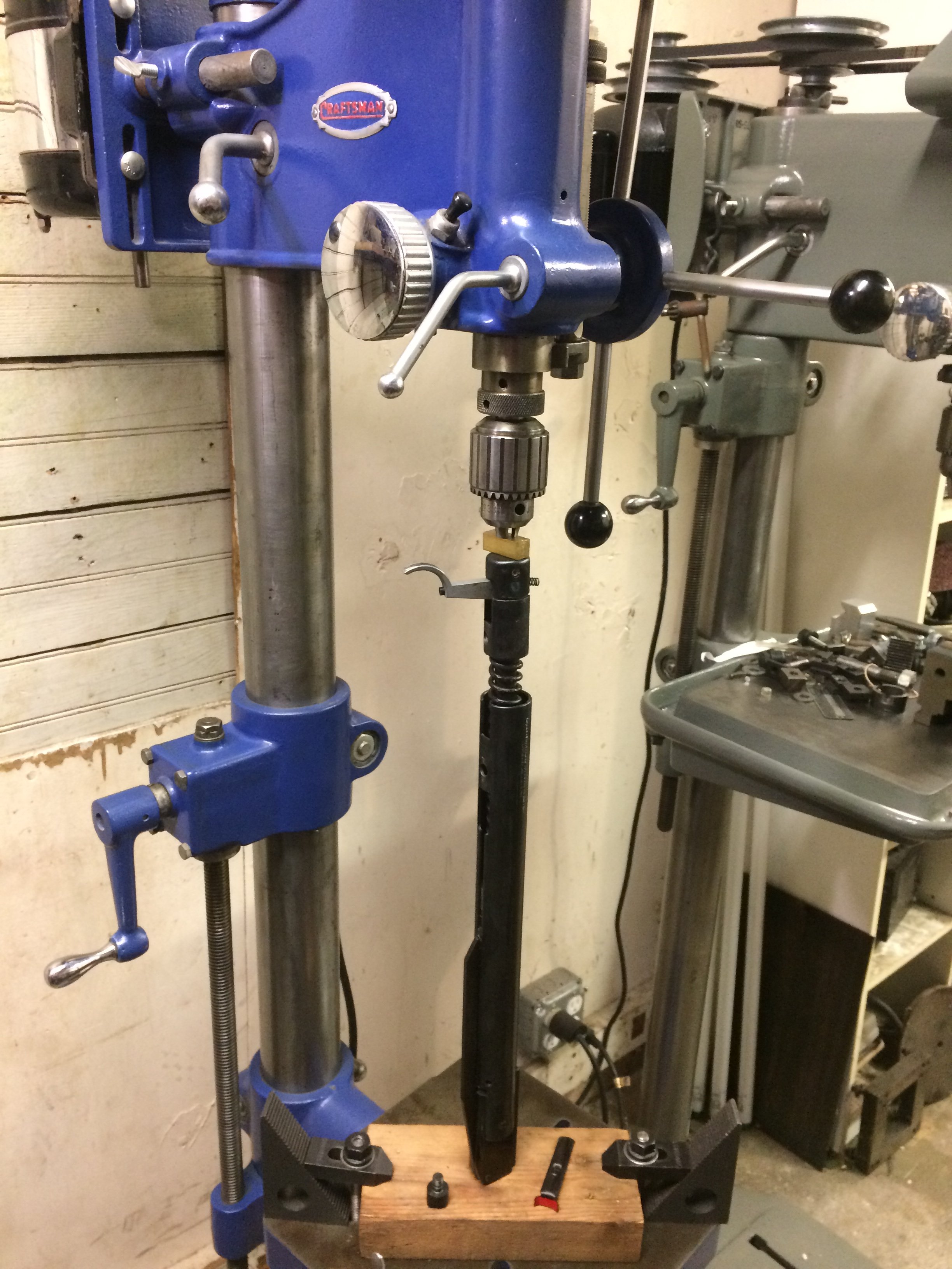

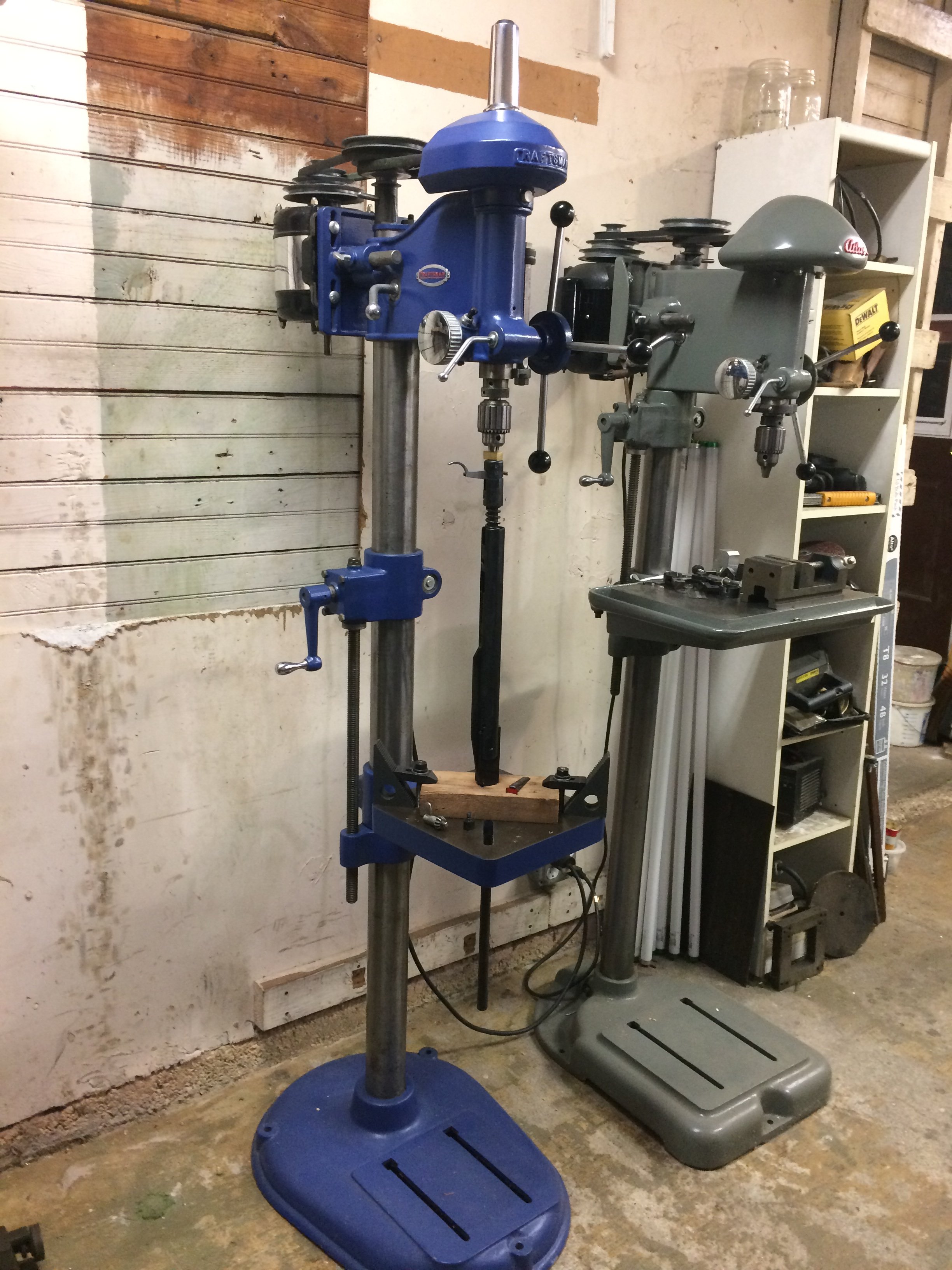

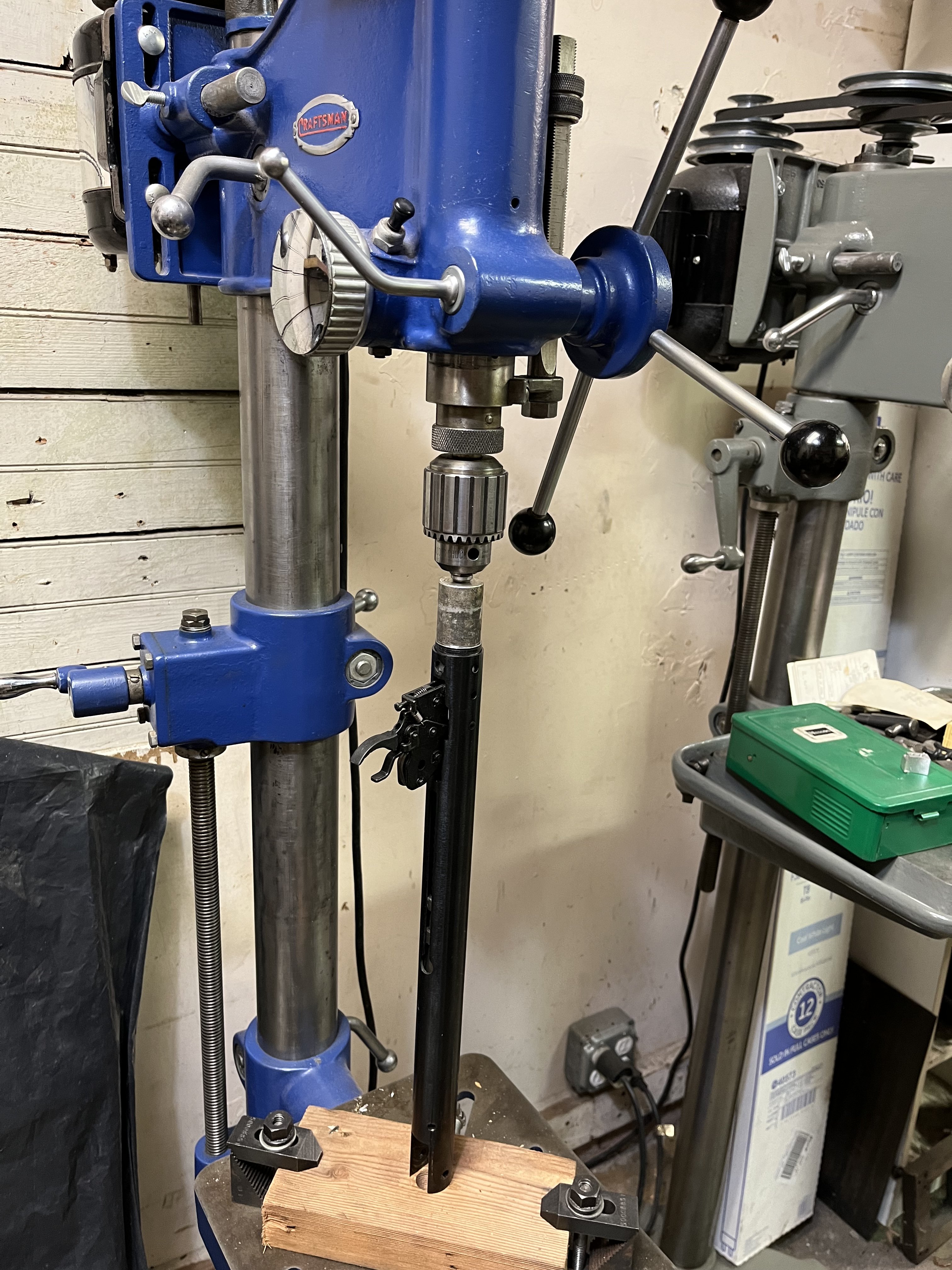

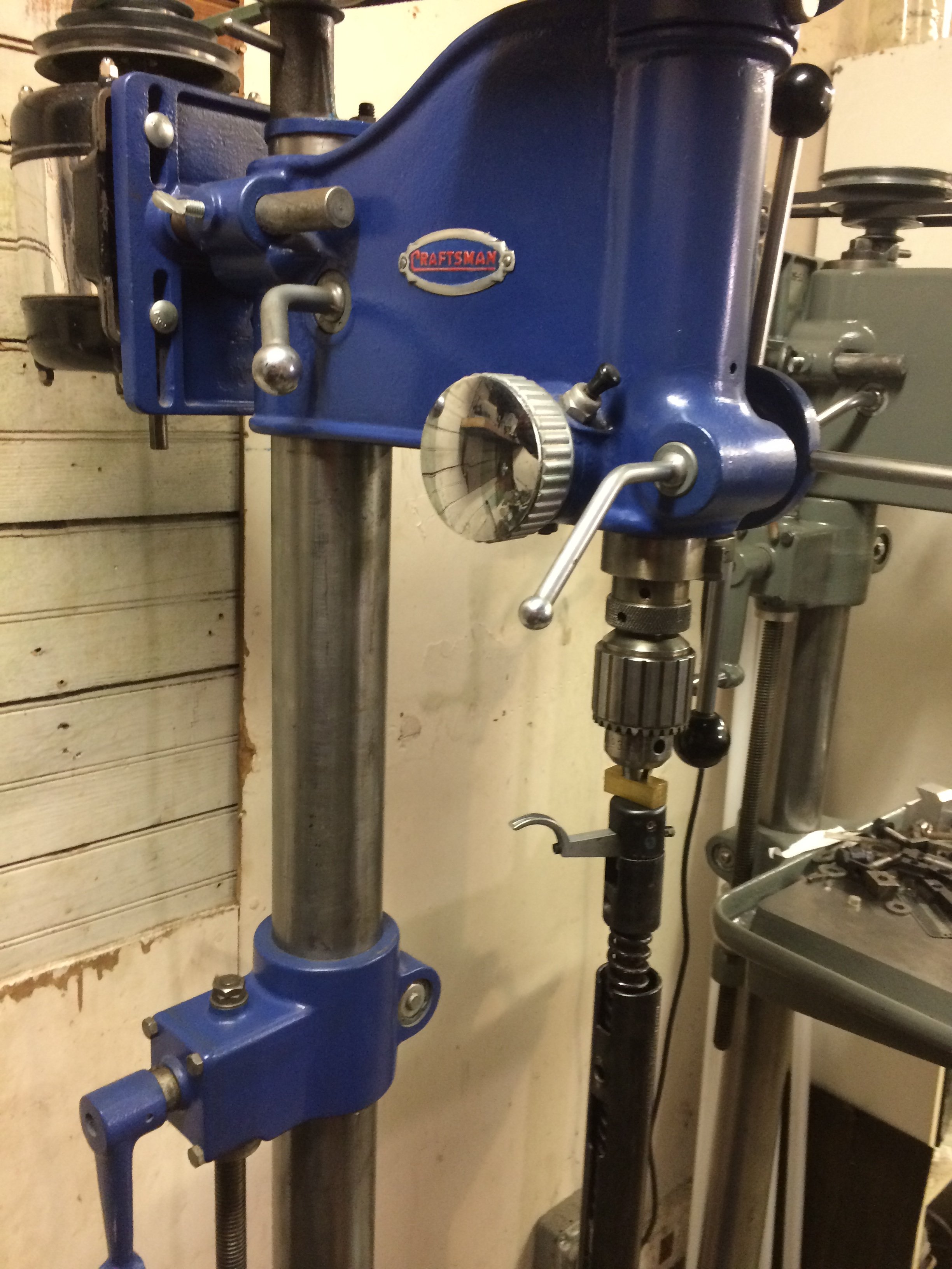

This is my spring compressor. I can make up any adapter I need in a few minutes out of scraps or new stock. I like to have the cylinder vertical.

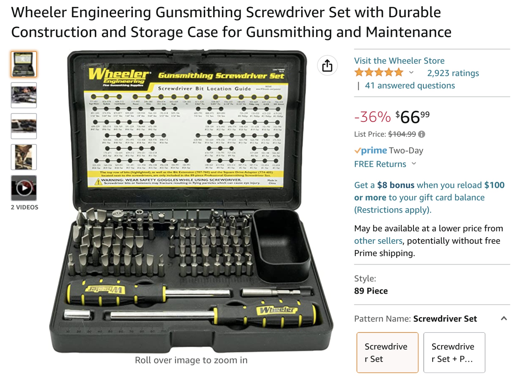

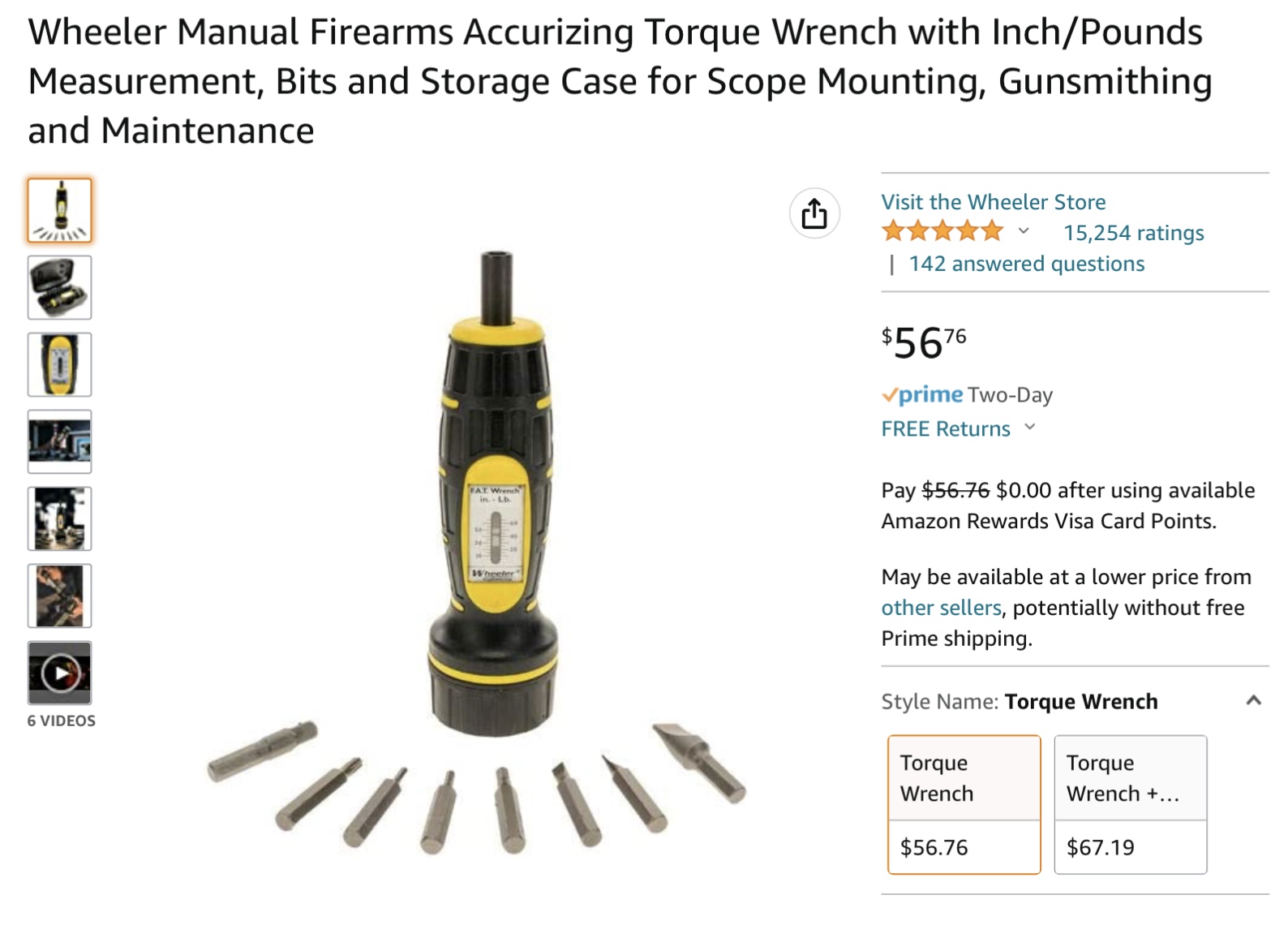

Here are two very handy tools for that I use daily for my gunsmith needs. Keeps the screw from getting buggered up and the correct torque on all bolts and screws.

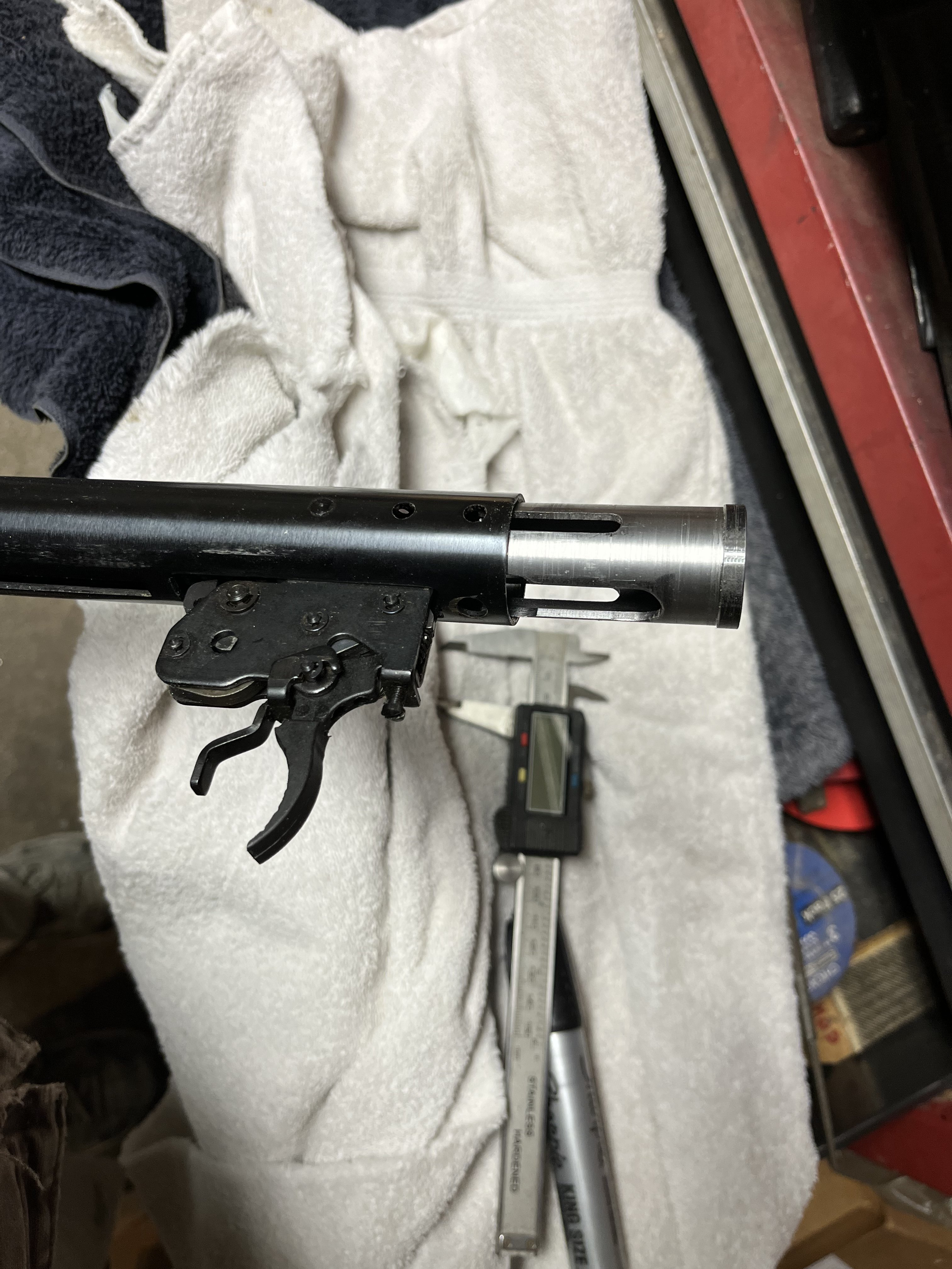

I built a spring press but not crazy about it. It does the job with the barrel on or off. Because sometimes I don’t need to remove the piston just check/change the spring.

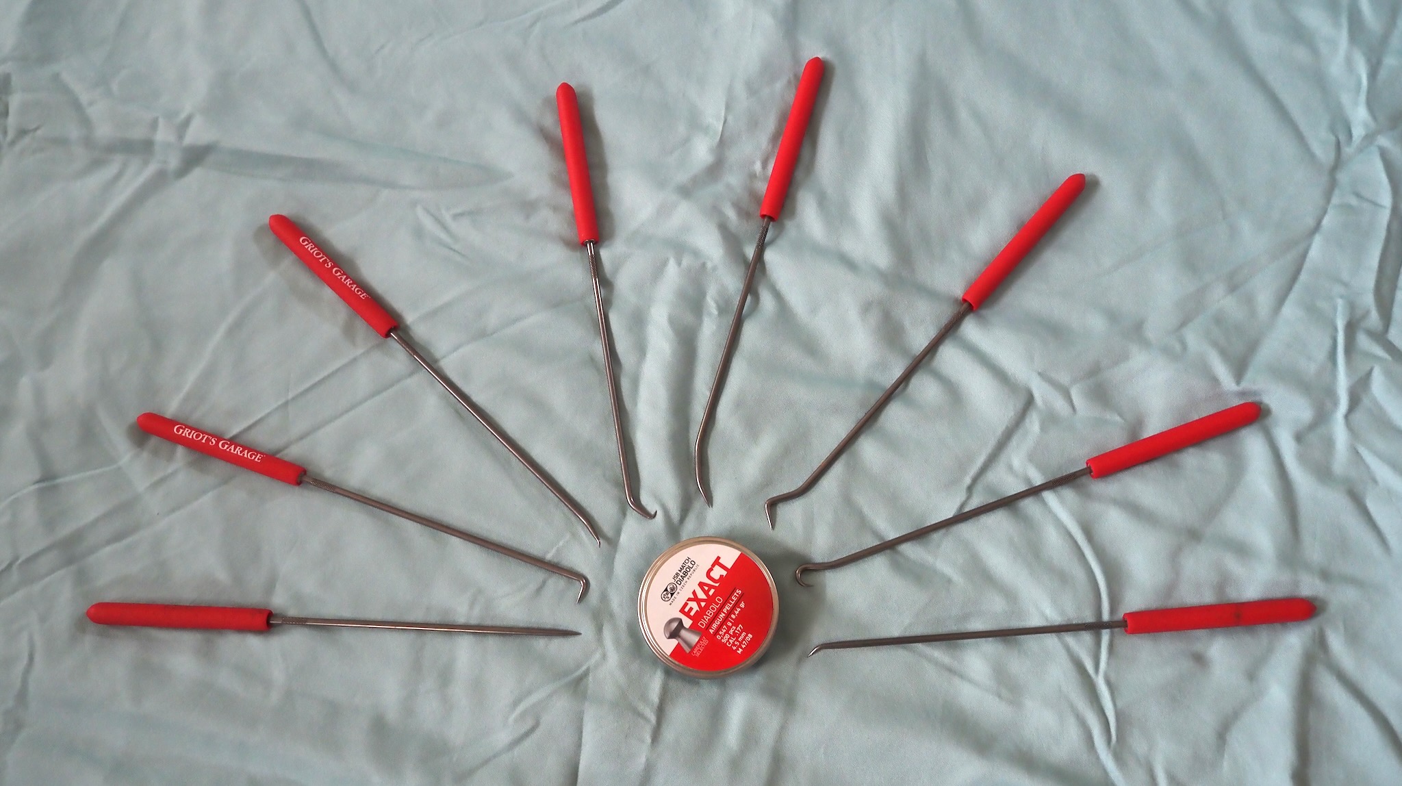

A set of strong probes has proved so useful in the shop for many types of project. I used a hooked one to reinstall a tiny spring in a Rekord trigger recently. I've tried to give some sense of scale, these are about 9 inches overall.

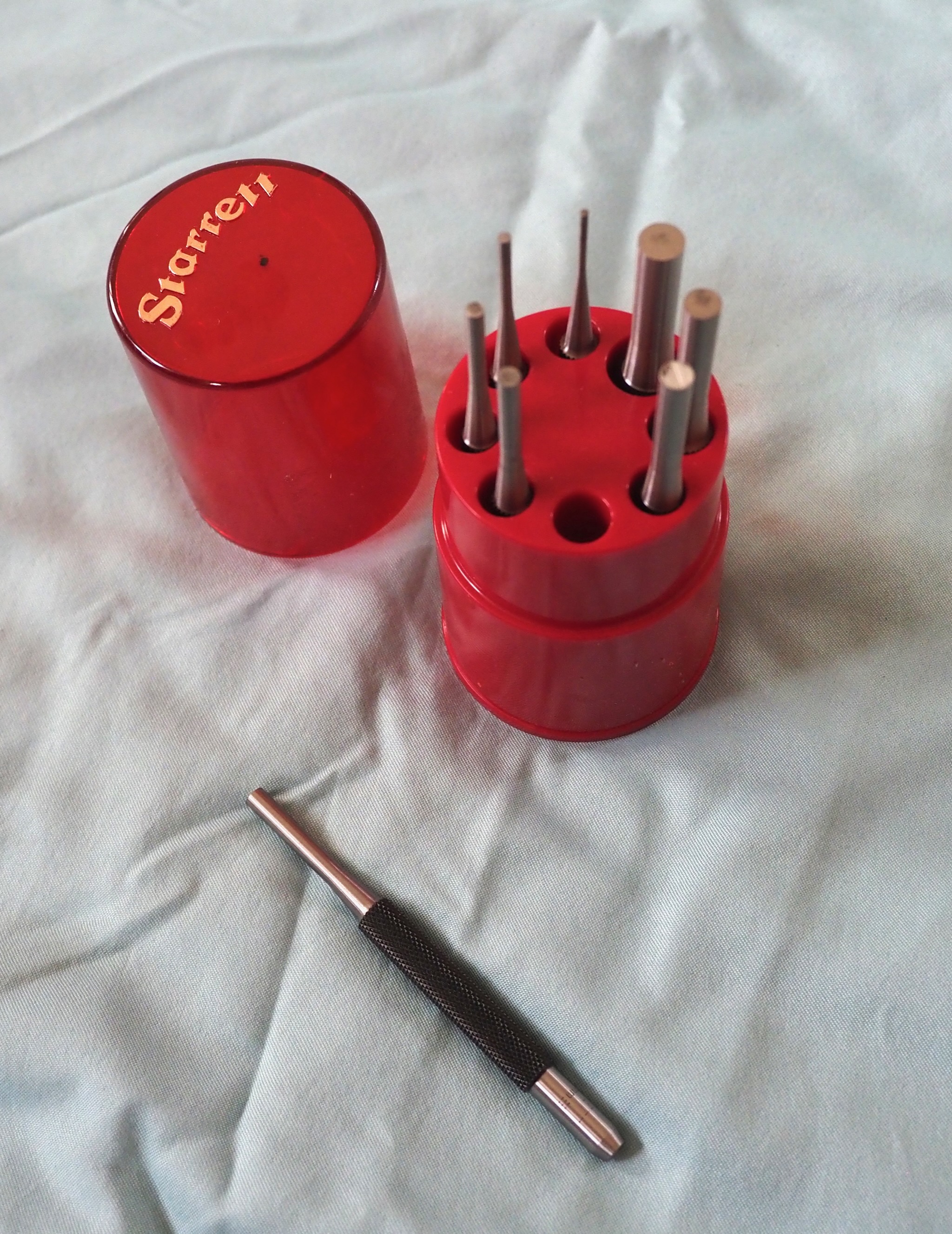

A set of pin punches is pretty much indispensable to me when working on airguns. These I got recently and I like them pretty well so far. I also use a set of pin punches made for rolled pins on occasion too.

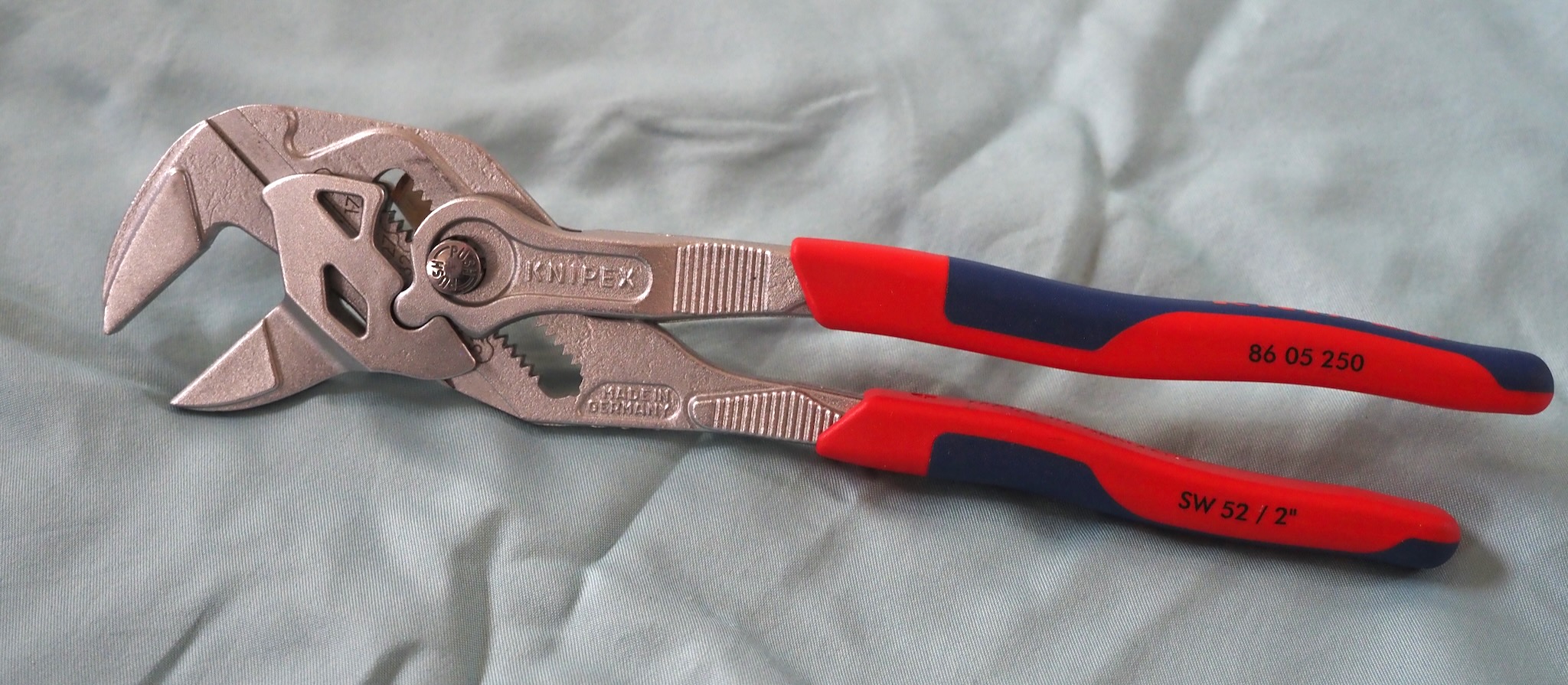

This last one has nothing to do with airguns (sorry) but it usually causes quite a stir when anyone sees it in my tool box. Think of a cross of a channel locks and a Crescent wrench. Knipex tools of all sorts are great.
